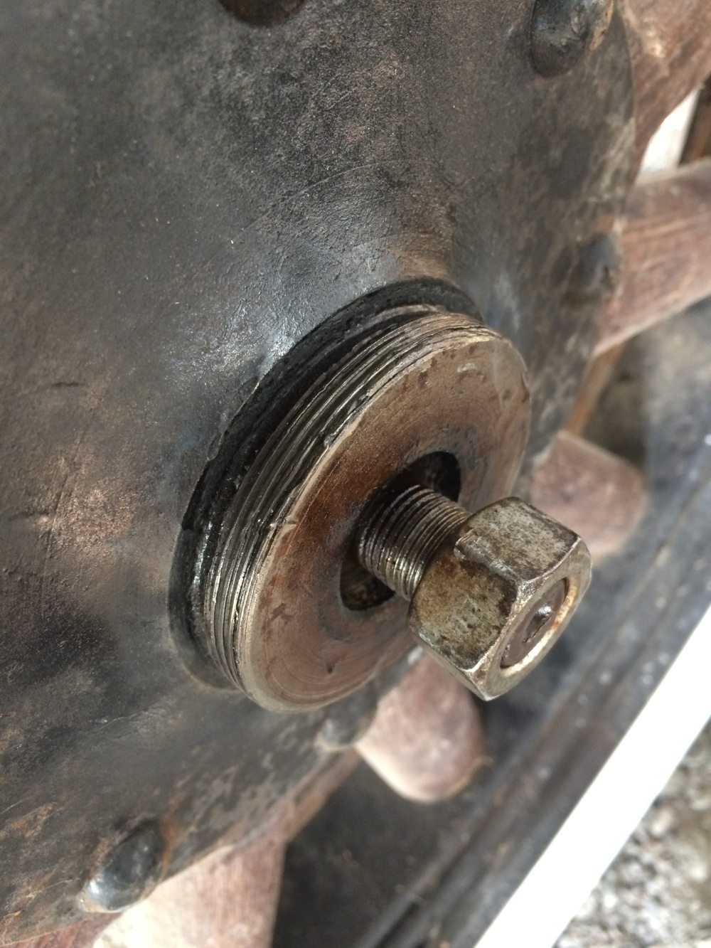

i have a 28 Essex drivetrain and i am trying to remove the rear wheel driver side, previous owner also tried by the evidence of hitting the threaded part with some blunt object, today i heated the dickens of the threaded part in hopes of expanding the housing so i can remove the wheel/drum assembly, no luck.. yes i have been using wd40 for some time in the summer and some penetrating oil..... any advice.. i have a hub puller that i almost had on and almost ruined the threads on it, i'm thinking wrapping a chain around the spokes and using a jack-all... BUT i can almost imagine ending up with a bunch of firewood and coming back here for better advice...SO the chain experiment is on big time hold.... any advice??

unfortunately it is only a drivetrain frame and non running motor on blocks, driving is NOT a option.. i will add a few pictures (somehow) tomorrow...0
As a last resort , maybe you could drill and tap two holes in that hub and use a good two jaw puller with holes in the legs. Threads look pretty rough there.0
