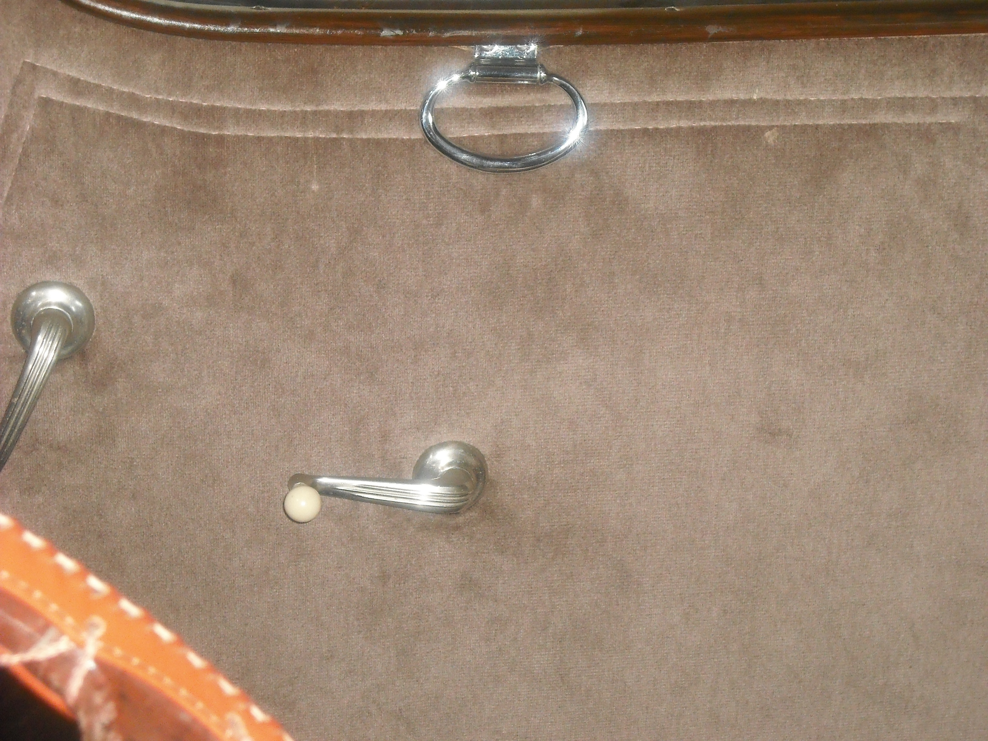

Thanks, I'll checkout both the 37 cord and 36 0 ring possibilities. Hopefully the reproduction sites for early ford's might have that as an accessory. Cheers ken0
Thanks Jeff for the photo. Found that they are a 1933 Ford inside door pull handle $50 a pair approx new reproduction which l'll mount once received from the USA. Cheers ken0
