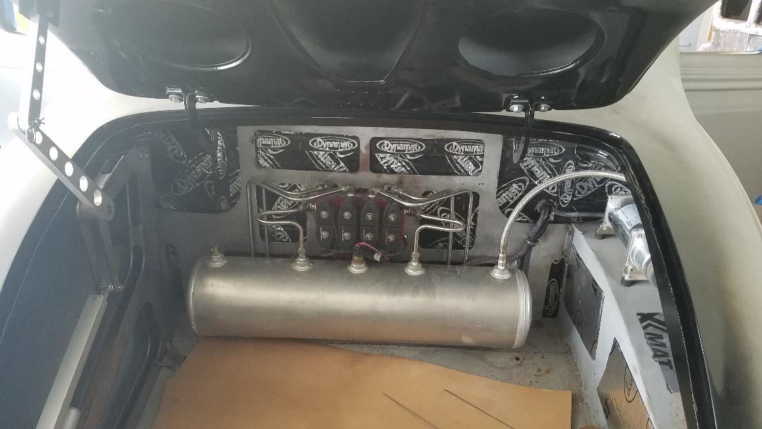

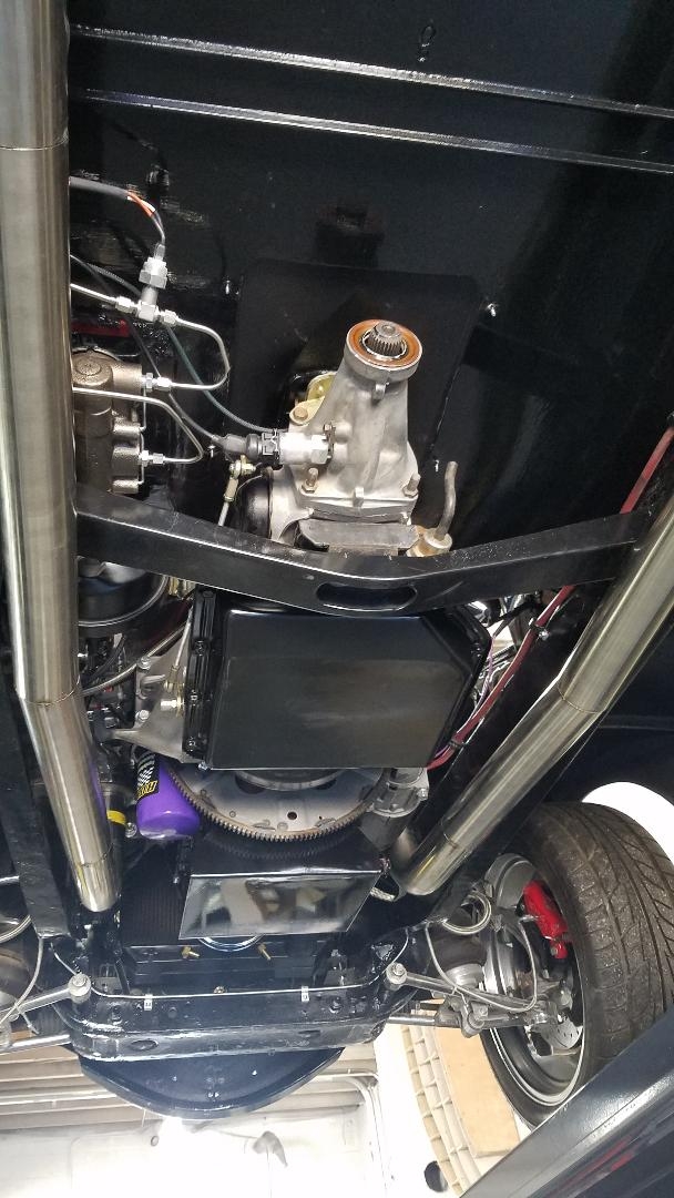

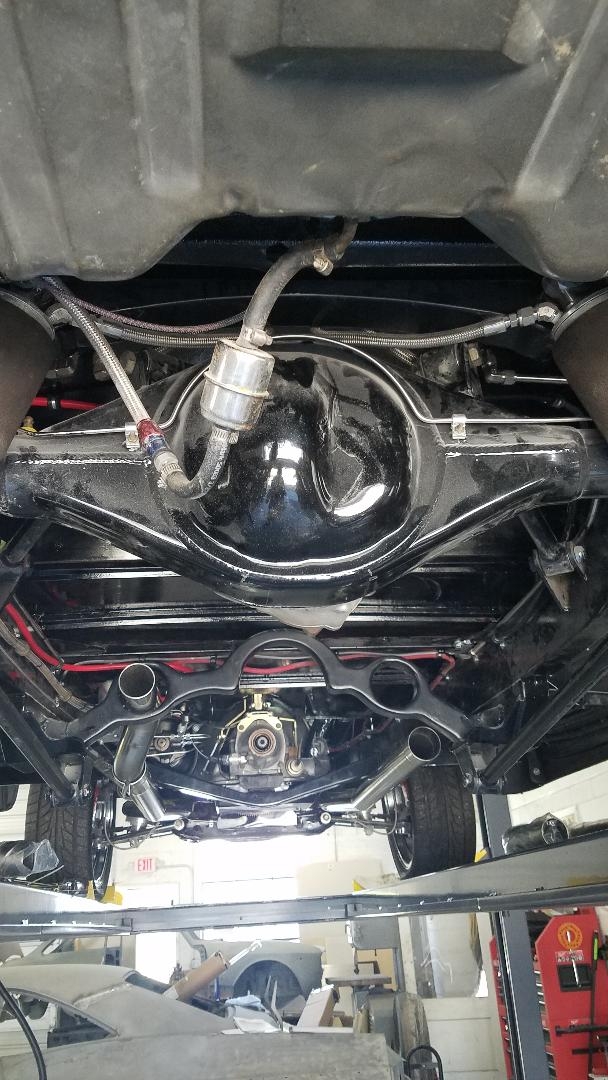

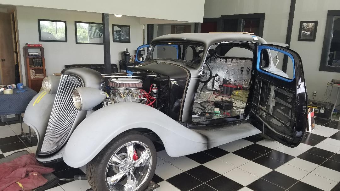

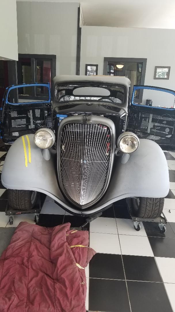

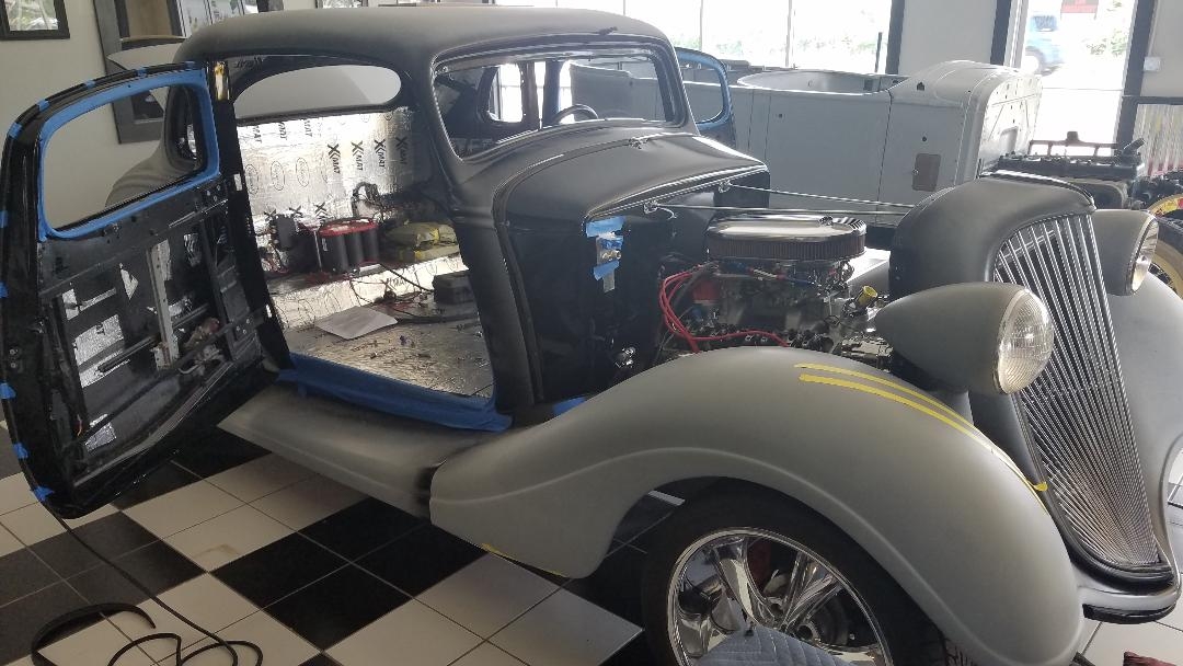

Here's a few pictures of the last couple of months work. We should be starting her up in the next week (once the exhaust is completed). Then back to paint.
It looks great except choice of wheels and tires. They make or break.0

Are you going to put the hex-and-wings back on the nose? This was a Challenger with no windwings? Interesting on the headlights - presumably half converted to halogen. I also had the 36 bullet headlights with regular sealed beams on my 34 for a time - I went back to the big chrome original Tribeams.
Wheels and tires and paint color and everything else are of course a matter of personal taste. Otherwise we'd all still drive black Model Ts. Many do not understand the appeal of street rodding these cars at all, but, as you would know, one of the hallmarks of the HET Club has always been their embracing of all forms of Hudsoning - rodded or stock. Plus, every 34T coupe that goes rod means my original gets more rare.

dholck, I am putting the hex and wings back on the nose. The car was put on hold, after I pulled it from Fantomworks. They were doing terrible work and it wasn't cheap. Once I did that, I put two kids through college, but now I'm back on track! Hope to have things complete by October? I am still looking for the hood latches, so if anyone has them, HELP ME, PLEASE! Walt

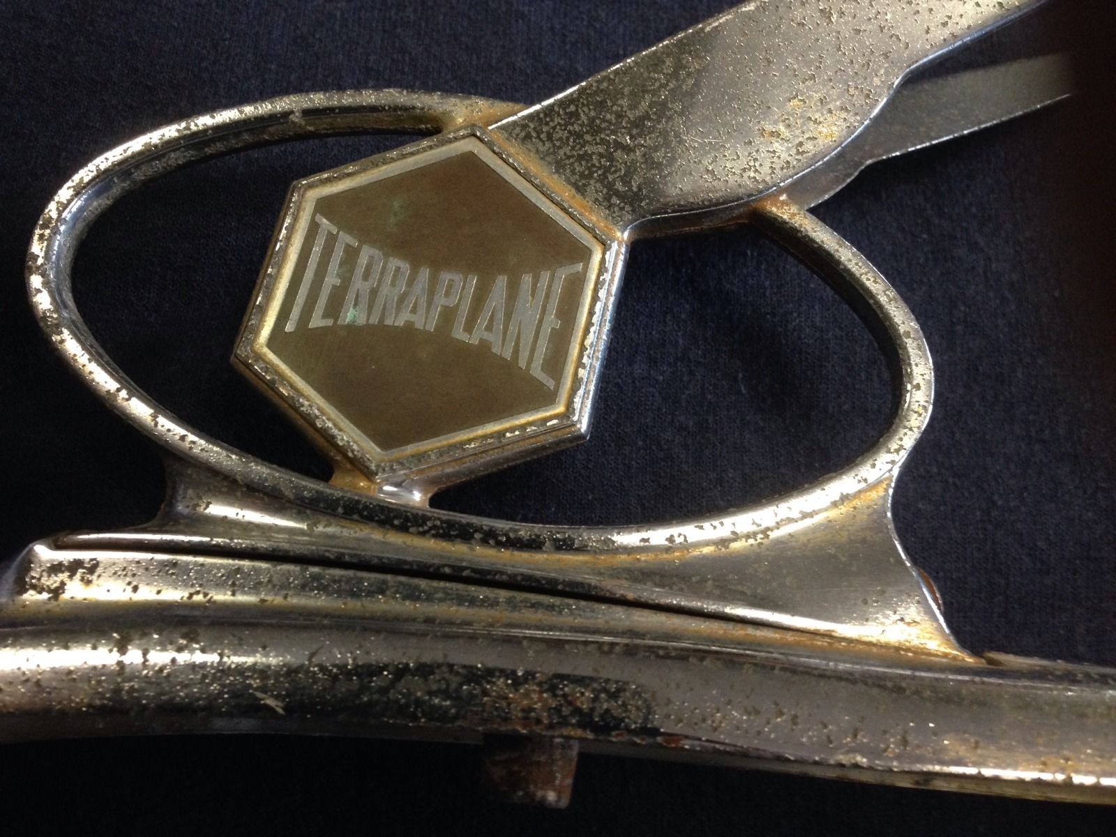

As I say; try contacting John Rosella and see what he might have left from those parts he was selling a year ago. I got a hood ornament base from him - took 40 years to find a spare. I have a place that makes a nice vinyl overlay piece for the "Terraplane" lettering on the hood ornament - I found that it was hard to find anybody to paint it, and the vinyl means the lettering will be crisp and nice even if not sharp anymore from re-plating. Vinyl also worked great for the hubcaps (not of interest for you).

Let me know if you have an interest in the hood ornament inserts. They can make them in various colors; I think most people agreed that they were white background, but I remember mine was brown/bronze color, but that could have been from age. When reproduction 34T hood ornaments were available they were doing them with white background.

I have an excellent fabricator working on the hood now. I'm sure he'll come up with a fix for the latches. I am interested in the inserts. Have you had any issues with them staying in place?
We started the Coupe up last week and it sounded great! Started on the first crank. I hope to take it out for a test run next week. I'll let you know how that goes and try and post some pictures. My upholsterer is also coming into town next week to go over my plans for the interior. Things are finally moving along pretty quickly now!
Paint is complete! Assembly is in progress. Goes to the upholster end of the month.0

Did I not ever answer your question about the hood ornament vinyl inserts? No, I have had no problems with them at all; they seem to hold up amazingly well - also on the hubcaps. Even a vinyl insert on a reproduction muffler tip 'diffuser' with the Terraplane hexagon logo - I figured it would not last because of the heat from the exhaust - doing fine so far.0

Thanks for the information Tom. I had some fabricated. The 34 is in Delaware getting upholstered and should finally be back home in Virginia within the month if I can get her out of quarantine!
Finally received the 34 back from the upholster. Should have her on the road in the next couple of weeks!0

That is the best looking 34 Terraplane I have ever seen. Does it have a custom "chin guard"?0
@Old Fogey UK: I have a Flaming River Steering Column with a Banjo Steering Wheel. The frame is a boxed original, but has been highly modified. I have a Mustang II front end and a Curry 9" posi-traction with Wilwood disk breaks on all wheels. @54coupe: I did have a custom chin guard built due the low front end. I installed an air ride system that allows me to adjust ride height. This allows me the ability to negotiate the many speed bumps in my area. Thanks for the compliment!0
dustymaxhudson said:@Old Fogey UK: I have a Flaming River Steering Column with a Banjo Steering Wheel. The frame is a boxed original, but has been highly modified. I have a Mustang II front end and a Curry 9" posi-traction with Wilwood disk breaks on all wheels. @54coupe: I did have a custom chin guard built due the low front end. I installed an air ride system that allows me to adjust ride height. This allows me the ability to negotiate the many speed bumps in my area. Thanks for the compliment!0
