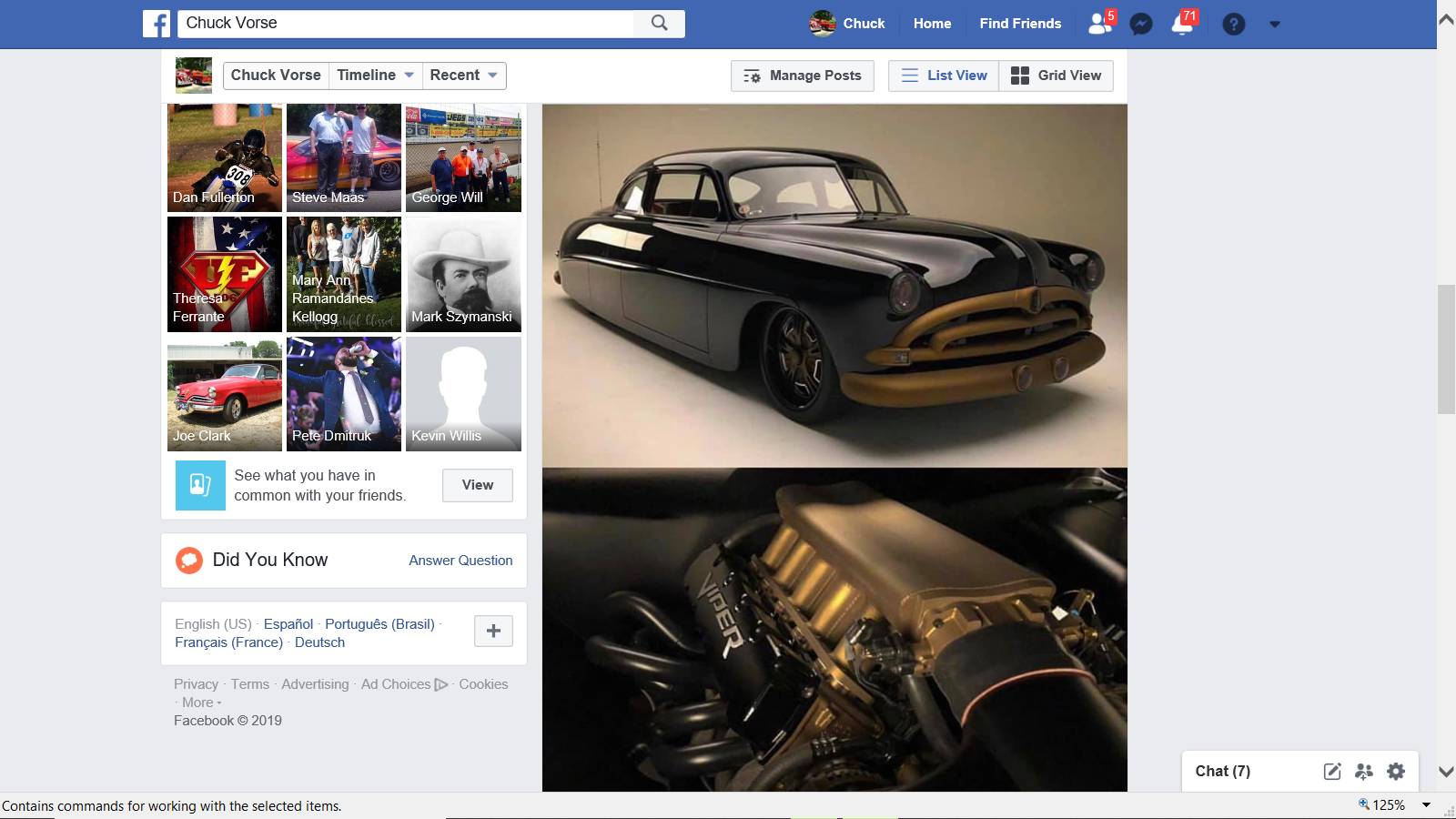

There is MOPAR Viper V10 Stepdown Posted on the Facebook Hudson Forum now. If this will fit a Hemi should be no Problem...
