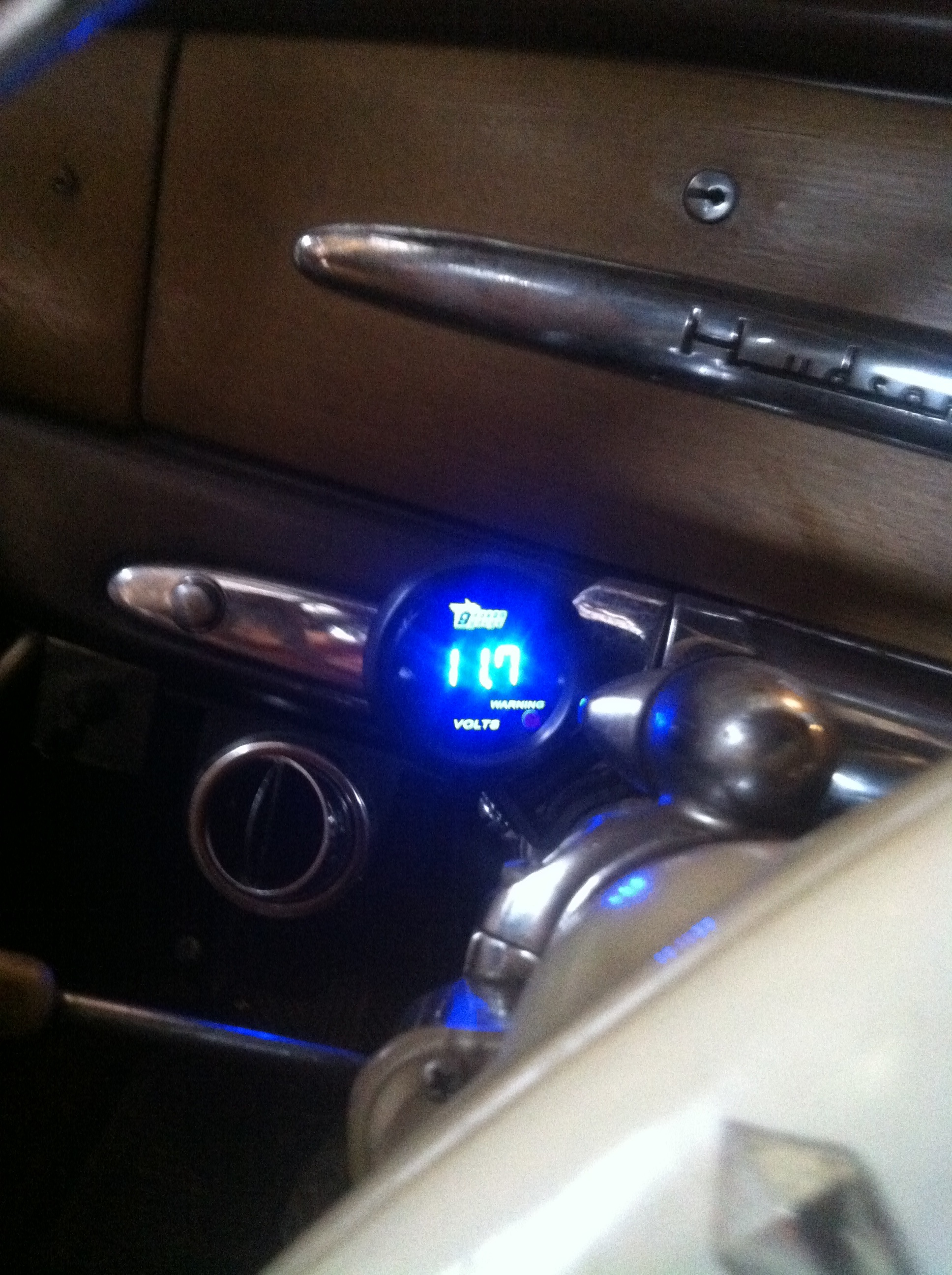

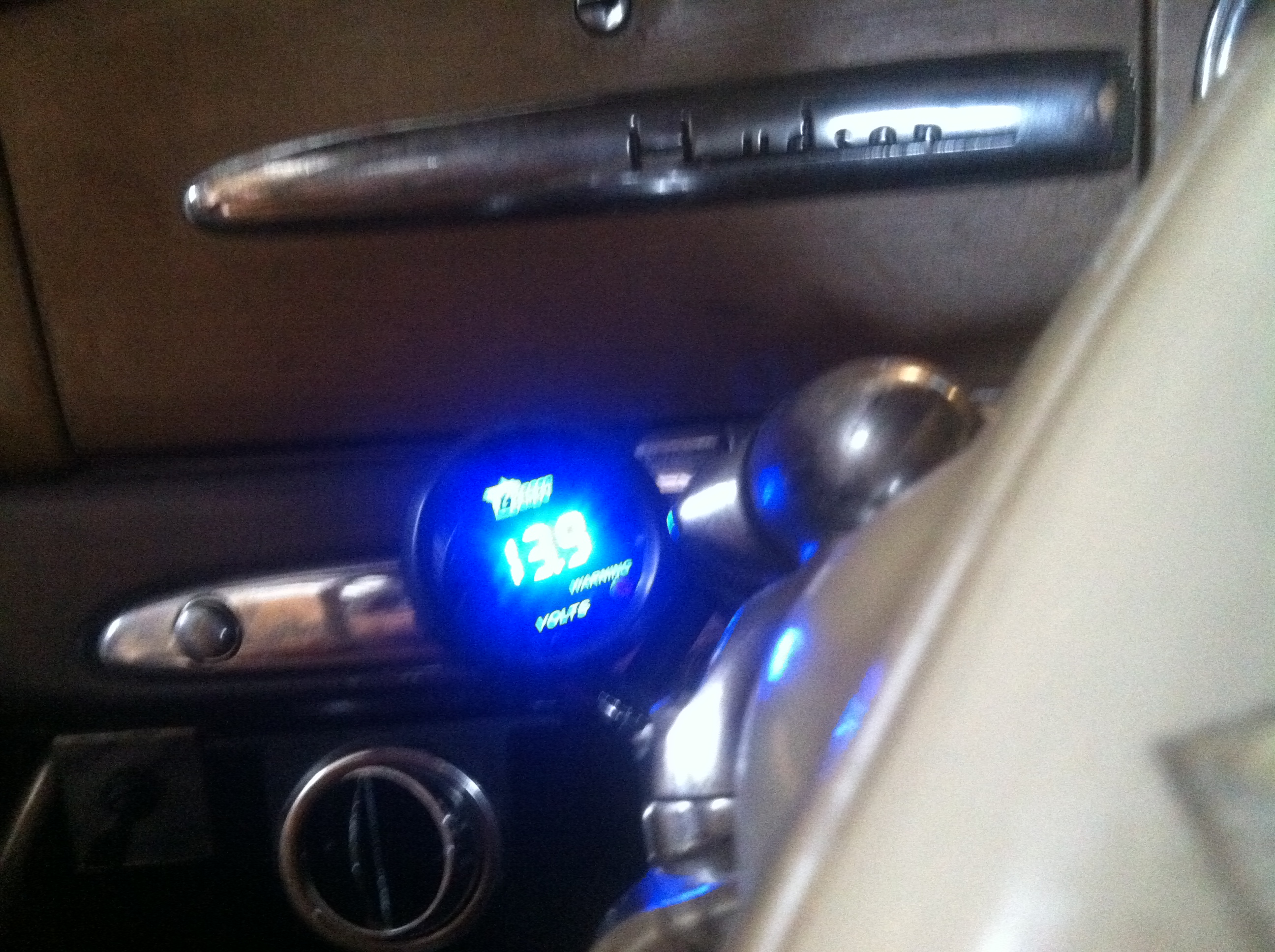

I went ahead and installed a digital volt meter. I stole the idea from TwinH. The digital oil pressure gauge is supposedly on the way. Here are a few pics of the volt meter.0

Digital gauges will look very out of place in your vintage car. I ran into the same issue with my 79 GMC truck I have been restoring. Dakota Digital made a fancy digital dashboard for it which some people love, but I do not. I replaced the stock (6) AC gauges in place of a custom 23 gauge Stewart Warner instrument cluster on engine turned stainless steel. A majority of these gauges are from the same series, (same diameter, same pointer, same dial design), however a few of the gauges I wanted were never offered in the series, so I generated new dial designs in Adobe Illustrator and screenprinted them on some sheet metal to make appropriate dials for different series mechanical gauges. It costs a fortune to make a really nice setup, let alone figure out which sending units you need before hunting them down, but I reckon its worth it. I believe Stewart Warner built many of the factory gauges for the Hudson Automobile, but I might be wrong on that. Their art deco style lettering will be awfully hard to match,

KTRON,My idiot light for the generator/alternator went out a few years back and I didn't realize I had a problem until it was almost too late. I didn't put digital gauges on the car for looks, but I want to know if I have a problem in advance.0
Why not both? Aircraft have warning lights to get your attention, and gauges to indicate the exact condition.0
