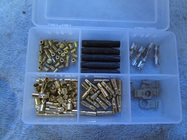

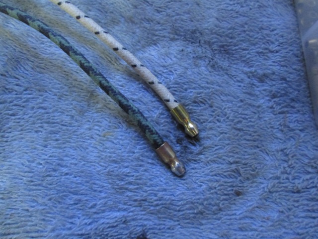

            Here is an example of what ether Rhode Island Wire or YNZ has to offer. Also an example of what they look like soldered on the wire.1
            I plan on soldering them on like original. The modern crimp-on kind you can get at the store are cheap and don't hold as good a connection. 16 GA size is not hard to come by but the fatter 12 GA type connectors are. Thanks guys for the response.
