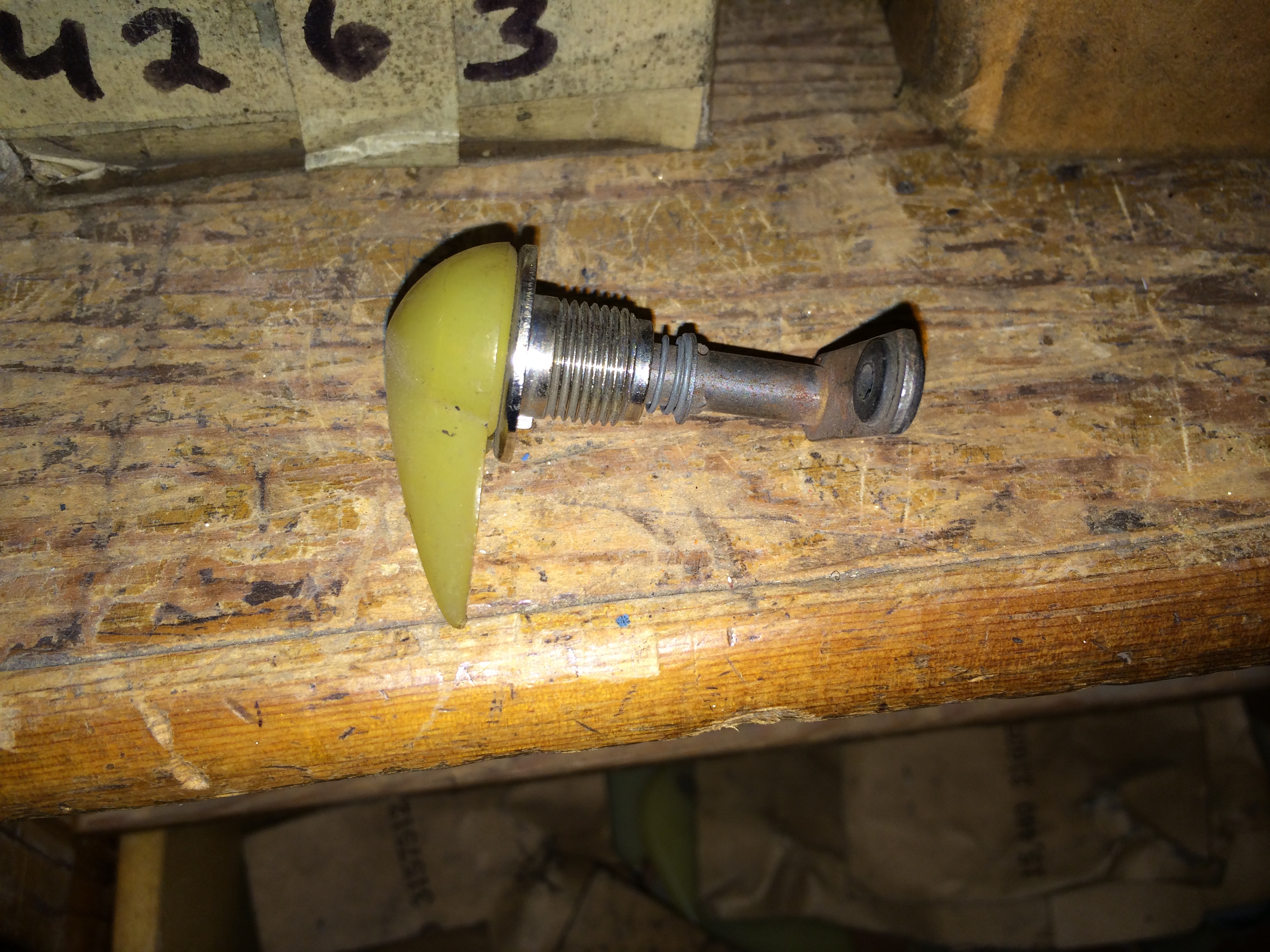

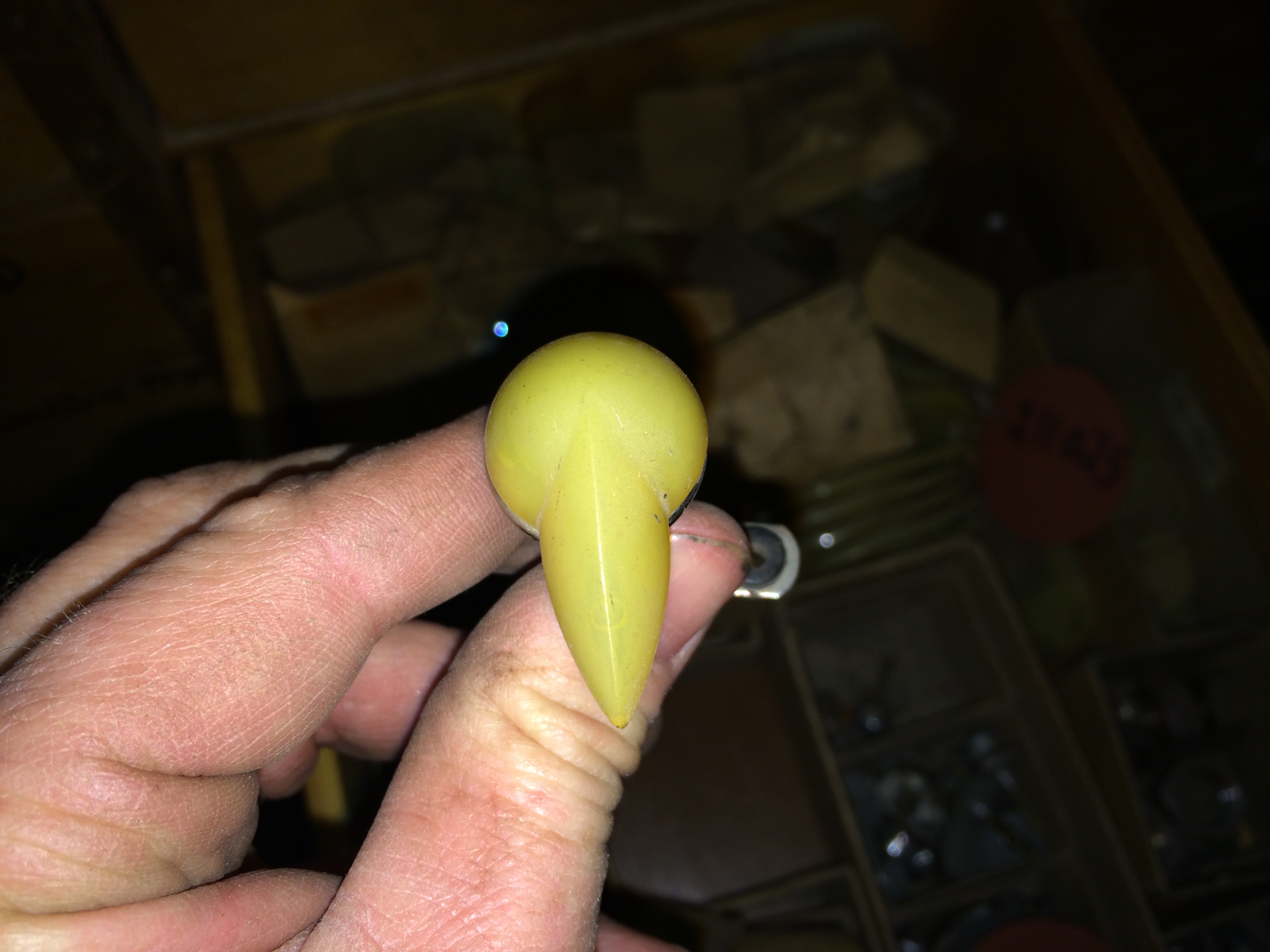

By the time I saw the ad it said one only. I have Hornets, so not sure what the original ones looked like, but I have a few of these NOS parts. .....They are already attached to the mechanism. Is this correct for earlier Hudsons?
            41-47 used these.0

            Jon, short answer, probably! This control assembly involves 4 part numbers from 1941-47.
1941 had a gray knob, #148155
1942 had cream/blond knob #204175 with NP base ? maybe nickel plated?
later 1942 #205968
In 1946 # 204175 is listed as for models w/o radio.
Later........#208810 listed as for with or without radio. Were chrome plated base.
1950 interchange book says #208810 is for all 46-47.
If you like to dig through parts books, this info found in Section U4-4 and U4-3.

??Just copied from the parts book (1940-1942) Agree, all 41's Ihave seen in my 60 years of studying
Hudsons had ivory/blond wiper knobs
