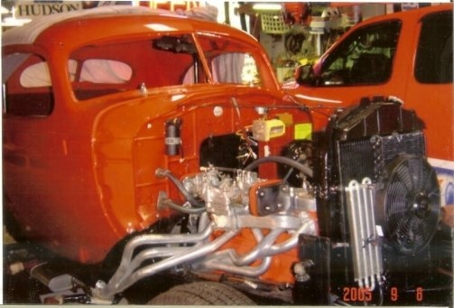

FYI
I installed a Hornet 6 coupled to a GM Turbo 350 trans In my Terraplane Cpe.... I had to trim the left & right diagonal pcs of frame under the radiator then I reinforced back the area by fish plating. I slid the radiator forward inside the original brackets. (The Rad brkt's hold the hood side latches). Later, it needed a larger radiator so I removed the hood 'Sides and installed an Aluminum Radiator. You will need a Pusfer Fan.The firewall has to be notched slightly up high near the dyl head & block.(See Black Area of firewall) I cuit the rivets on the crossmember to move it back for the GM Trans mnt. It was not a difficult install.The Floor board needs bent upward slightly and the floor near the X has to be trimmed up some.The Tubo 350 fits into X nicely but dont think a Turbo 40o would.The early Clifford Headers fit nicely inside & outside of the Frame Rails.
