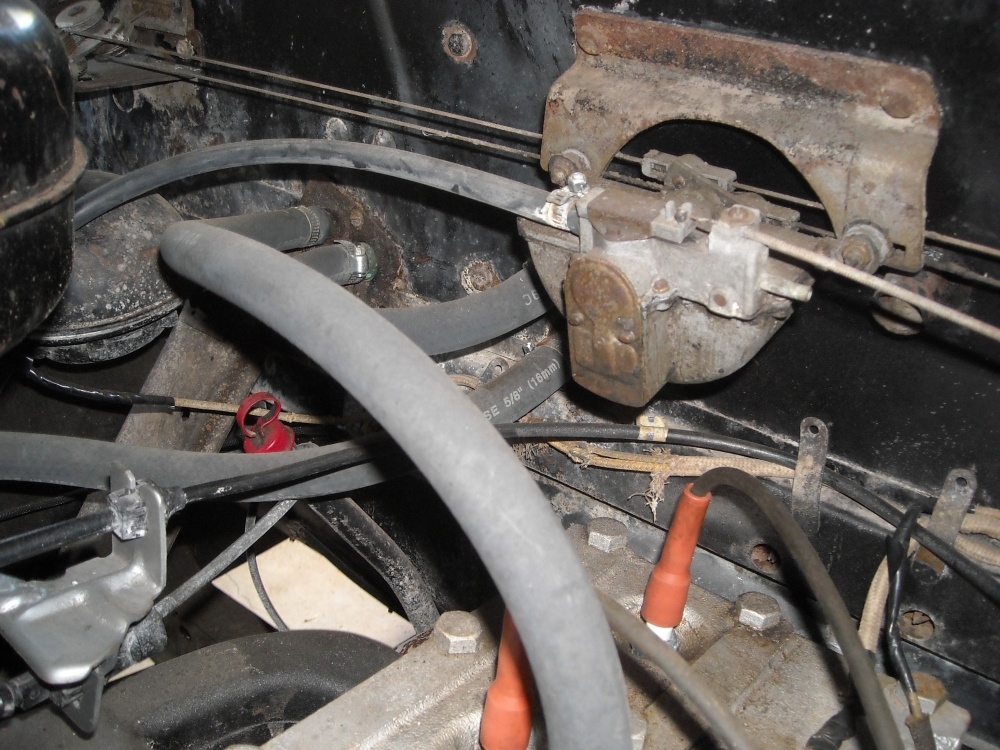

There is one vacuum line from the intake manifold to the passenger side of the wiper motor. On the driver's side of the wiper motor there was no vacuum line either plugged or attached to wherever it goes to. So I ran a short line and stuck a golf tee into it. No change in idle.
BTW what does that driver's side vacuum line connect to ?0 -
There should only be one vacuum hose to the wiper motor.0
54coupe said:There should only be one vacuum hose to the wiper motor.0
I’ve never seen a second port, maybe put a rubber plug on the second one if you’re getting a vacuum leak, not sure0
cheyenne7271 said:I’ve never seen a second port, maybe put a rubber plug on the second one if you’re getting a vacuum leak, not sure0
I wonder if this second hose goes to the wiper switch for the windshield washer? I've never had a Hudson with that feature, so I'm guessing now.0
oh oh that makes sense, I guess the washer uses vacuum to move the fluid0
