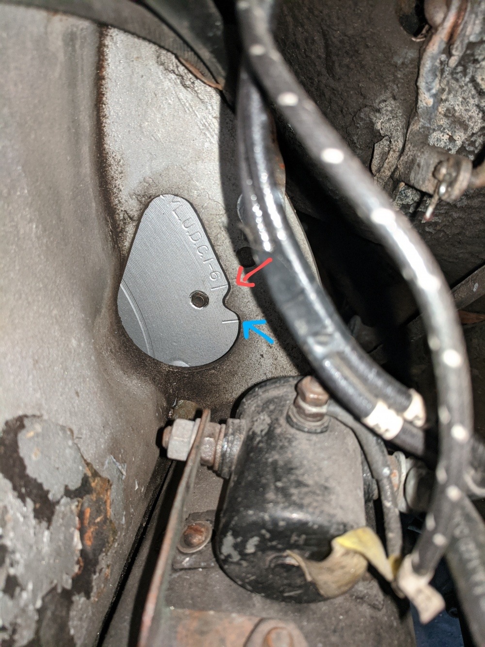

If anyone can please tell me about how they set the ignition timing in their late 1930s cars. I have been doing it and always set the pointer in the middle between the mark on the fly wheel (as shown in the picture) but I read that  "Timing  is 5 degrees before topdead center. First on flywheel ahead of "U.D.C. 1-6" should register pointer at flywheel inspection hole."
So AM I to take that as I should put the pointer in line with the mark closest to the U.D.C 1-6 ?  Or is where I have it set acceptable?

    Set it to the first mark with a timing light at idle.

    Geoff, by first mark you mean the one closest to the 1-6?

    The right hand mark, which is the first one that comes into view..
  • Old Fogey UKOld Fogey UK Posts: 596Expert Adviser
    Geoff Moore, the technical guru of the ROC, advises for 8 cylinder engines  that the timing should be set to the maximum advance mark which is 3/4" before top dead centre to cope with modern fuel.
    Would our own resident Wise Old Owl (aka Geoff 😉) concur with that ?

    I forgot  to mention  that the ROC says that 3/4" before TDC means the longer leg of the H mark, i.e. the right leg of the H.

  • ValVal Posts: 907Member
    Thanks all, the good doctor says where I have it is good
