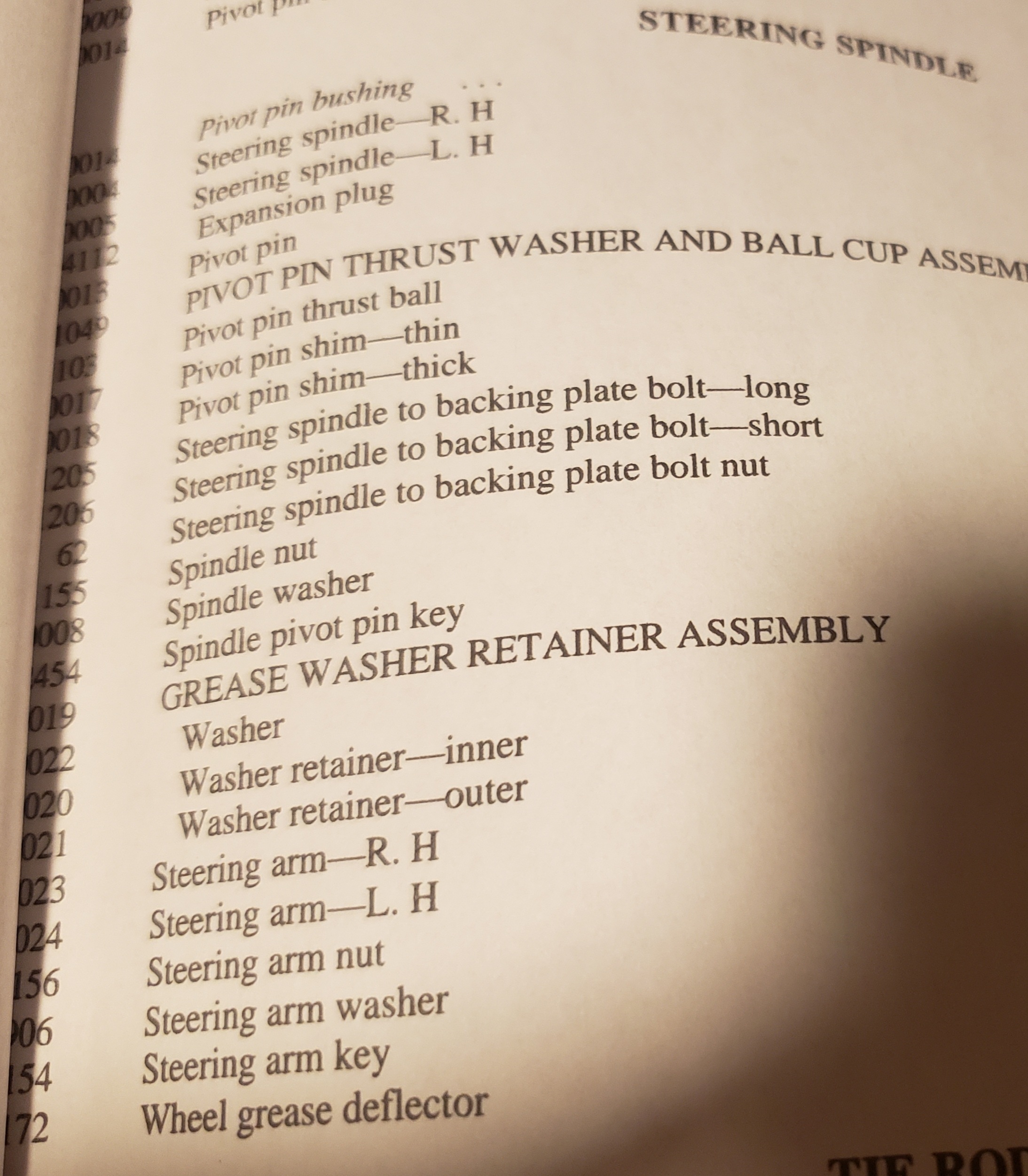

I've looked in the original 1932 parts book for my Terraplane but I see no reference for a front wheel grease seal..and when I disassembled the front drum bearing and races there were NO seals to be found! Anyone have a clue or a modern interchange? At this point I know 32-33 Terraplane uses the same front hub and bearings so the grease seals should also be the same. Thanks!
Did you look under “Front Axle”?0
Yes, they only list a grease deflector not a grease retainer.0
That’s it. Thats all ya got.0

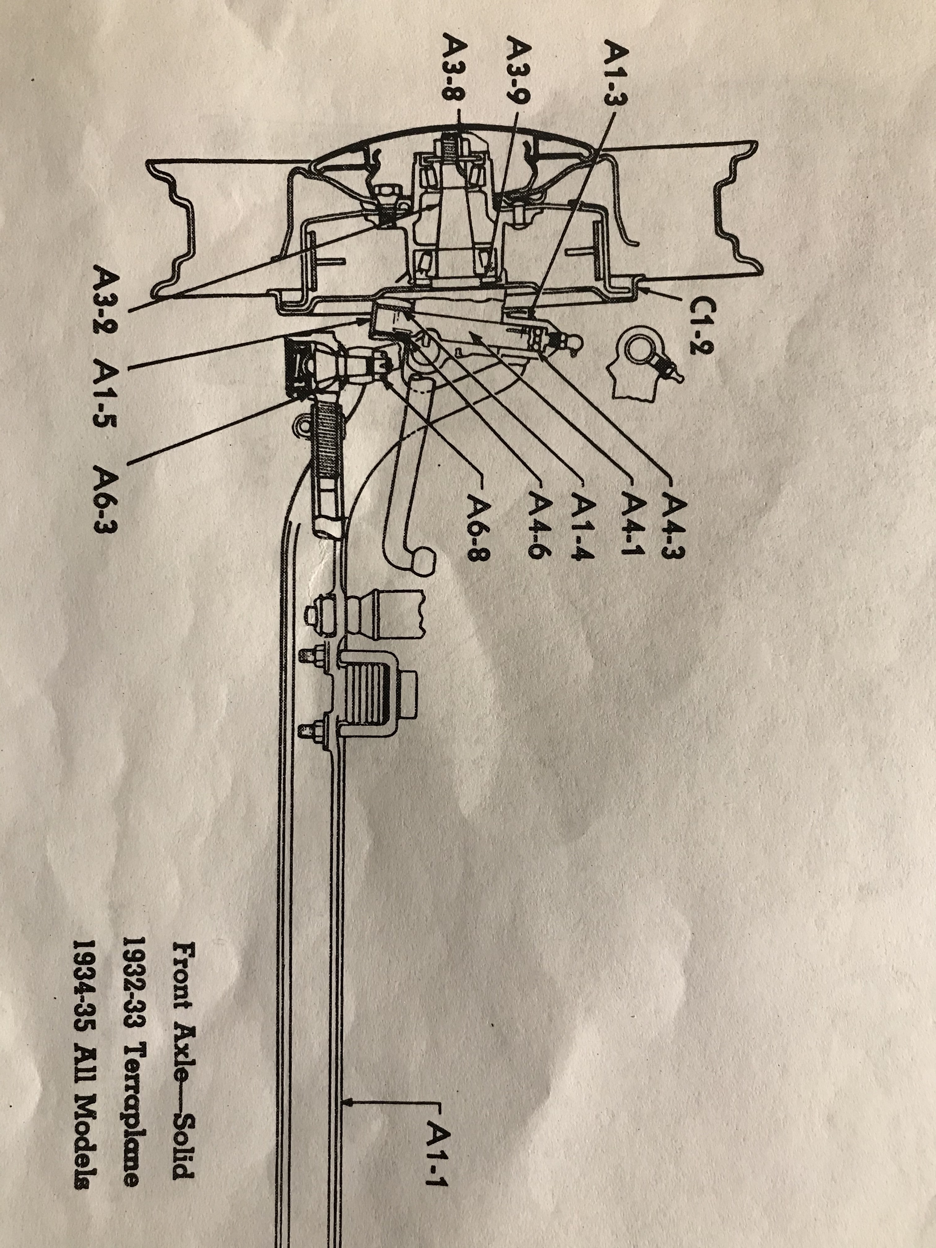

Scott, The attached 1932-33 Terraplane front axle drawing does not show a seal. A3-9, spindle washer, appears to pilot on the brake drum. Looked at front wheel bearing, didn't see a seal there or in the section on wheel hubs and drums.
Thats what I was thinking, because no typical wheel grease seals were in place when I disassembled the hubs.0

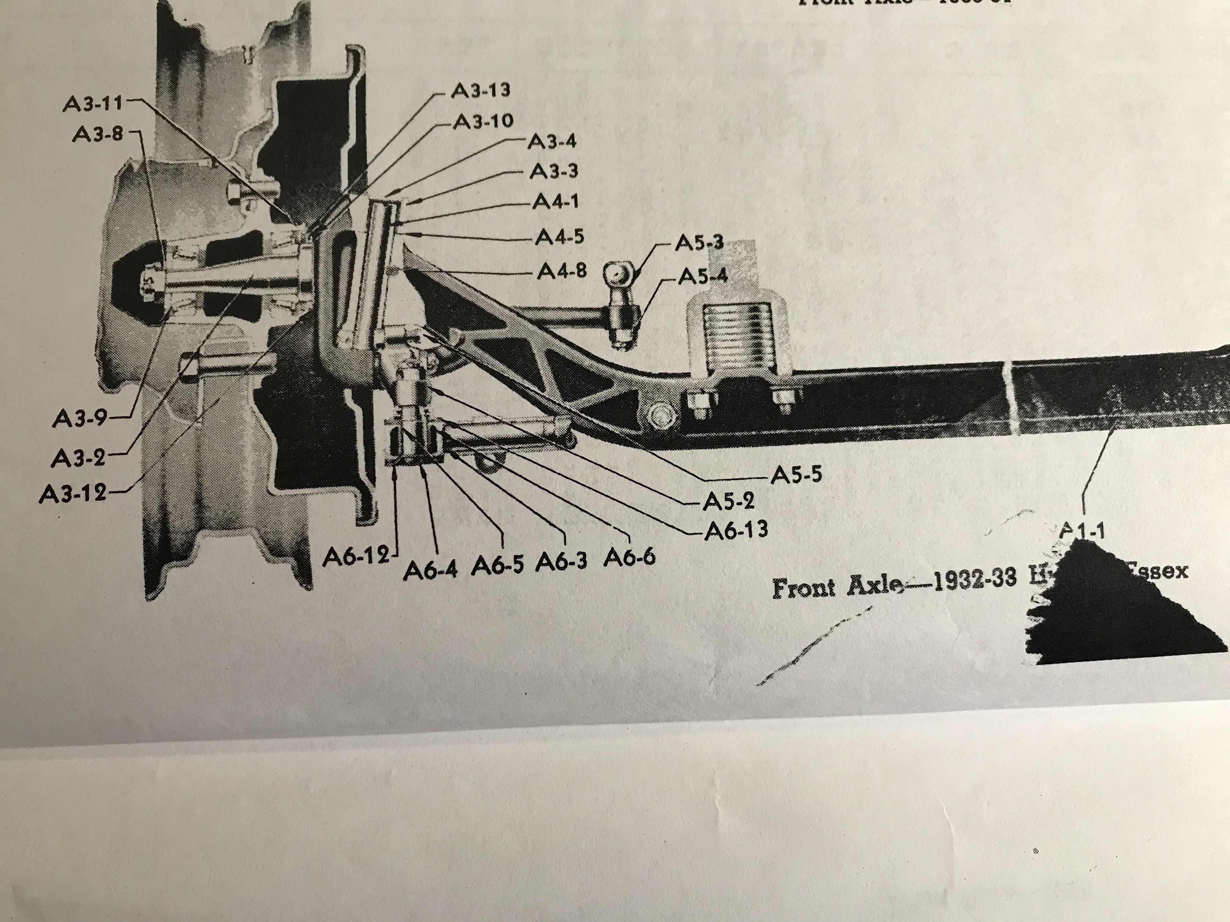

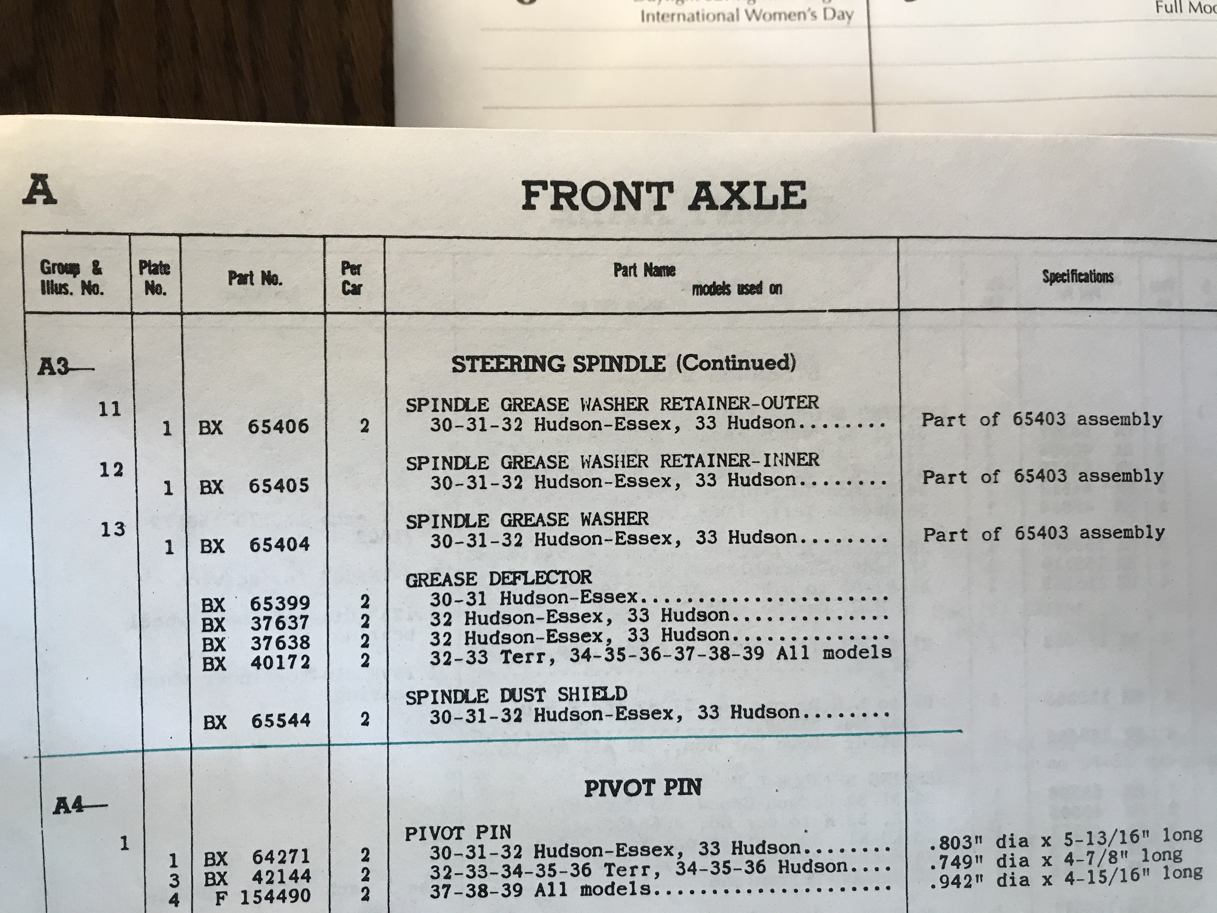

32-33 Hudson Essex axle drawing shows A3-10, Spindle grease washer & retainer ass'y.
Also has callouts for A3-11, -12 & -13. In the specifications column next to these is has "Part of 65403 assembly" which is the part number for A3-10. I'm guessing that A3-13, spindle grease washer is the felt washer sandwiched between A3-11 & A3-12.0 -
Applications are odd. 32 Essex is definitely the old (pre Terraplane)Essex that continued into 33 as a Hudson
It would specify "Terr" to fit my 32. At least that's my understanding.0 -

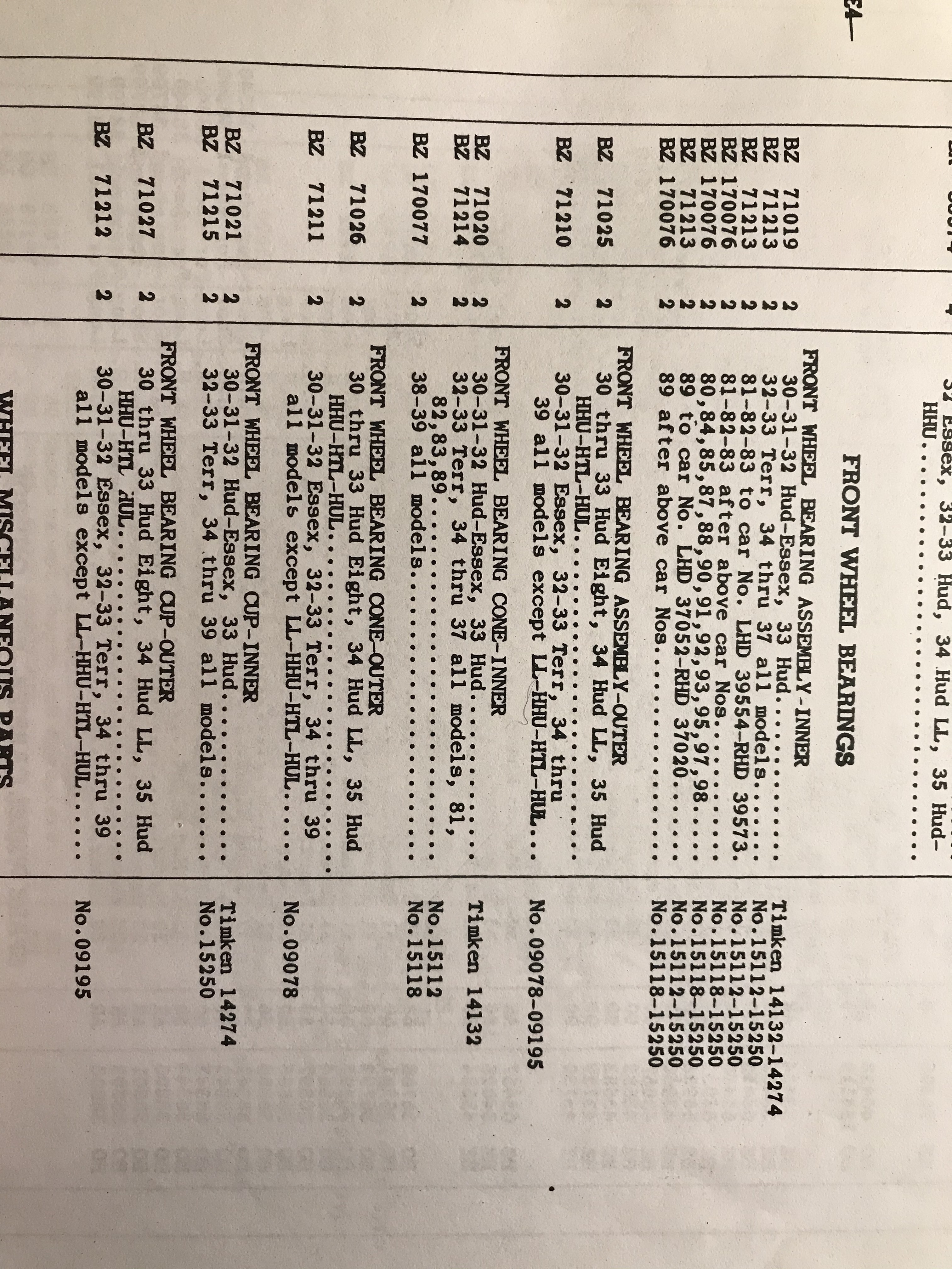

Thanks for those measurements Ken U-Tx, my locally owned parts store (Kings Auto) had National 710768 seals which did the job!
It still baffles me why the seals were missing!0 -
Those National 6507 seals are obsolete. Found a set of replacements on ebay.0
