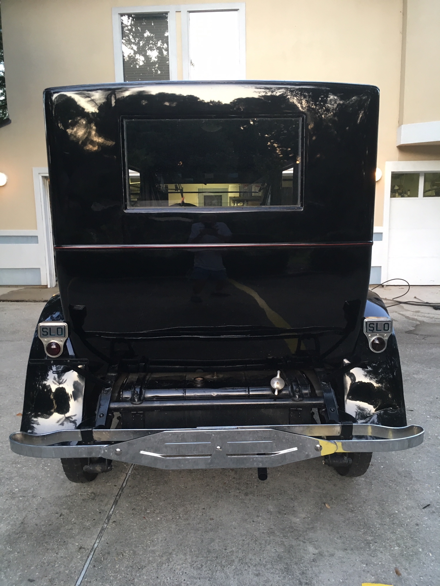

I have a 22 Essex and I have updated the tail light to dual filament. Brake and running light. So you will need to convert the socket from single filament to dual. Restoration Supply has the dual contact base plate rebuild kit that you need to convert the socket. If you can splice wires or solder you can do it. They also have a pricy control box that you can buy that does what you need and has labeled terminals to make wiring easy. Yes, it is overkill if you are just adding turn signals. But if you want front and rear running light that also act as turn signals as well all the rear brake lights it works well. It certainly made wiring turn signals into my 37 Hudson with fender lights a breeze. The fender lights operate as the should but also flash, all on a single filament bulb.
Honestly, there are cheaper ways to go. it really depends on the amount of effort you want to do converting the old single filament system and making a duel system look like original equipment.
