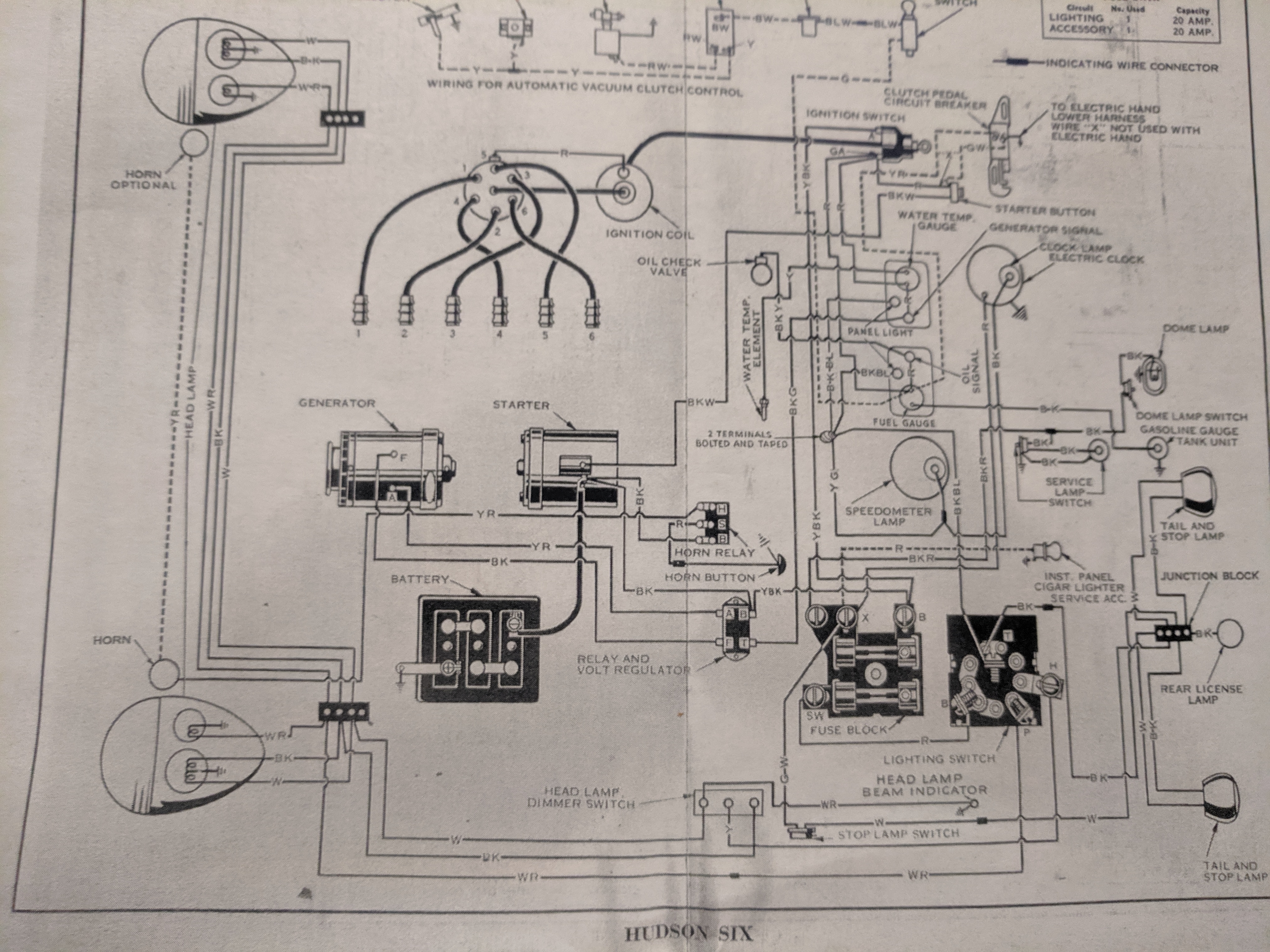

Installing redirad in my 39. It says connect to key on hot. Not sure which that is. Any ideas from looking at the diagram?

  • squirrelsquirrel Posts: 169Member
    on your wiring diagram, the R wires from the ignition switch to the gauges, or the R wire from the ignition switch to the starter button, with both be "key on hot power".
  • ValVal Posts: 831Member
    Squirrel, So I don't connect to the fuse panel?
    The fuse panel has full time power, it's always hot. It does not turn off when you turn off the key.

    The volume control is on the speaker. However the on /off knob does rotate a ways as if it were to control volume but as I don't have an antennae I cant get any reception to tell if it does or not. Do you have a radio in your 37 Jon?  Also I spoke with Matt at redirad and he suggest I check for key on hot behind the headlight switch. Not sure myself if that will be but I can try and see if its even accessible. My radio blocks me from getting to from behind on the ignition switch and starter button.
    I doubt you'll find any "key on hot" terminals at the light switch or fuse block. That stuff is on all the time, not only when you turn on the key.
    The gauges, ignition, and starter seem to be the only things that are switched on with the key.
    edited September 2019
    Gauges would be my best option then as I cannot access the ignition switch or starter button because of the radio
    Gauges are a no because of the radio. However, the ignition coil. That is Key on hot???
  • 54coupe54coupe Posts: 289Member
    Yes, it is
