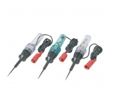

    A recommendation for test would be an inexpensive electrical probe testing set like those sold at Harbor Freight or Northern Tools.
    385 x 326 - 50K

    Anyways, a test light like shown above will be a big help to see if the points are working as they should. A digital volt meter will also work. Connect one lead to ground, the other lead to the small (primary) wire connecting the distributor to the coil. Turn the ignition switch on, and rotate the engine slowly by hand. You should see the voltage go from zero to 6v (approx) back to zero back to 6V each time the points close and open. If it's not doing this, then there is a problem...if that wire is always 6v, then the points are not making contact. If it's always zero, then there's a short, or the points are not opening.
