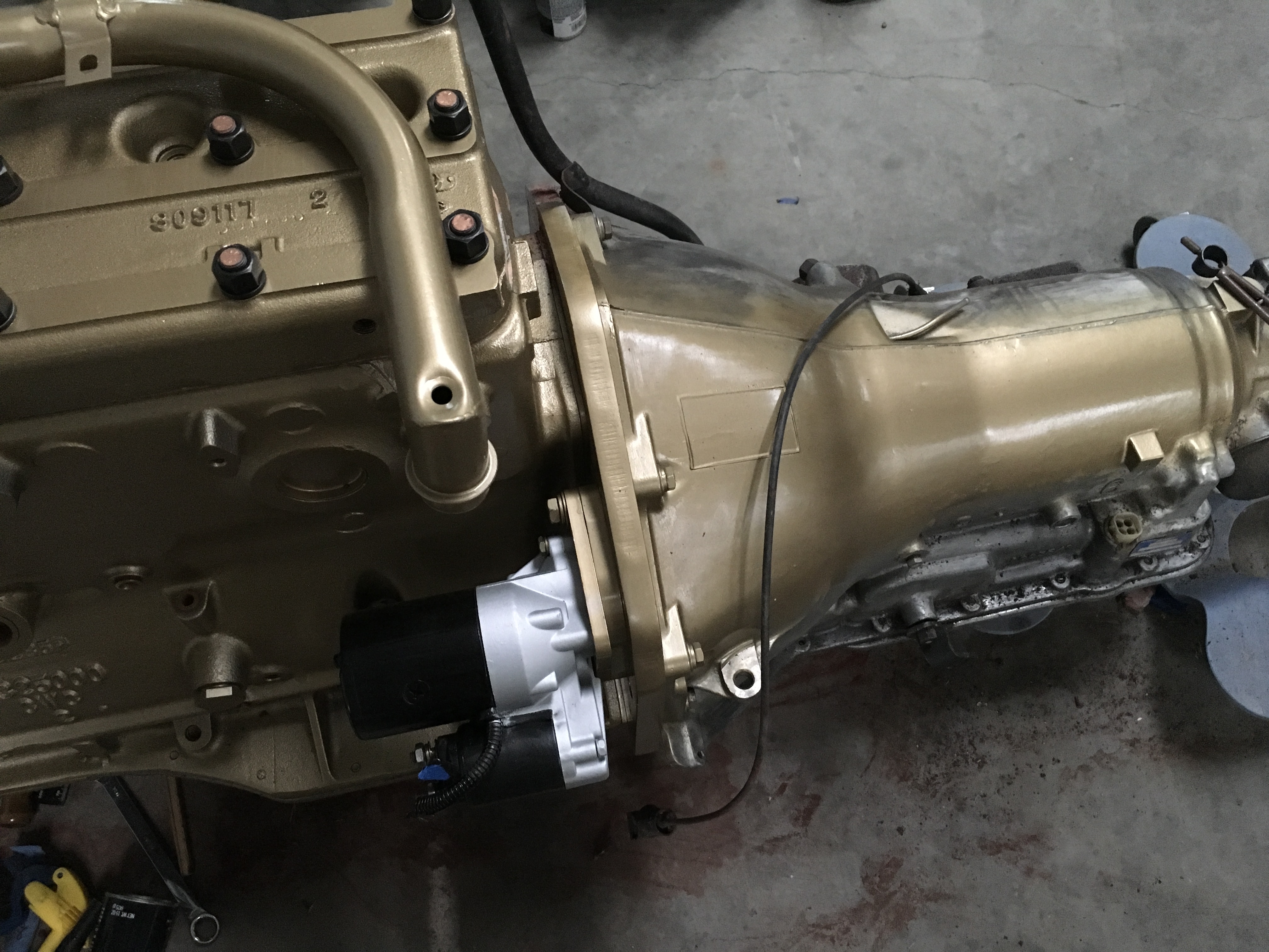

Bentsens and Wilcap make adapter kits, $935 and $730 respectively. First uses a GM flexplate and includes a starter, second uses a custom flexplate.

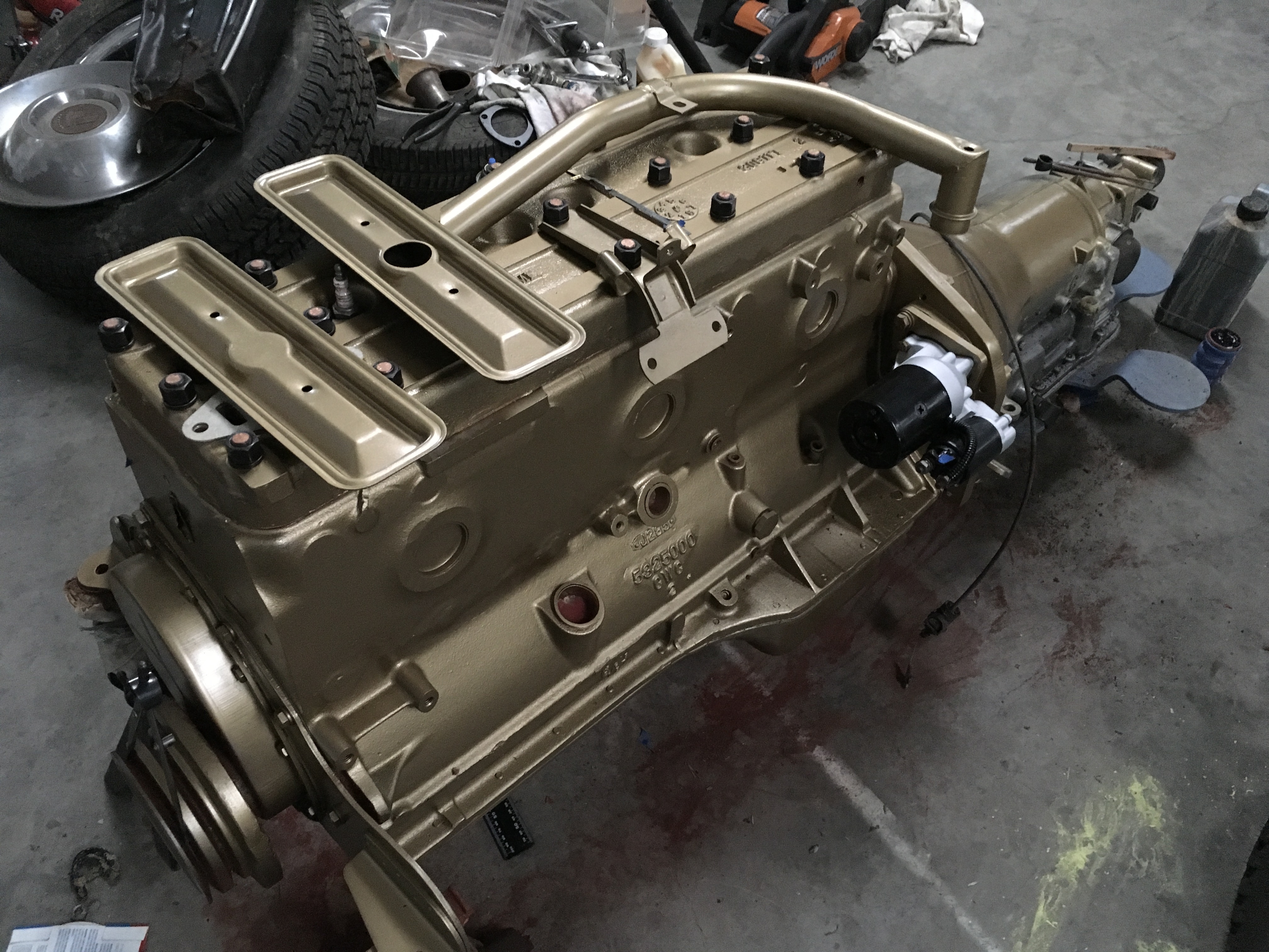

I got mine from Randy Mass if I remember correctly . It’s been years. Real simple as you can see. Some of the other adaptors are not.0
I do though have a problem. The 700r4 requires 12 volts. My car is still 6 . I think I will pull out the complete harness for my 1952 Hornet convertible project and retire the Brougham for 12 volts. My only concern is the gas gauge water temp cluster. How do I convert those two ?0
I discovered that the voltage regulator that is already connected to the temp and gas gauges (on my 51 Hornet) works just fine when given 12v instead of 6v. So, you don't do anything, they just work.0
