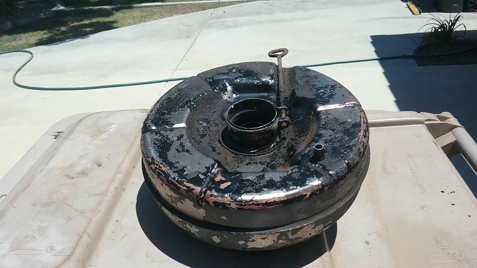

Does anyone have a correct oil bath air cleaner for 50 Super 6 262 2bbl for the Supermatic setup? The only difference I see is the vacuum or air intake port that the system connects too on the bottom of the air cleaner. Thank you
  • m.patterson56m.patterson56 Posts: 23Member
    I'd settle for a photo of the vacuum connection so could make my own! Any one got a photo to share?
  • Ducor KidDucor Kid Posts: 220Expert Adviser
    I have the filter off of me 50 Pacemaker Deluxe 232 with the Supermatic.
    Here are pictures of it.
    The fitting on top went to a Reclaimo Filter.

    Thanks Ducor, what does that lower fitting do? Does it act as a vent for the system?
    I believe you are right. It looks like it just provides a clean air source to Supermatic.
