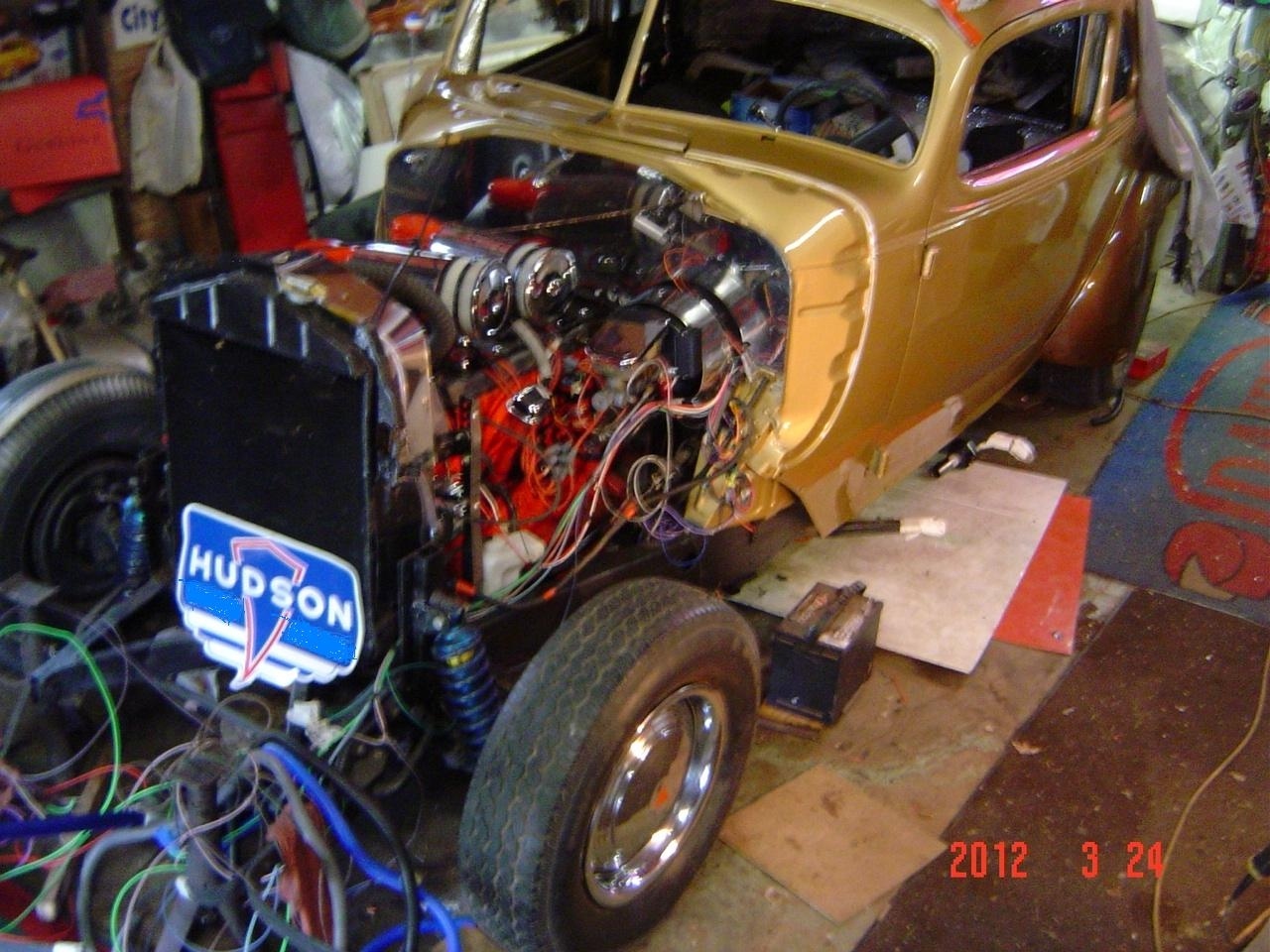

Ol Racer, what a great picture! I wanna visit your garage.0
keithfullmeryahoocom said:Ol Racer, what a great picture! I wanna visit your garage.
