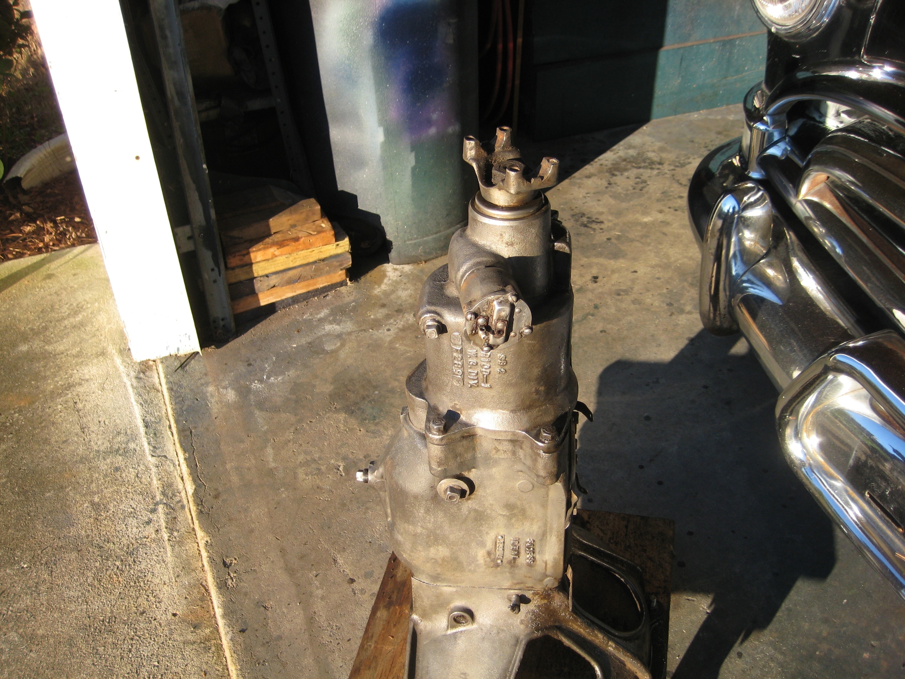

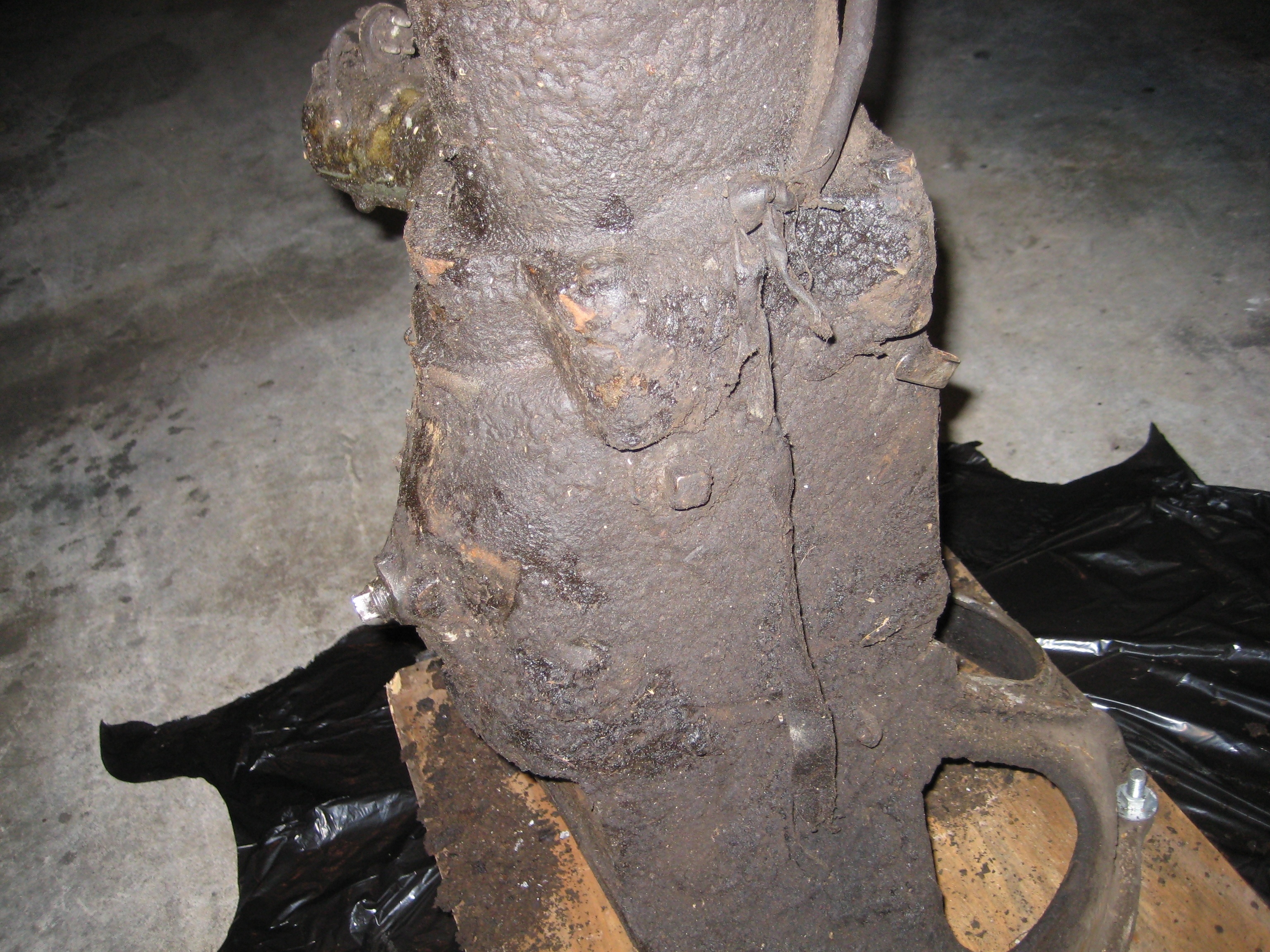

  • lostmindlostmind Posts: 1,202Expert Adviser
    The photo looks like the case is cracked. Frozen at one time?

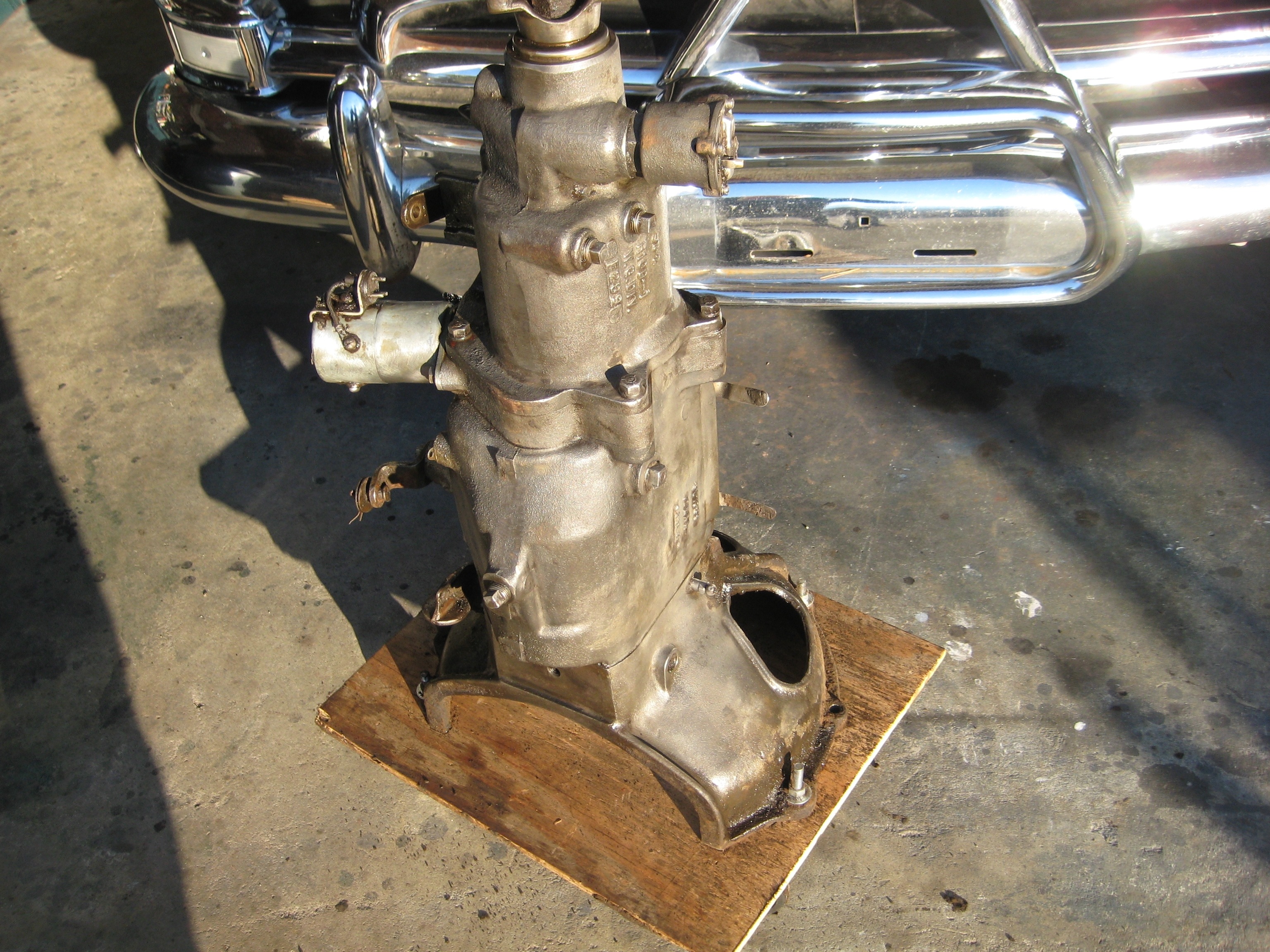

  • RichieRichie Posts: 964Senior Contributor
    Lostmind, it just looks like it was cracked from that angle. Here is a pic after some cleaning. Richie
    That looks better.

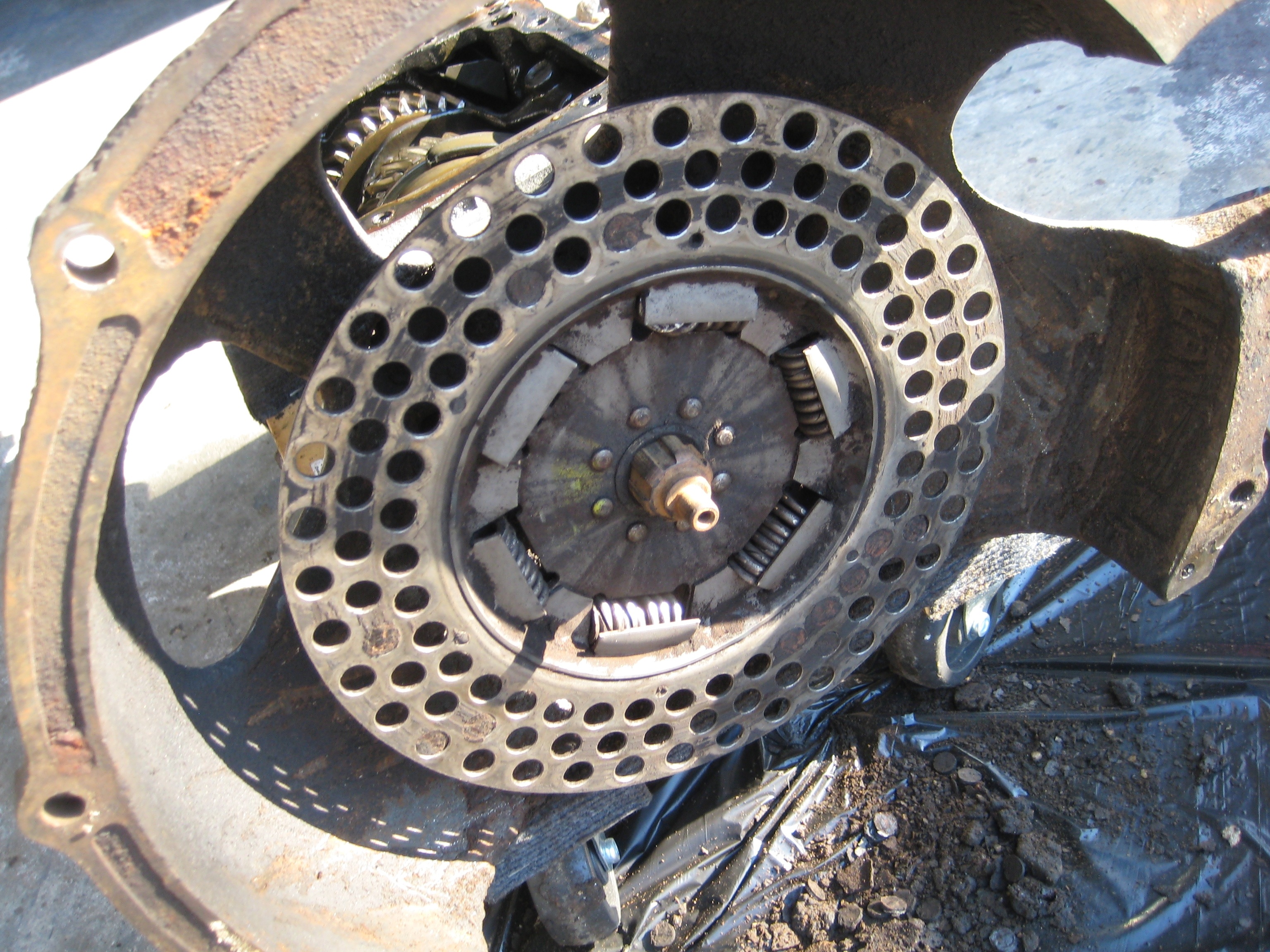

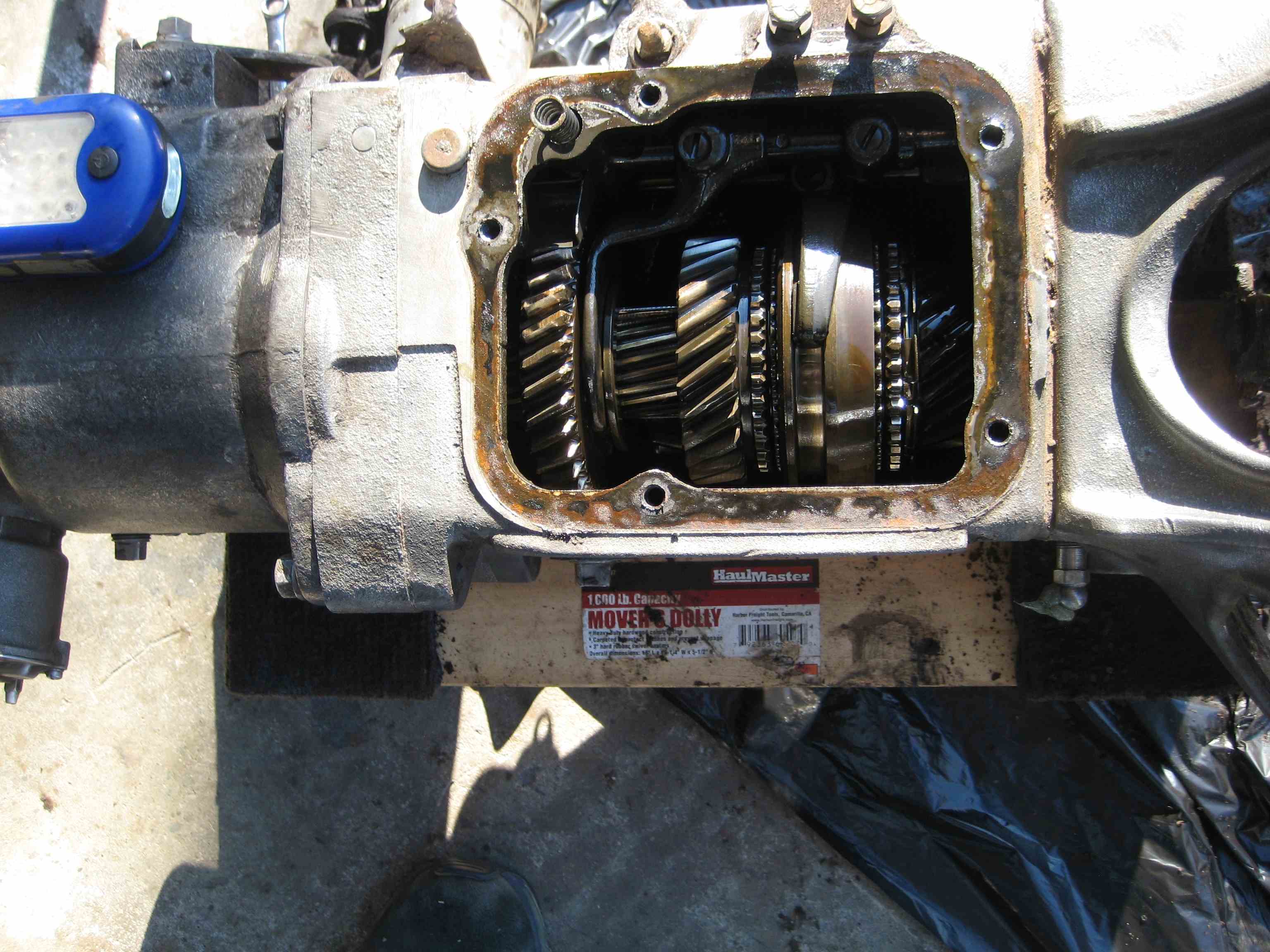

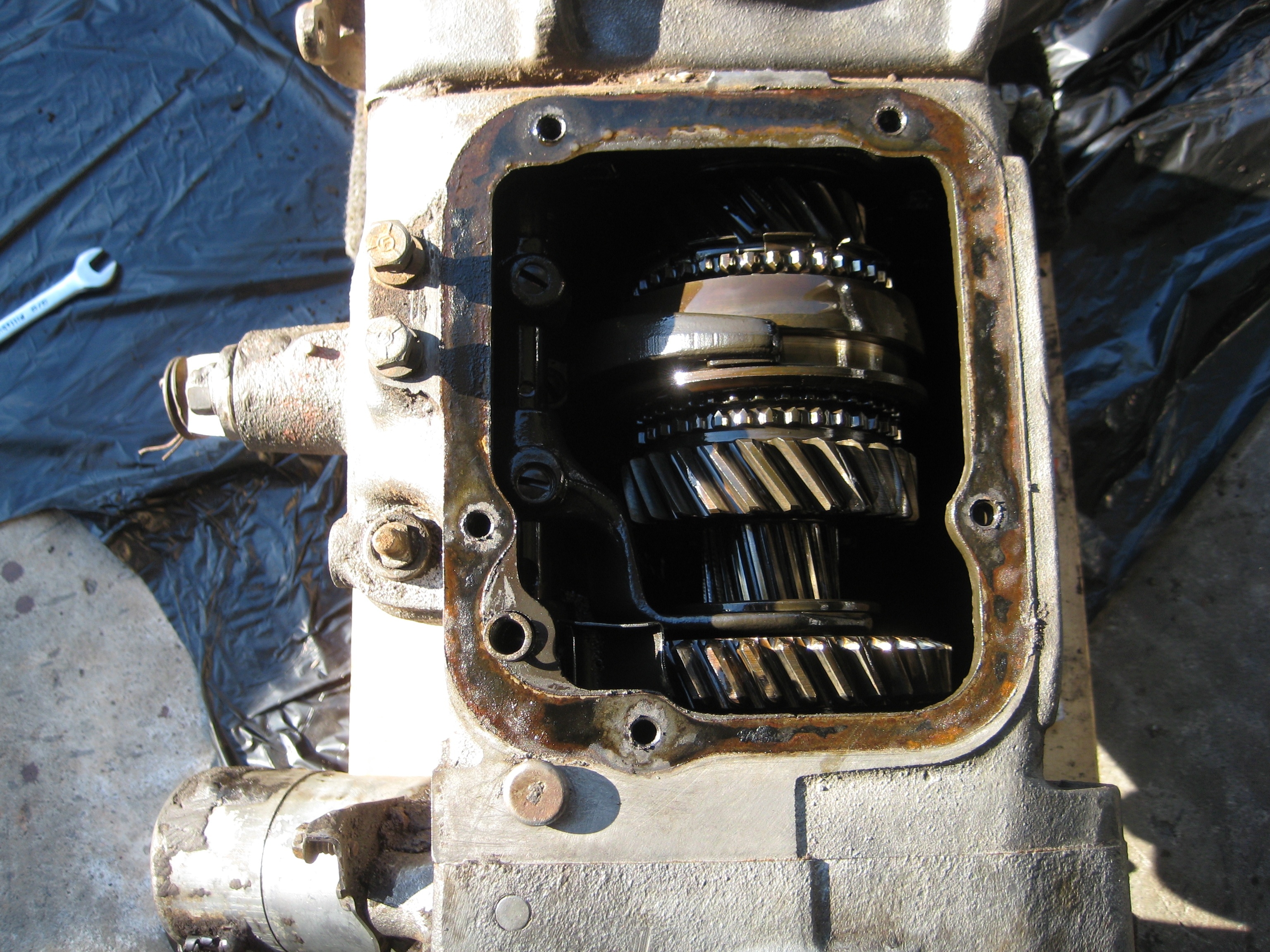

    Here is a pic of the inside. At first I used an old clutch disc to turn the input shaft but after greasing the throw-out bearing fitting the grease flushed out all kinds of dirt and old gunk. After turning it for a while and adding the 85/140 gear oil I could turn the input shaft with two fingers and it was smooth as silk. I believe all will be well with it the way it is now. Think I lucked out a bit. Thank all of you for your comments. Richie.
  • GeoffGeoff Posts: 3,531Senior Contributor
    Certainly looks fine, and if it runs easy it won't hurt to try it as is. You may need some better corks in the clutch plate though!
