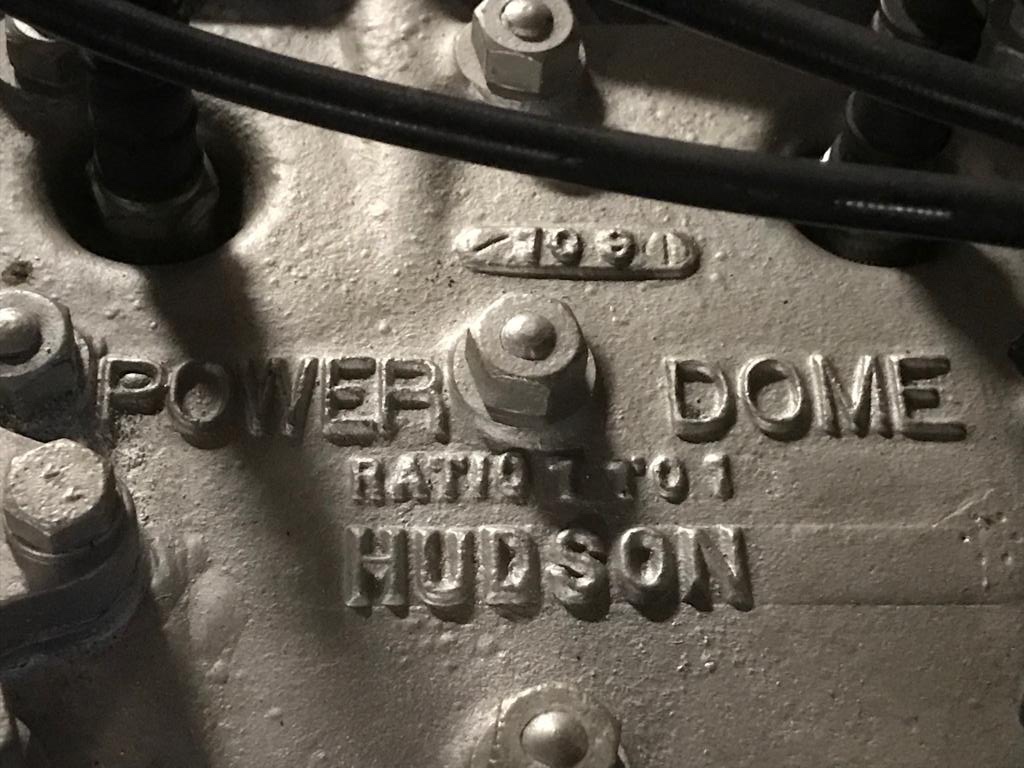

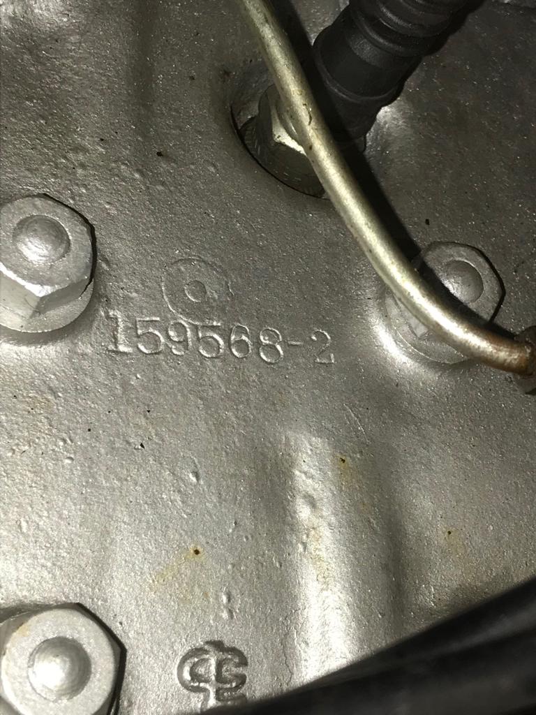

Thanks for the info's. Is there any sort of official source I might mention? The MOT service here in Luxembourg is quite annoying and they won't accept anything without some form of official prove. I have also attached a pic of the engine.0

What was my first statement? Engine number is stamped on the surface of the block near the front right side between the exhaust ports.0
Foundry casting number found near the starter motor on the crank case may help with I.D. 162610 is from 1946+ 1947. 162450 is found on some 1942's 159547 on 1940 and 1941.
Owner manual will have the specs.
Good luck0 -

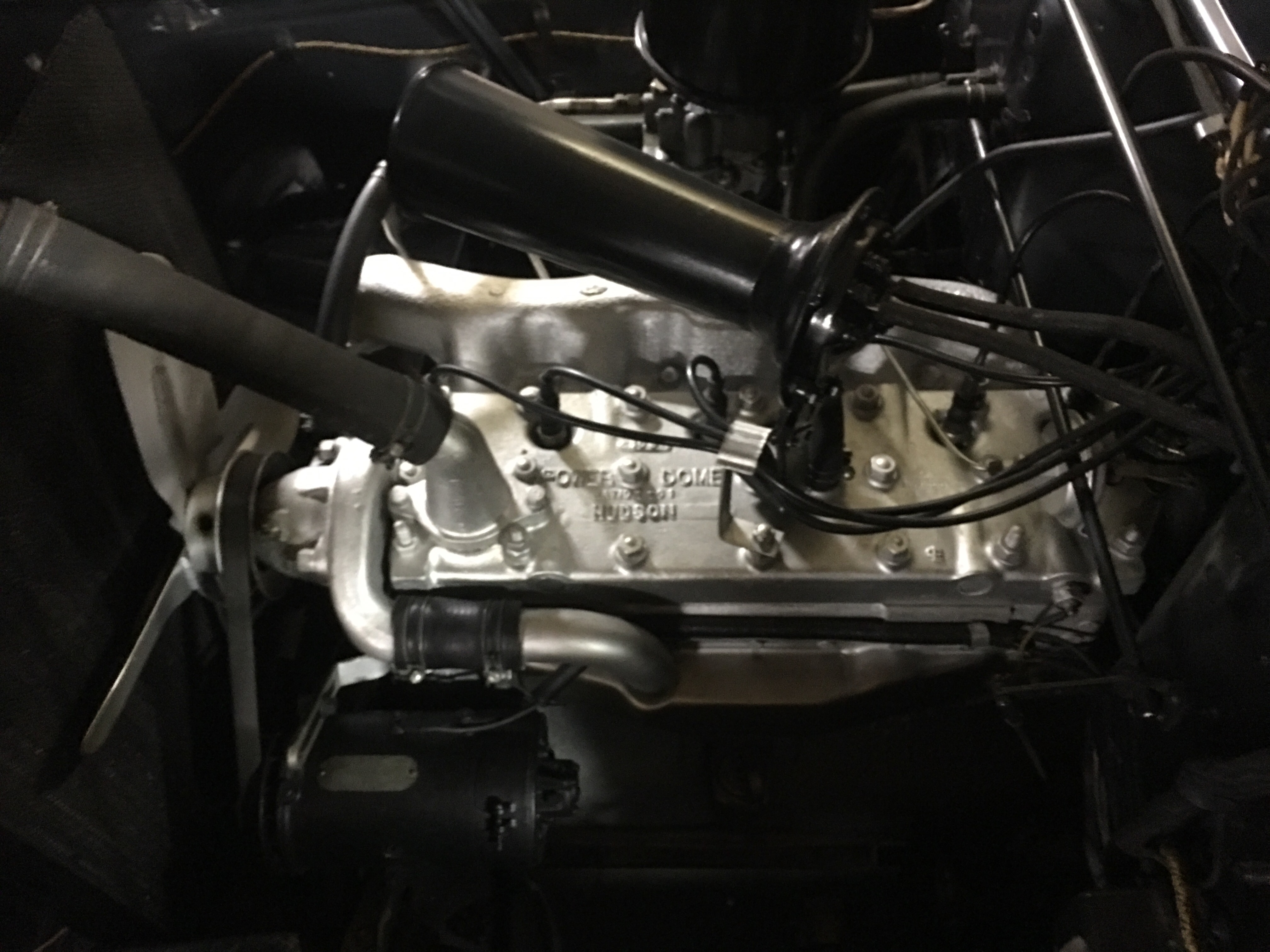

Here is another close-up clip of the top of the engine.
Any idea which size/type this engine is?
It ain't the original one.0 -
That is a head from a short stroke 175 cu in. engine, probably the original for your car.
That would provide a bit more power when used with the 3x5 engine. Foundry mark is from Lakey Foundry and Machine Company , Muskegon, Michigan0 -
The generator bracket is not right,looks like it is at the wrong angle0
I'm not yet that familiar with Hudson's. I will check it.1954Hudson said:The generator bracket is not right,looks like it is at the wrong angle
Thanks a lot for the input.Ric West IN said:That is a head from a short stroke 175 cu in. engine, probably the original for your car.
Is there a source where I might learn more about this?0 -
