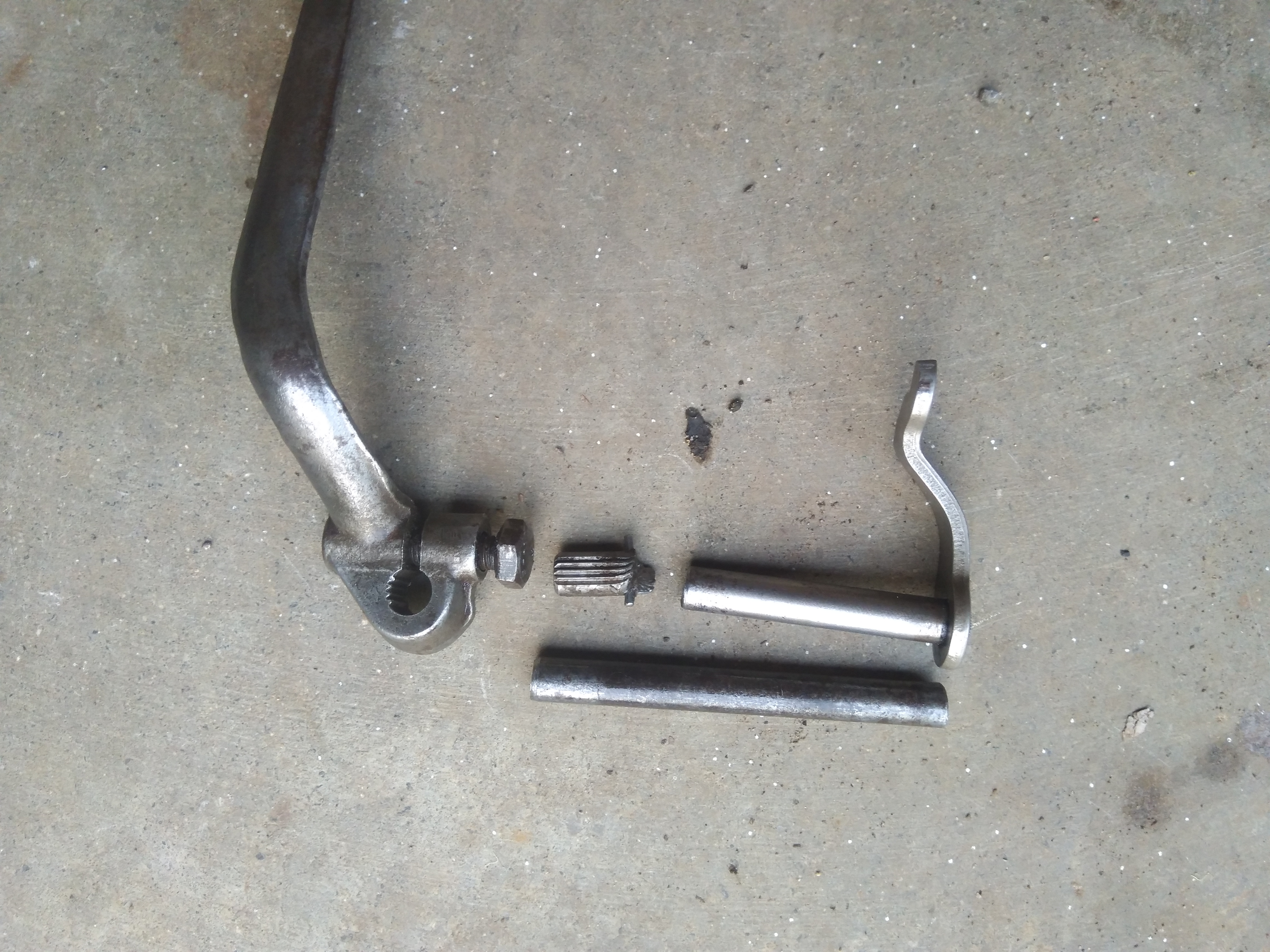

Just got my hornet on the road and the auto won't pick up the high gears oil level is good has low gear and reverse but won't select up into higher gears and hits neutrals when I fitted the engine and box I accidentally broke the throttle shaft off that goes through the centre of the selector shaft so I couldn't hook up ACC to auto is this the problem or is it the adjustments on top of box has anyone driven one with this disconnected any thoughts ??
So you think this will be 100 percent reason I thought it would still shift gears just not properly and yes that's the shaft that broke I will need to find another somewhere0

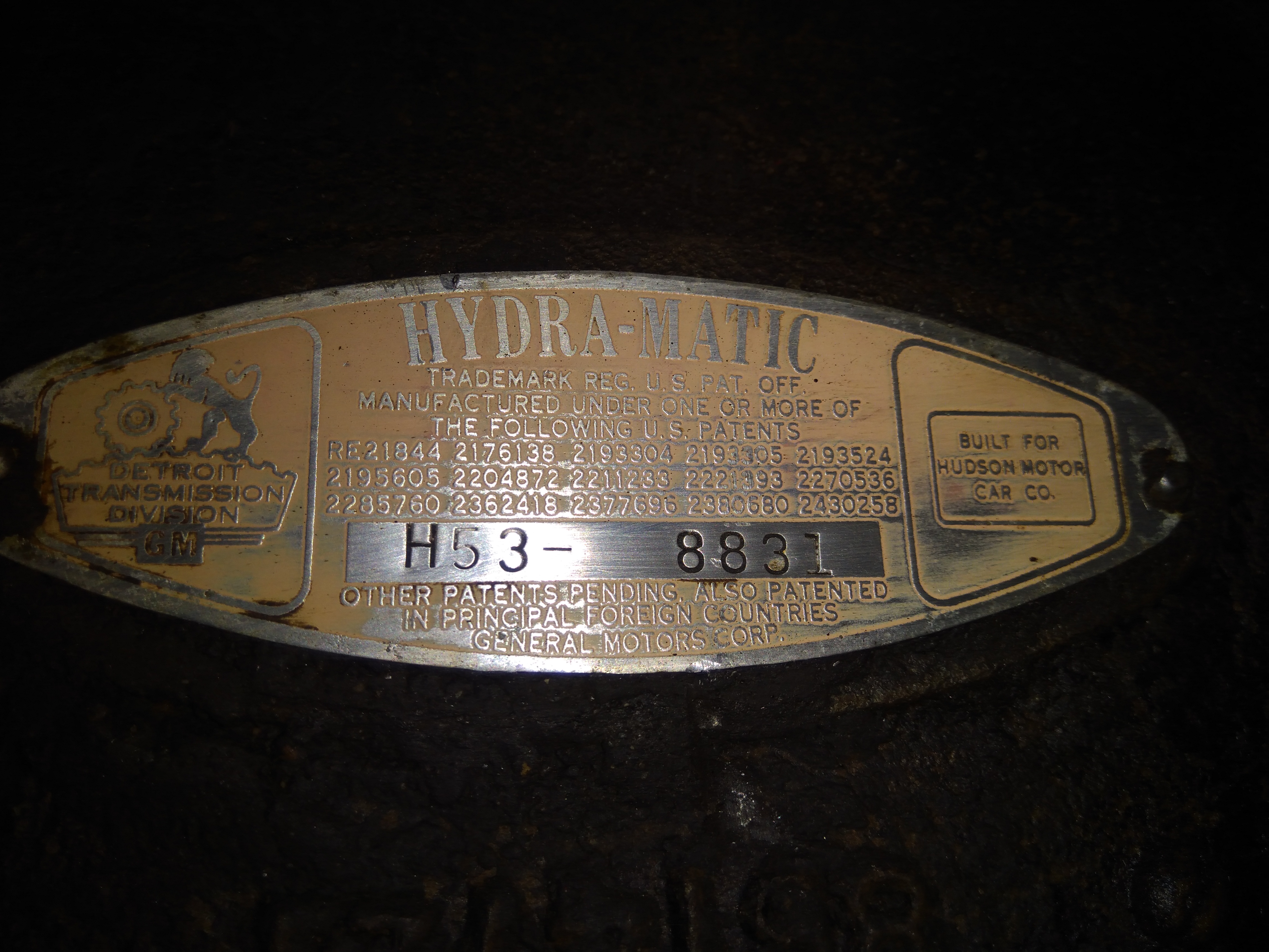

I will check the plate on side of the box cheers ?0
Update pulled pan and sidecover off lots of sludge in bottom pan filter partually blocked checked valve body 2 stuck valves so I have cleaned it all out freed up valves and now I am repairing broken throttle shaft will let you know how I get on ?0
