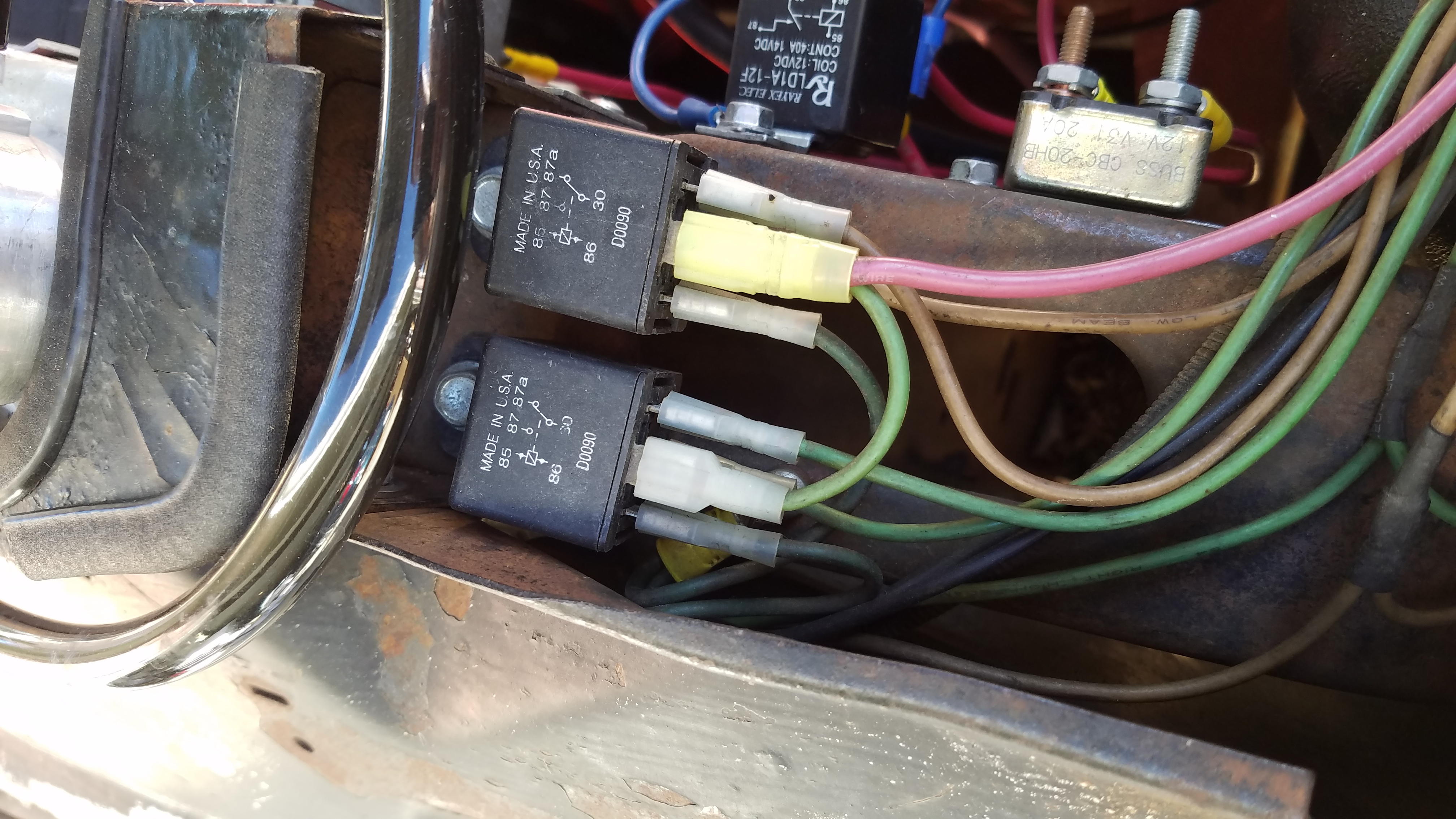

My stepdown location for the headlight relays>>
Here's my installation:
One relay for brights, one for low beams. Power comes directly from the battery (big red wire, spliced over to both relays), relays triggered by the foot switch.0 -
Very Nice Installations!0
