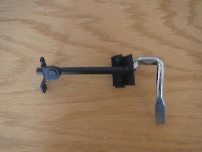

Hey guys – the seat adjustment lever (fore and aft) on my ’53
hornet keeps coming out of the socket, but it does work when it’s in the socket
– it’s getting really old putting it back in! my guess is there is something
that holds the seat lever in place, which is missing, or perhaps my seat lever
is damaged – any advice would be most appreciated – thanks!
After in place; washer and light tension spring on the end and a cotter pin in the hole0
thanks - there is a spring attached to the lever - i do not see where a cotter in would go- where the lever is in the hole, there is no way to access the rear end of that lever (unless a removed the bench seat, and then maybe?)- i think that the end of my lever that goes in the hole maybe broken off- it would be great to see a photo of a stock seat lever!thanks again0
I have been following this thread with hopes it would solve my problem as well. I am thinking my lever is broken as well as it doesnt come out the back side of the seat track. Can someone post a picture of the lever.0
thanks - glad i'm not the only one! (as i thought it was just my bad luck!)if i could get to access to the rear of the mounting hole, i think that i could put in a screw, washer, and perhaps jb weld to keep in place0
