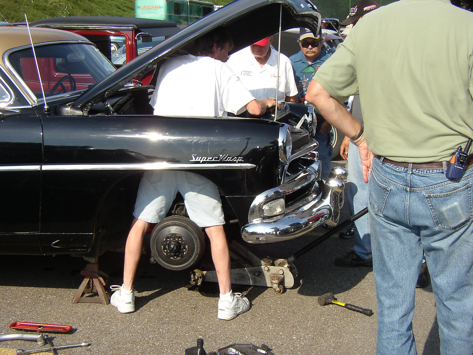

    In 1972 I had a 49 Commodore coupe with a hornet motor. I took off the passenger side inner wheel well and drove it that way. Those valve were adjusted on a regular basis. Why? I was young and dumb! Still dumb but not too young-----

    Removing the inner fender does give you a little more room to work.

    removed mine on my 52 wasp to adjust the valves
