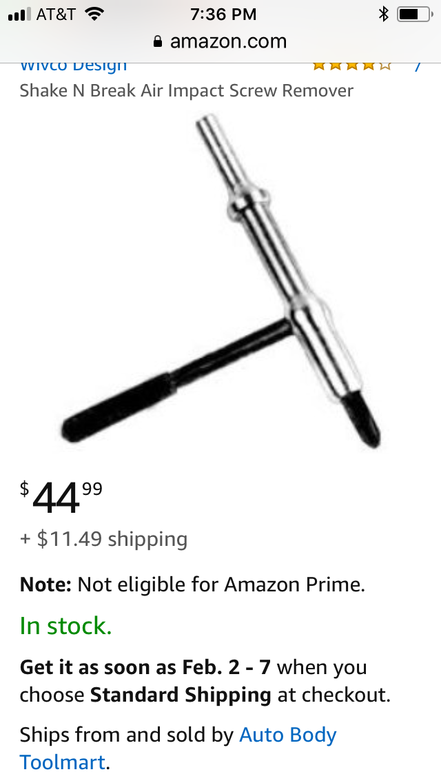

After Rambo suggested the use of the screw shaker I brought one...splendid results!0
Wow thats great Ken. I didn't know they still made them. I guess I should be selling mine for more than $1.50 ea!0
