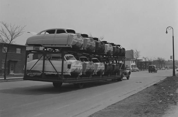

"Correct me if I am wrong. Were not all Hudson convertibles simply broughams pulled of the line and modified into convertibles and not made as common production cars on the line??. "
As far as Step-Downs are concerned, the answer is, "Sort of." The very first few convertibles were indeed, converted coupes, i.e., top was sawn off, header and back deck re-worked and some stiffeners were added. The added pieces varied a little as if some experimentation was in order. Obviously, re-worked panels on the earliest convertibles were a little cruder than a dedicated stamped piece would be.
Once the initial learning curve was completed, new dies were made for the convertible header, back deck and well wall. Additionally, a 'Z'-brace was installed inside of the outer perimeter frame to reduce the flex (front to rear) found in a typical convertible.
It is my contention that initially, convertibles were made on the line, with the rest of the bodies at the body plant, down the road from the Main Plant. At least in so much as creating the basic shell, i.e., frame, body components. Then the doors and trunk lid were fitted and attached to the car. After the initial shell was welded together, it remained on the line long enough for the body in white to receive primer and paint in the paint booth.
The painted shell was then moved from the line and into the Convertible Room, where the next phase was completed by hand, one car at a time, although, probably the room was large enough to outfit at least several convertibles. What was done here was the rest of the convertible-specific items, like the top mechanism, pump, switch, hydraulic lines, windows, including windshields, the top wiring harness, at least some of the interior, but probably not the front seat. The convertible top was also attached. This would be the logical place to test the top mechanism, do all of the adjustments (which are many) and adjust the side windows.
After this phase, the body was loaded onto a body trailer along with other closed body shells and trucked down to the Main Plant. Here, the convertible body would return to the line to be outfitted with running gear, suspension, wiring harness, doghouse, exterior trim and the remaining interior items (like front seat, carpet maybe), wheels and tires.
Many years ago now, Life Magazine released some Hudson related pictures that answered so many of these questions. Note convertible on bottom row at the rear of the trailer.
This has all been gone over before, but some of the newer forum members might not be familiar with it.
Cool picture and interesting history.0
