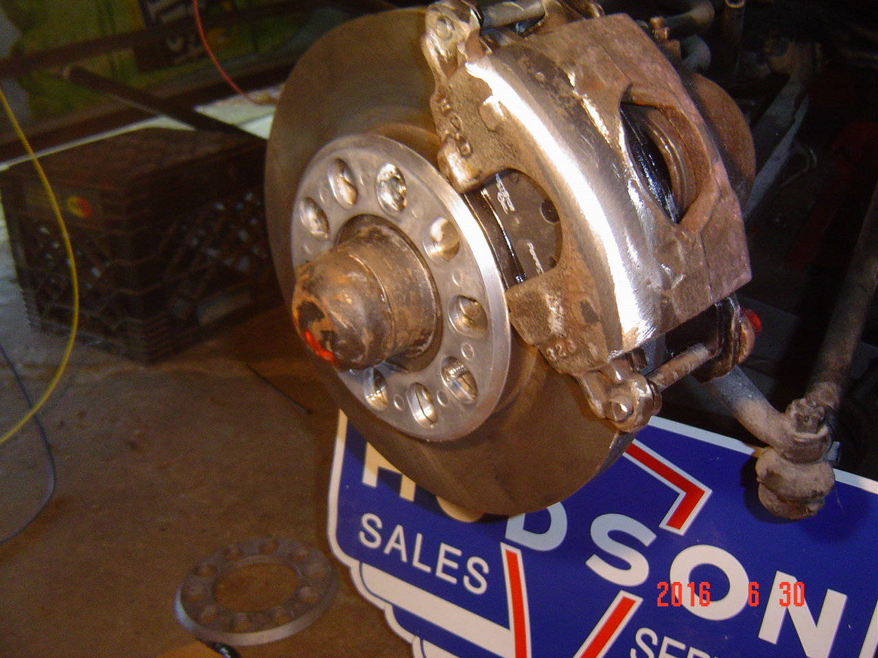

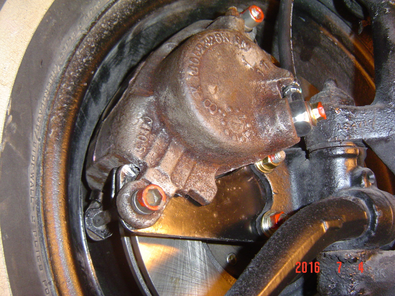

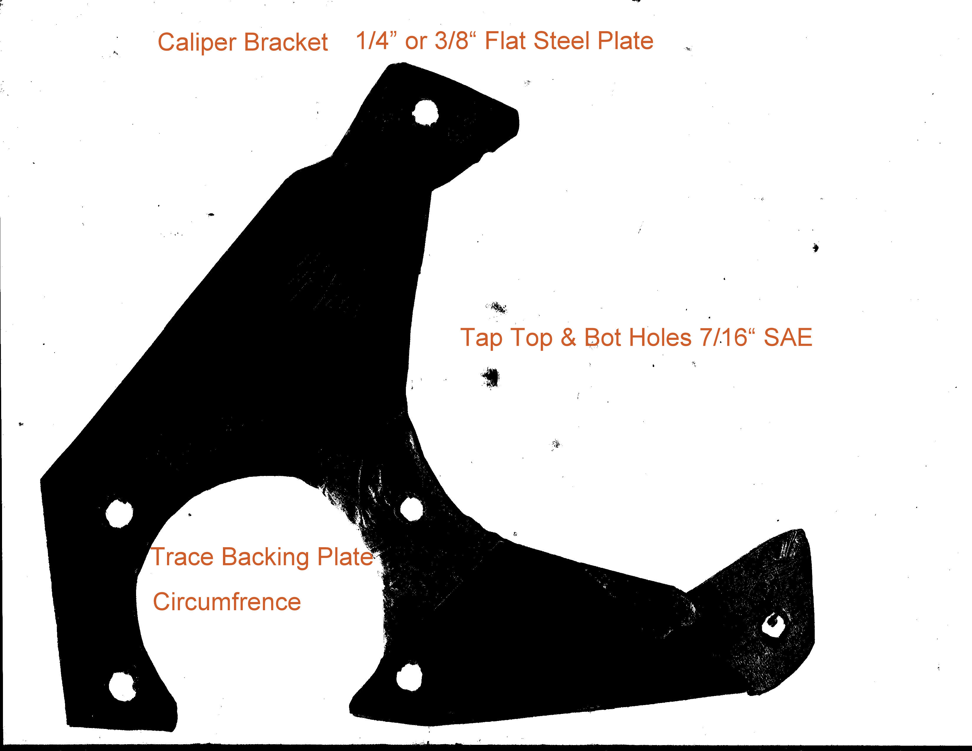

    More recently I made my own Disc Set Up using 01-04 Chry Sebring Rotors (#RTR 76921) by machining the ID slightly (.120)  to fit the Hudson Hubs, then installed '70's Camaro Calipers, Pads, and Hoses. I fabricated the Cailiper Bracket from 3/8 mild steel plate in my garage. I Posted all my conversions earlier and a few members have copied the Disc Brkt diagram to have Bracket Machined.
     I used Grade 8 Bolts thru the back side hubs by drilling out threads slightly then used a spacer to clear 'my' wheels. However 610 289 Dorman Studs are available if dont want bolts. I ground off the caliper body just slightly to clear Hudson rim, but with spacer was unnecessary.
     If interested in duplicating I would send a copy of the bracket. It was a very simple conversion and works very well..

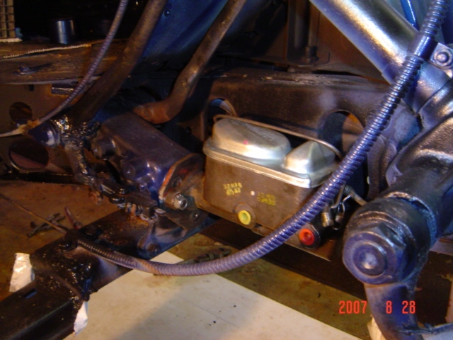

    I mounted the Torino Dual Master Cyl under the floor right onto the pedal Assy bracket where I removed the Hudson M/cyl...Using the Torino & Hudson M/Cyl's as a pattern, I cut a 1/4" triangle Plate wide enough to mount the Torino M/Cyl then drilled it to install 3 'button' bolts onto the pedal bracket. I also hole sawed the center of the plate for the push rod. I counter sunk 2 Button Bolts bolts forward to mount the wider Torino M/Cyl. It was simple to fabricate.
    I had to shorten & re thread the Torino push rod (that came with the M/cyl) to except the Hudson Yoke, then adjusted Pedal free play. All the original Secondary Braking System Linkage was retained. The only drawback is filling the Master Cyl but after bleeding I havent needed to refill in years. However, a plastic Remote Fill can be bought cheaply to mount higher on firewall if desired. A couple of Forum members duplicated the Adapter later but I tried to find the pictures I Posted previously but couldnt locate tonight.

    The Ford Torino Dual M/Cyl that I installed was a 4 wheel Drum Brake car, just prior to Disc/Drum brakes, probably '67 or '68. Install was about 8 yrs ago and I would need to look thru some old files for part number. It was in Stock item at Auto Store.
    I Posted a few pictures back at the time but can only find one pic now attached below. It was a real simple conversion using a piece of steel plate, hacksaw, hand drill, and like I said, all the Secondary System was retained, (but no longer necessary). I used beveled 5/16 bolts so flush to mate the adapter plate onto the Hudson pedal assy, then the Torino bolted along side facing forward. A cardboard pattern can be traced using both M/Cyl's. Additionally, NO residual vaves were necessary.I ran the large Chamber to front and small chamber to rear brakes.....
