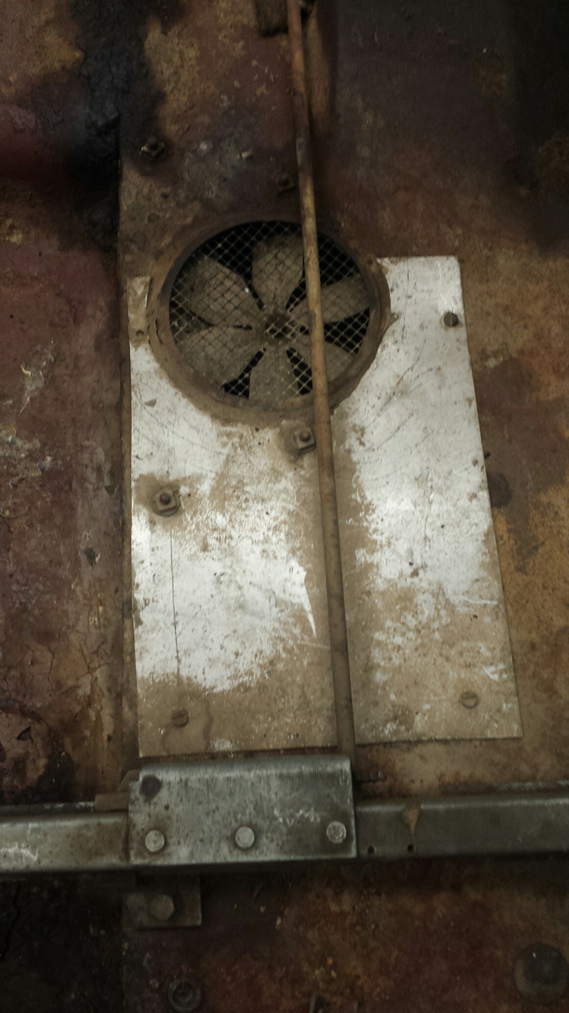

  • bjgundbjgund Member
    Posts: 34
    Finally got around to removing the front seat from my Hornet and get a full view of the underseat heater.  See pic attached. Problem is I don't see a control switch anywhere to control the unit like the one pictured in the post in the link shared by onerare39 above.  If anyone has a complete unit with the correct Hudson part # as depicted in the link, I would be interested in it?  Thanks and happy holidays.

  • Oldfarmer1947gmailcomOldfarmer1947gmailcom Expert Adviser
    Posts: 1,555
    Bob, some of the installations use a dual switch which control the water valve and the electrical motor control is hooked to both blower installations. Perhaps yours was installed as described.

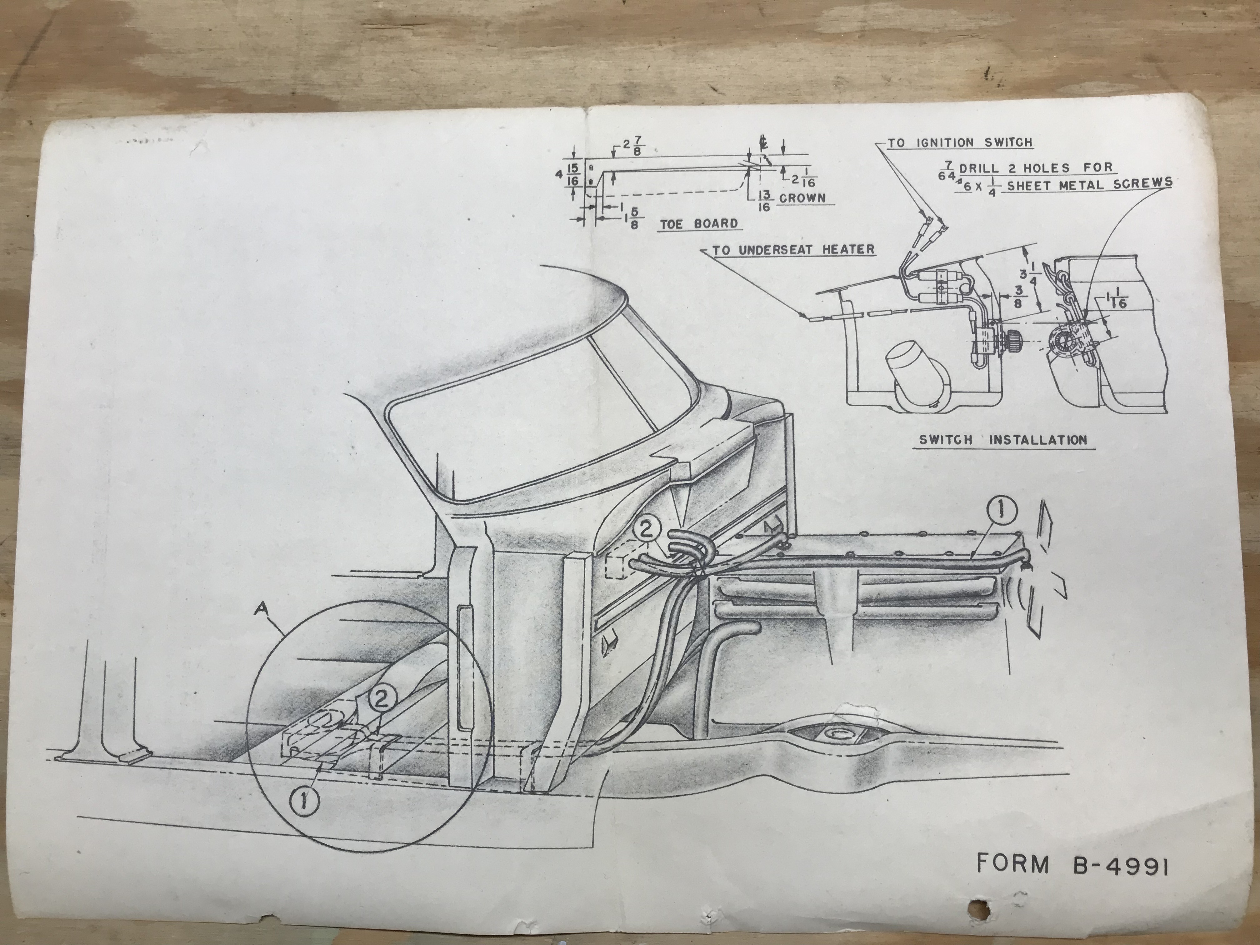

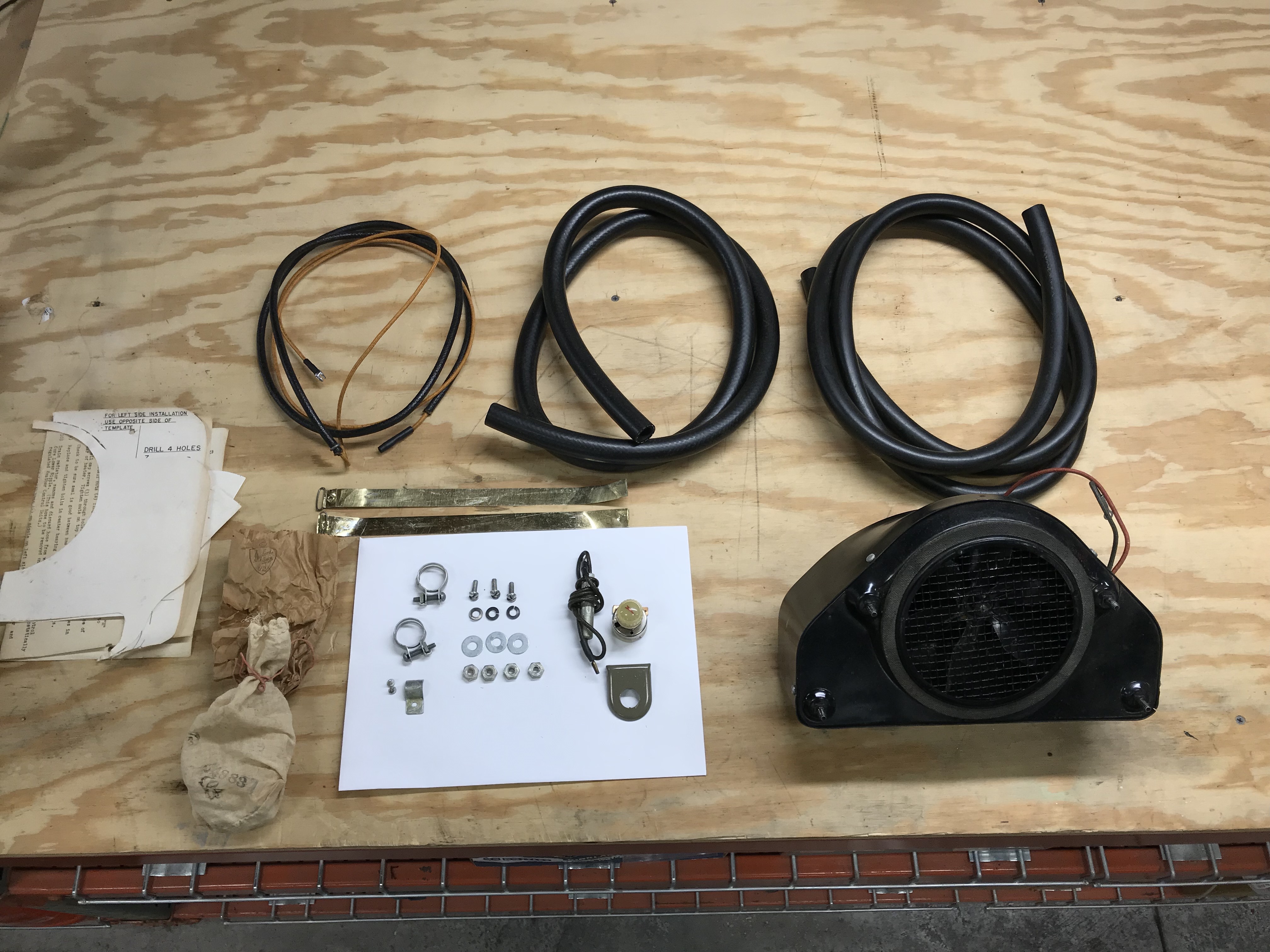

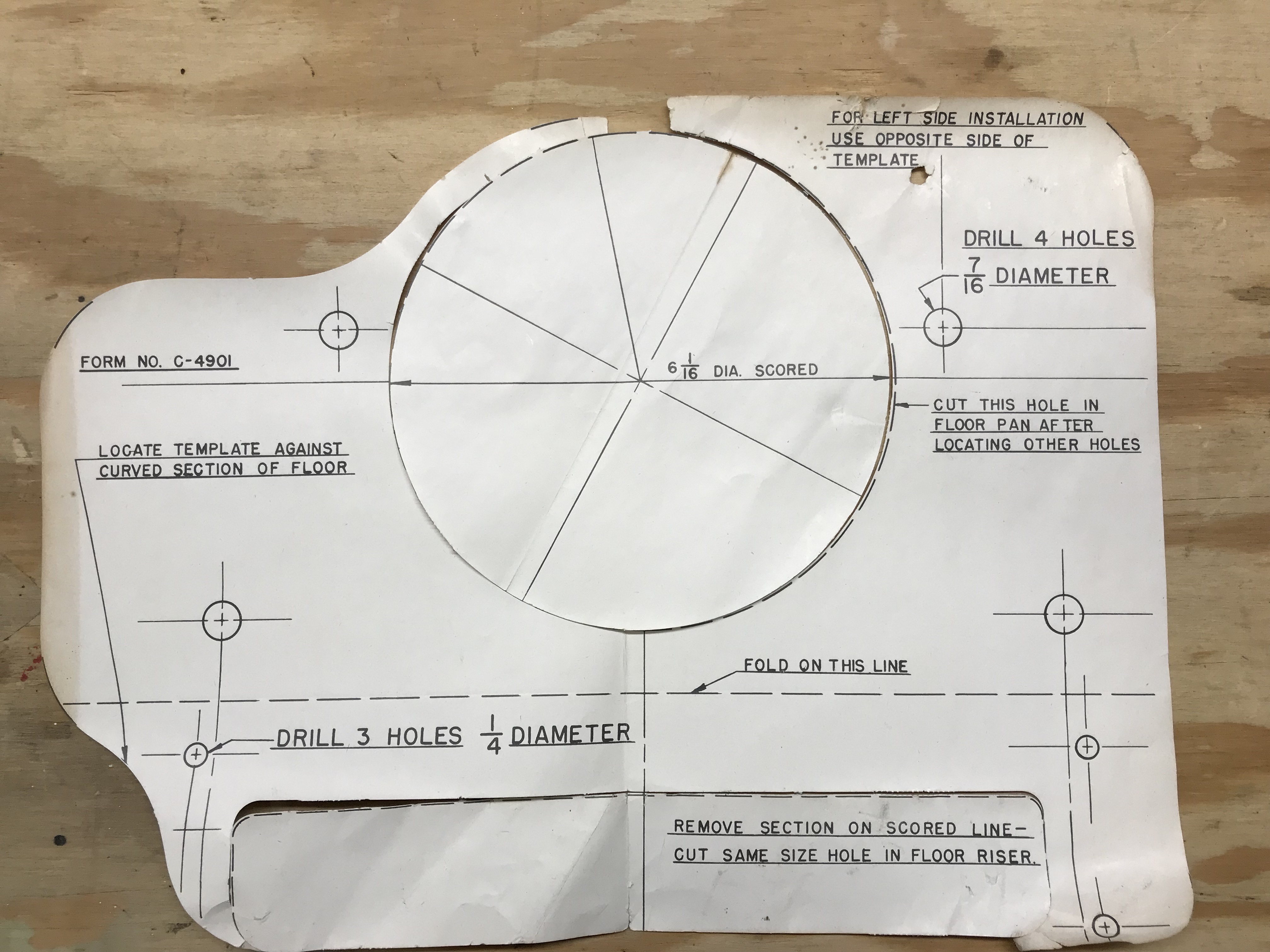

  • onerare39onerare39 Expert Adviser, Moderator
    Posts: 973
    Bob,
    Here are some photos of my underseat heater kit.  I will send them to you via email also.
