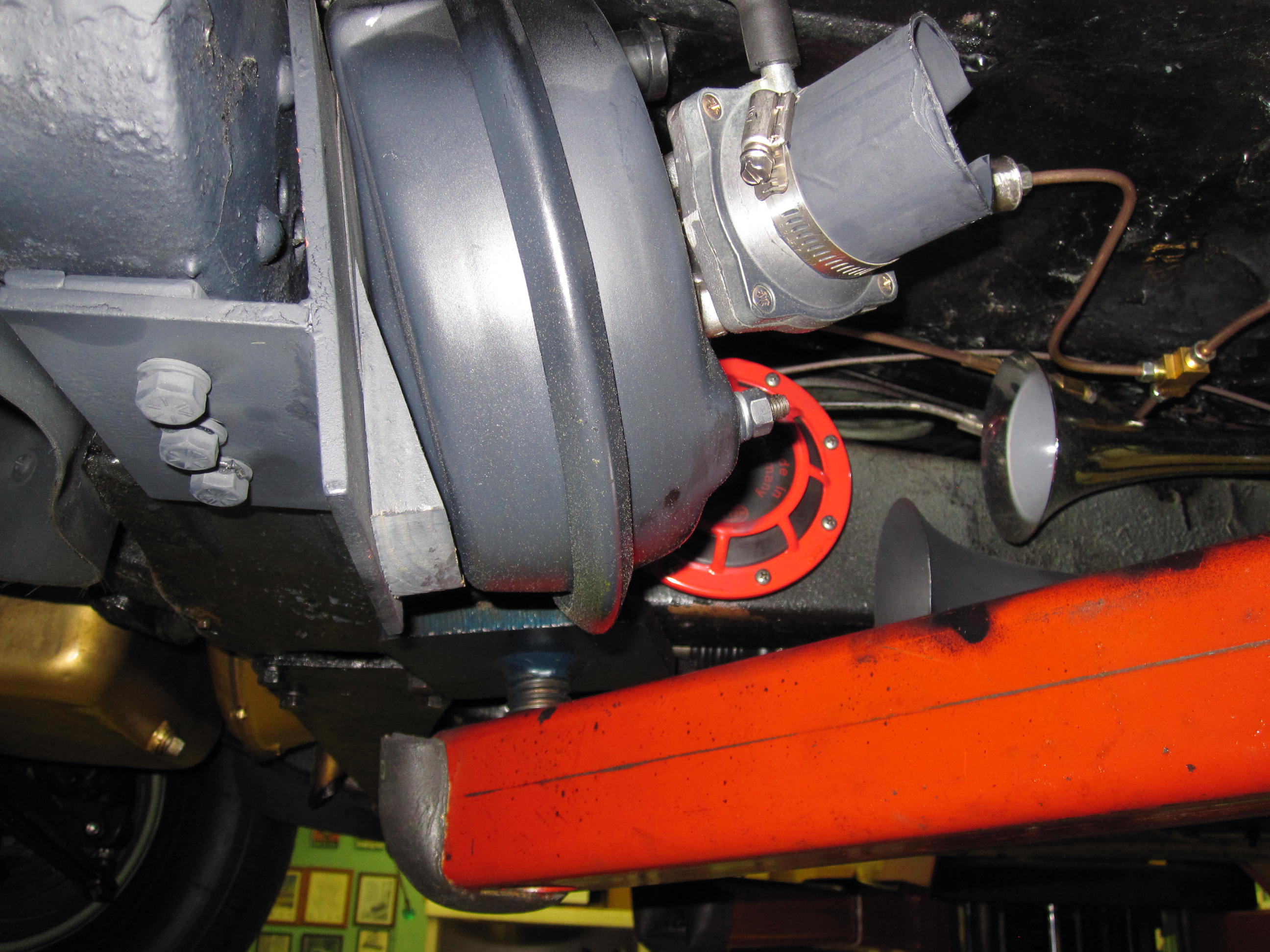

My power brake unit, located underfloor, supplements the front disks for extra stopping power (operating on all 4 wheels !) Only connections are brake line from MC, brake line from booster to main brake line distribution fitting and vacuum hose to intake manifold. Does not use actuator rod. Click ( i ) on 1st photo to get comments.
This is for general info only, not as recommendation per se.0 -

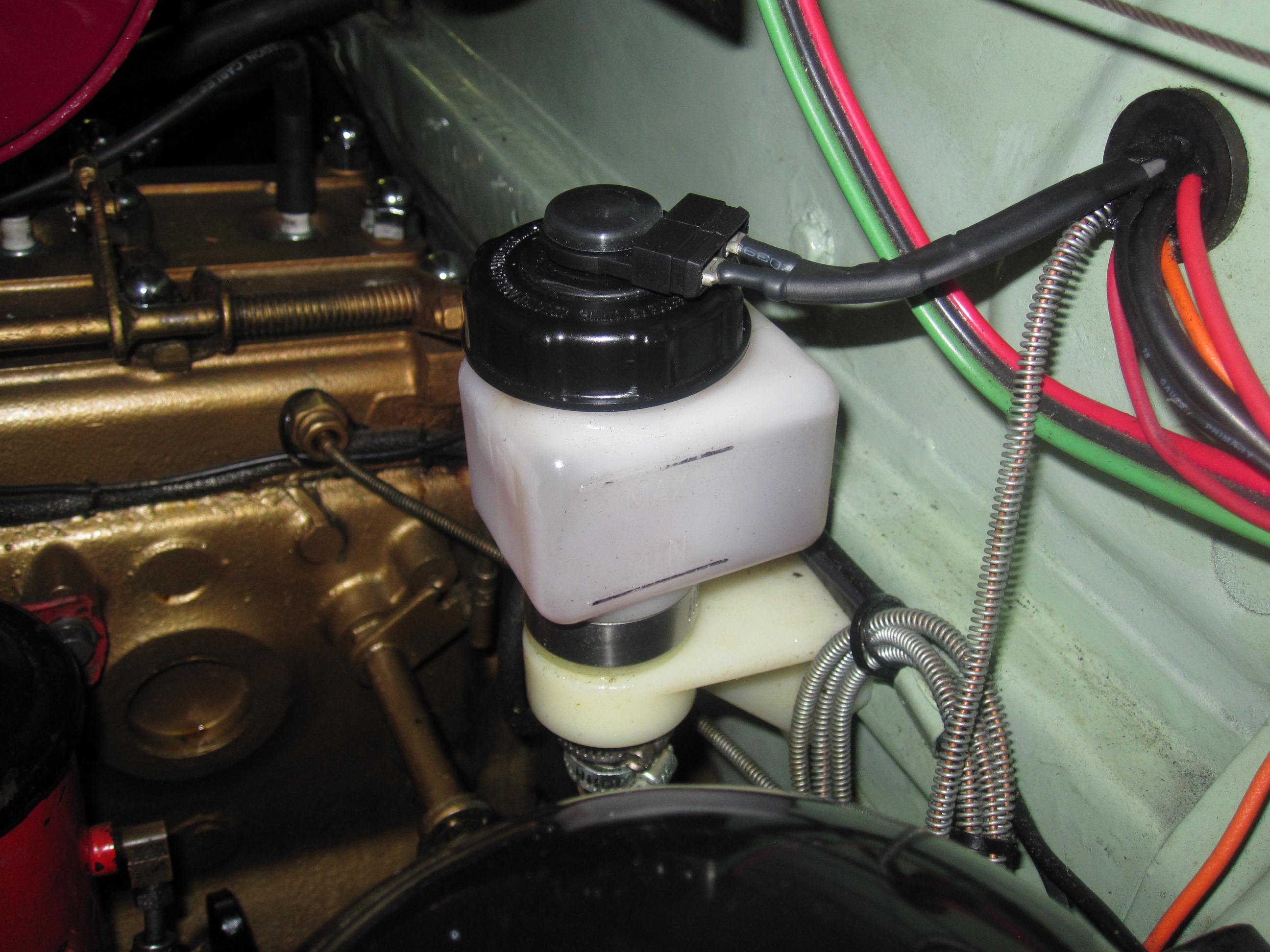

If you use a remote fluid reservoir with a low-level blinking red light on dash, your losing fluid without knowing it is rather unusual. Plus, you have almost double the quantity of fluid. Mine shown here with wires going to light on dash.
Another thing, stepdowns have the 'automatic' emergency brake as last resort in low fluid situations.
Point: Why go to the trouble of a dual MC?
{coiled 'wire' is for aftermarket capillary temperature sensor.}

Kerry, the remote is connected to the stock MC. And easy to add fluid, plus the low level alarm, and double the amount of fluid. Could put on the upper inner fender and paint black(use DOT 5) to be more stealthy.
