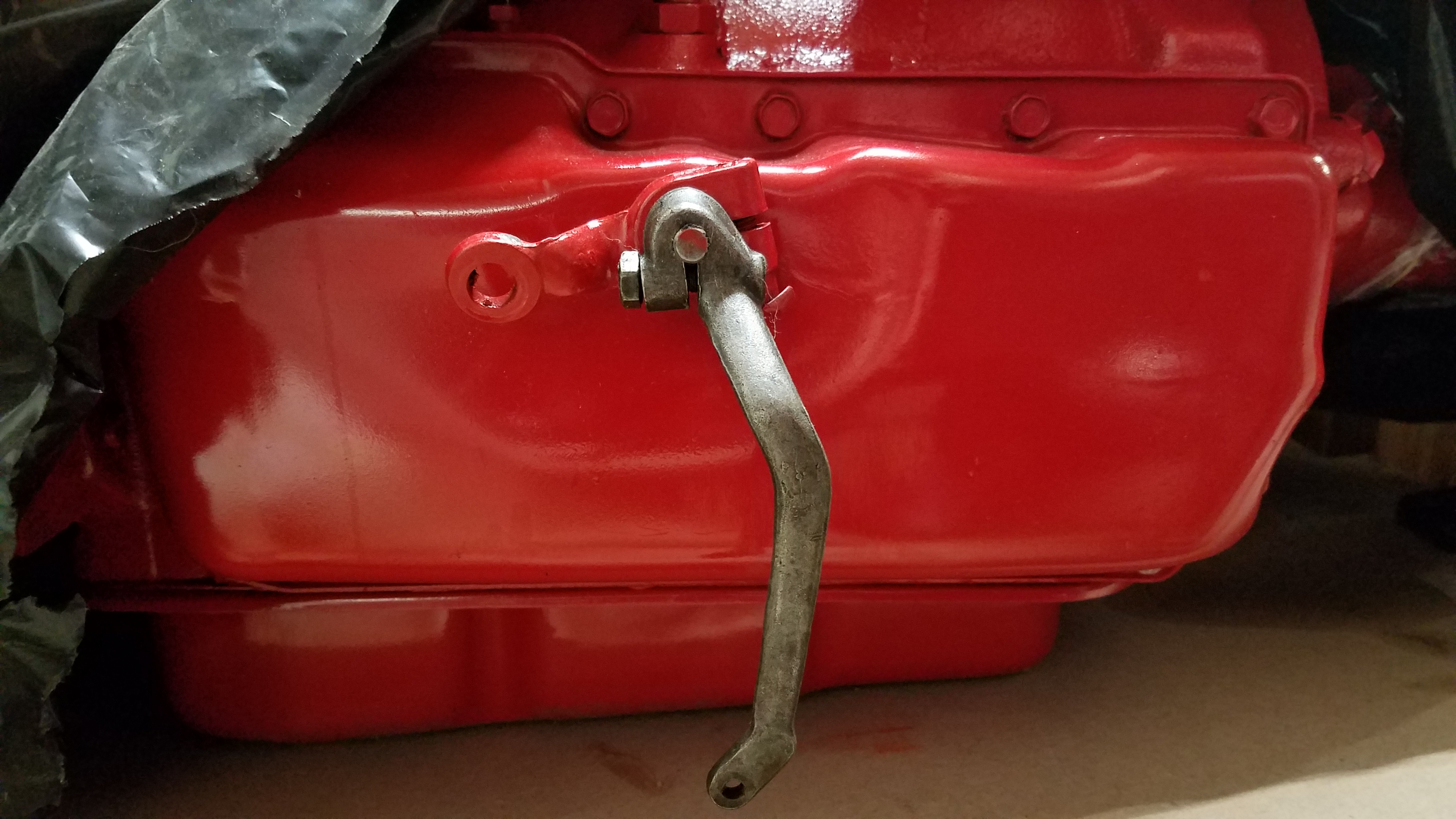

When I pulled the engine and hydramatic tranny out of our 54 hornet i must have grabbed the lever that is swedged to thinge inside of side pan. the tranny is j or h54 number on side. What I want to know is there an other year of hydramatic that will fit our tranny. Ray
You can weld or pin the two pieces back together. I had to do that on my H52. Pulling the Hydro valve body and disassembling it is not too bad. I have a H51 valve body from a trashed Hydro you're welcome too, but I'm not sure it's a direct swap. Single vs Dual range Hydramatics.0
my h54 pieces were welded but do not know if in the right place but have no spring tension when moving lever Ray
In either direction? T-Valve could be stuck in its bore. Picture is of the throttle rod in its neutral position, spring should act as it rotates ~10° clockwise. It's been awhile since I've had mine in-car, so anyone out there let me know if I'm wrong.
no spring tension either way. Thanks for the help.
