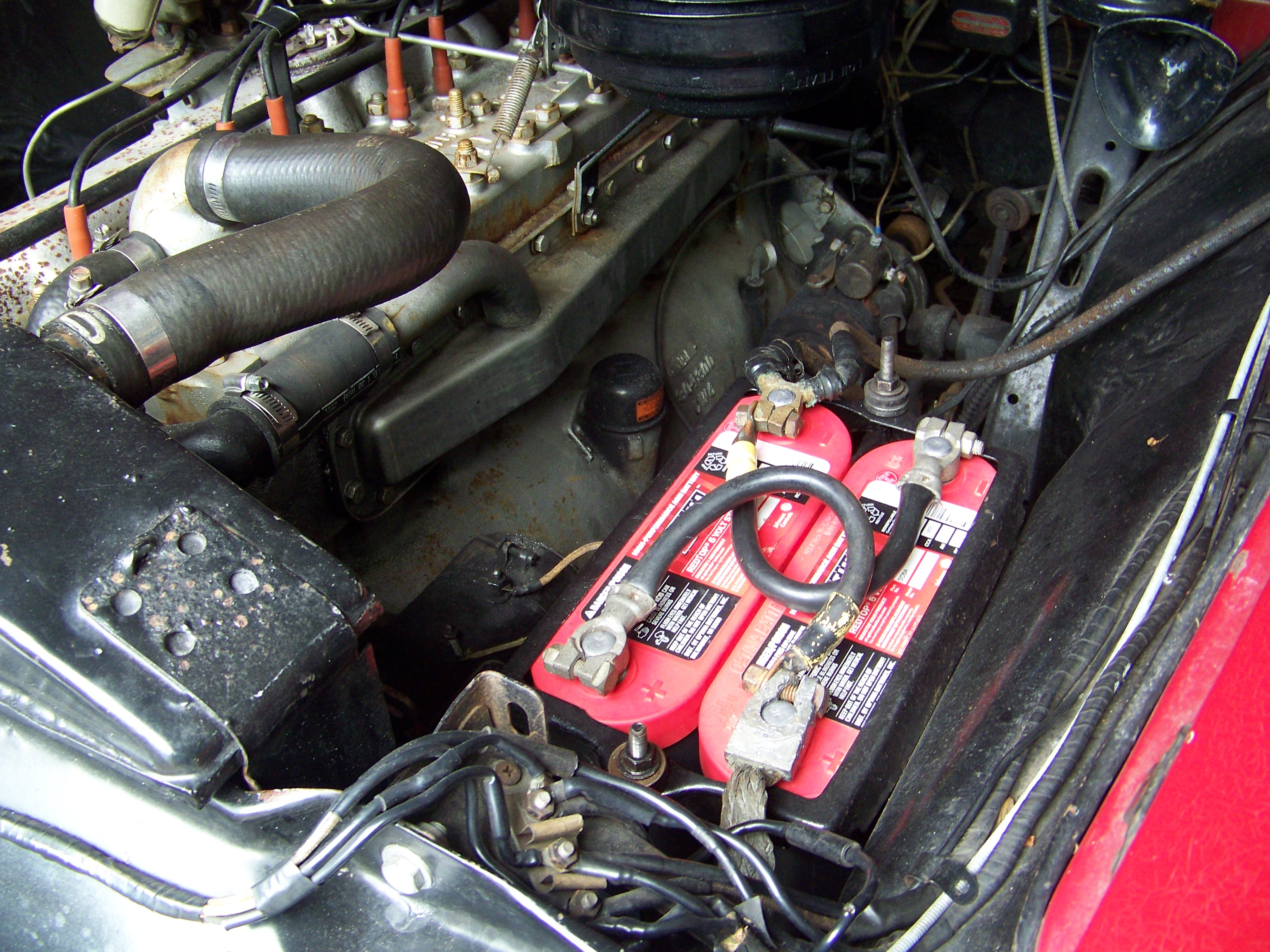

I recently had a slow starter problem on my 49 8. After re-doing everything including two red top Optimas in parallel.. Found the battery disconnect switch that was on the car when I bought it...was resistive. Removed the switch... No more slow cranks even when hot.0

SuperDave: Red Top Optima, is that the best one over the yellow?
Heck I dont know! I have a Hudson buddy show me what he did,so i copied it. Probably could have just used one! Got mine off Amazon.0

I also did what Super Dave did to my 36T.
Got 2 red top Optima's in parallel, made sure everything was shiny bright and tight (connections), and used 1 gauge cable for all connections, including the ground (pos) from bat to starter bolt. Then braided straps to frame etc.
Starts great even when hot!

I have a single Optima Red Top in my '54 Hornet - we made a new hold-down bracket & it sets there pretty proud looking. Get a lot of questions about it at cruise-ins. Plenty of battery for the job. Have had it now about four years and seems to be doing well.
