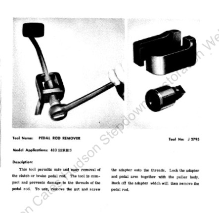

Tool for brake pedal removal can be seen at Ken Cates webslite.

For users of my webpage, No Links- it keeps my server fast. You can download most of the info or use screen shot to create a picture to use/share. The attachment is a screen shot done with my phone.0
got it off thanks used a puller and the shaft has splines that is why i could not get it to turn some to lossen thanks0
