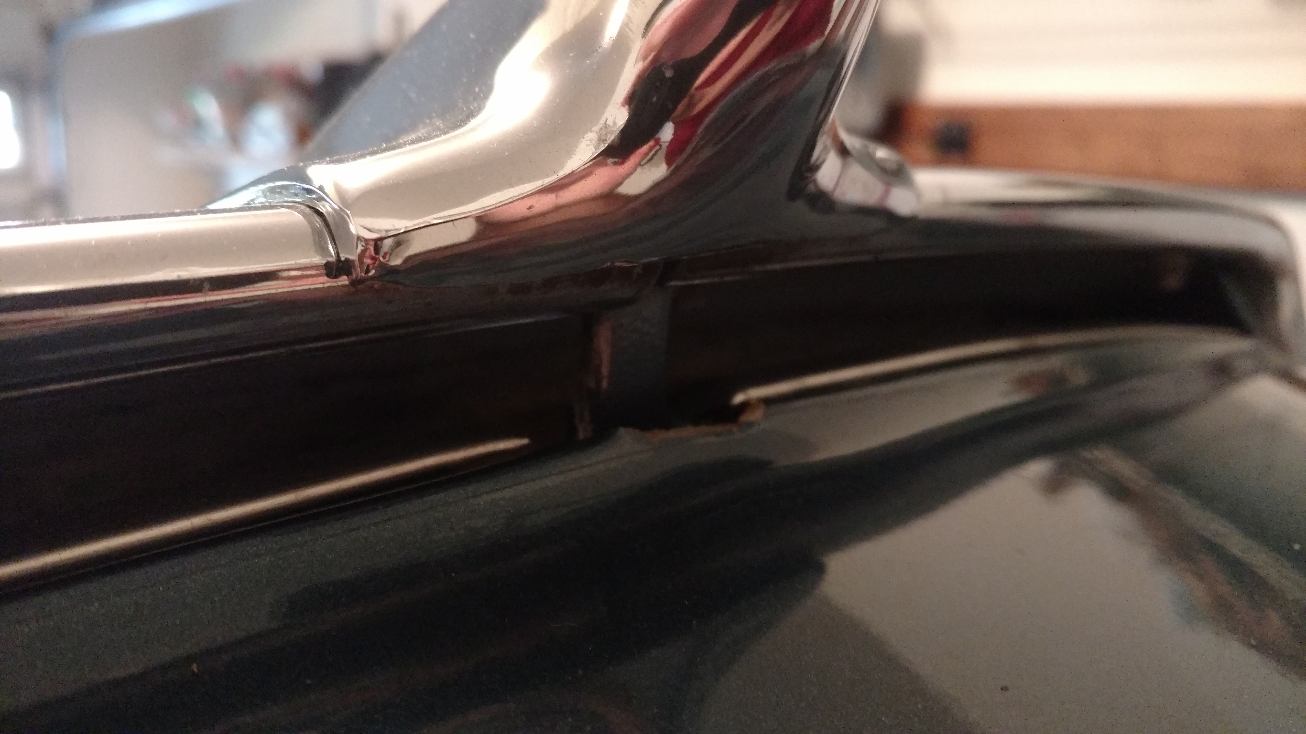

Jetman is correct. Years of my uncle slamming the hood shut by the hood ornament has caused the small strip of sheet metal between the 2 vents under the ornament to sever. For what it's worth, I try to close the hood by gripping the area to either side of the ornament to prevent further damage.0

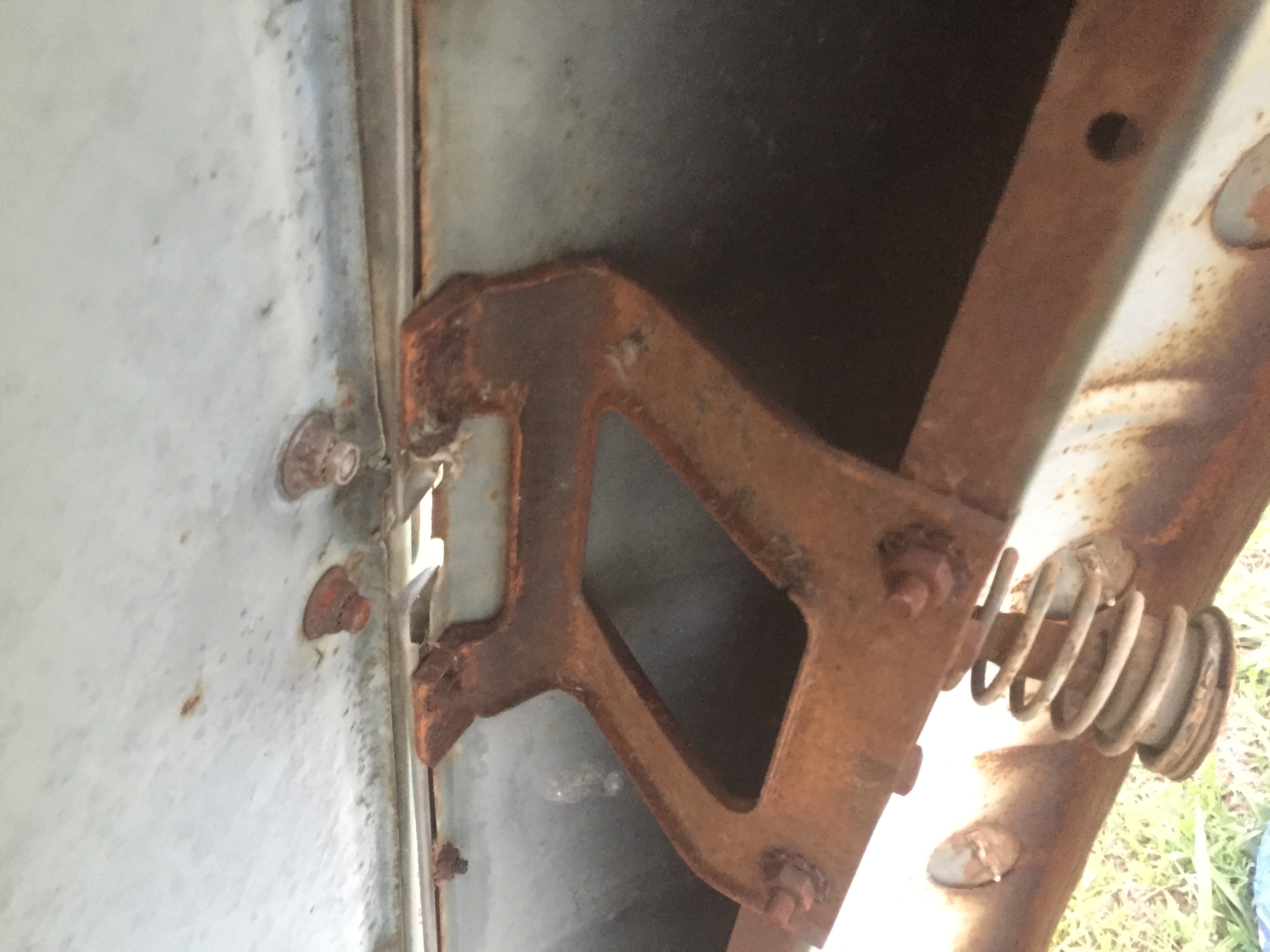

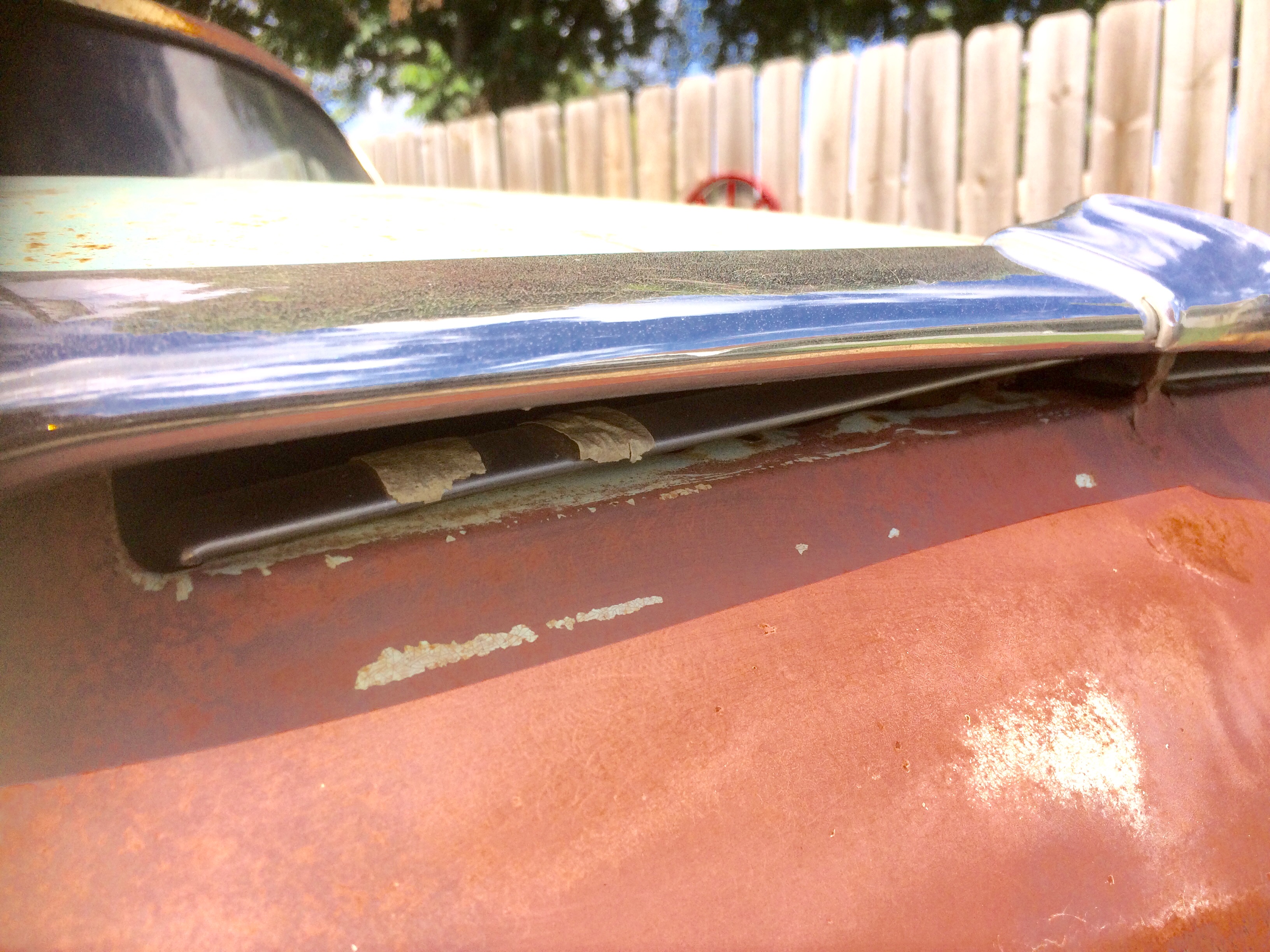

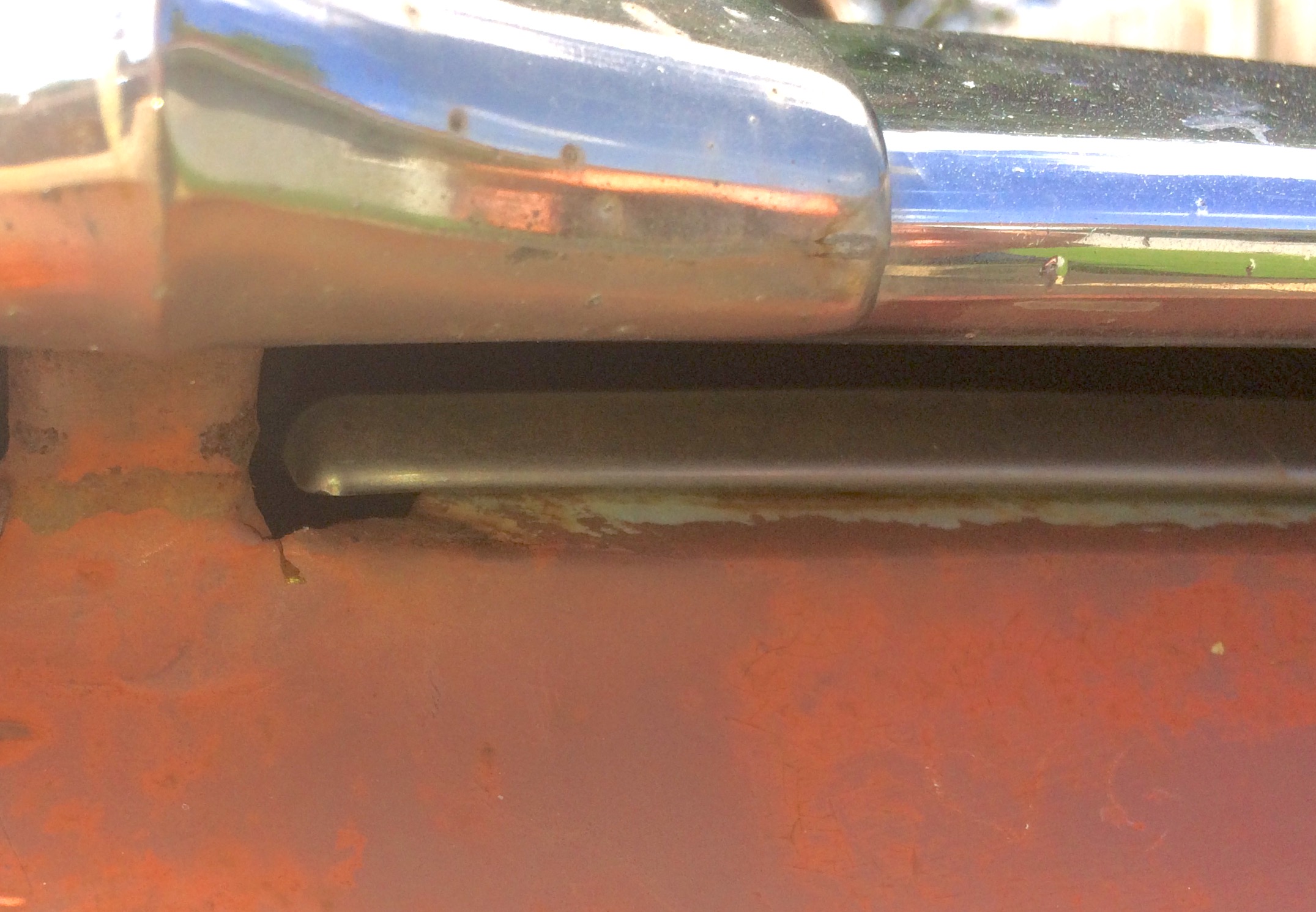

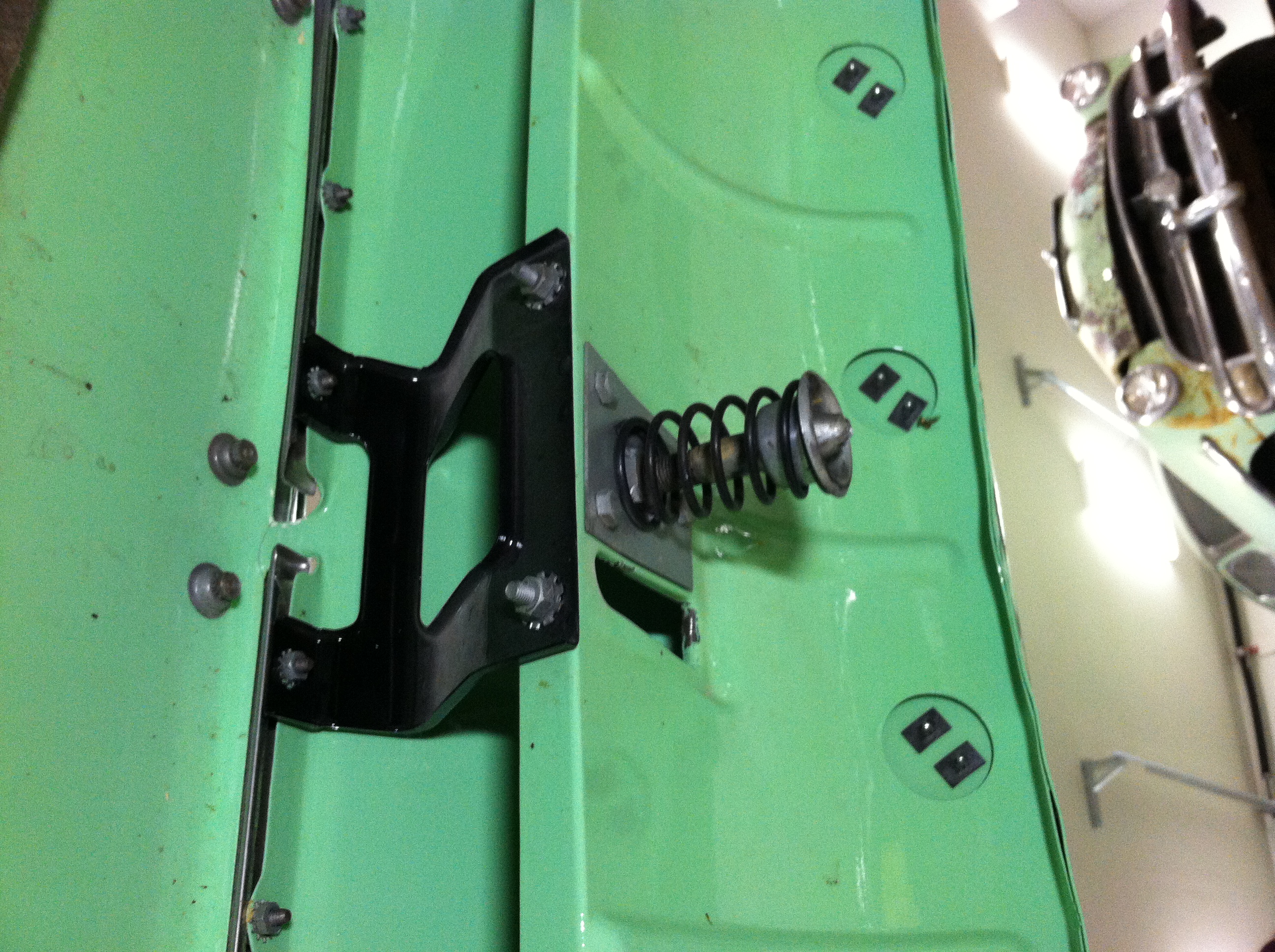

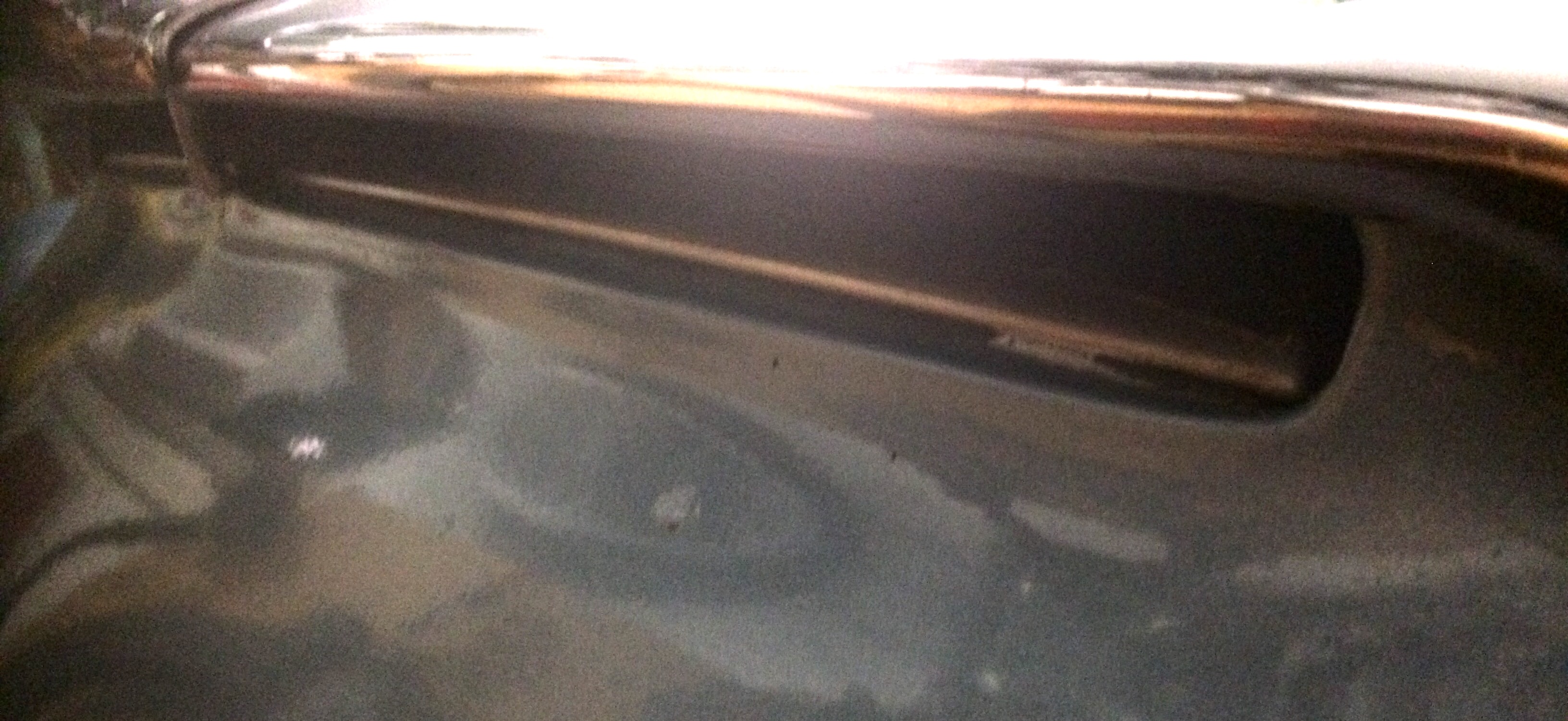

I have attached pictures(albeit) poor taken a few minutes ago. I have 2 54s which do have the stainless moldings bolted to the bottom of the opening. The red primer pictures show both sides as well as a re-welded divider that often breaks due to hood slamming.0
Old farmer that is it halilulia. now to find them.My friend in California told me about this trim.Is it not to common or nobody knows about this trim. Would you sell them off one of your cars.??? Hudsonly Ray
Yes I also need the black support. Do you know where I can buy these pieces. Ray
John, you Collected another 54? I see in the background of your bracket picture.
Oldfarmer1947gmailcom said:John, you Collected another 54? I see in the background of your bracket picture.0
When I had my hood apart I welded in reinforcements to give strength to the hood. My "strips" were in place and in excellent condition.0

Was this extra trim and support bracket an aftermarket thing? My 54 was one of the last made, and to my knowledge, does not have these. I'll have to check tonight.
EDIT: Looks like I do have the trim pieces, but I dunno about that bracket...0 -
Duncan, In short, no. My hood was in great shape except where the center support was. The lower part of the support was broken in half and the hood pushed down a bit. I cut it just below the curve on the top and it was broken just above the curve on the bottom. I fabricated a thick section of metal the right length and welded it back into place-feathering it back at the top and bottom and filed it so that it matched the original contour. If you rub your hand across it, or feel the thickness you can tell it was replaced but (because of my fantastic work--kiddin) it does not show up on a photograph. Sorry--but an easy fix.
Iceblade, My 54 Hornet Special Coup was a Mid-September build. If any of them would not have had the stainless ribs in the hood opening it would have been the "Specials." Since mine has them, I am guessing they all did?

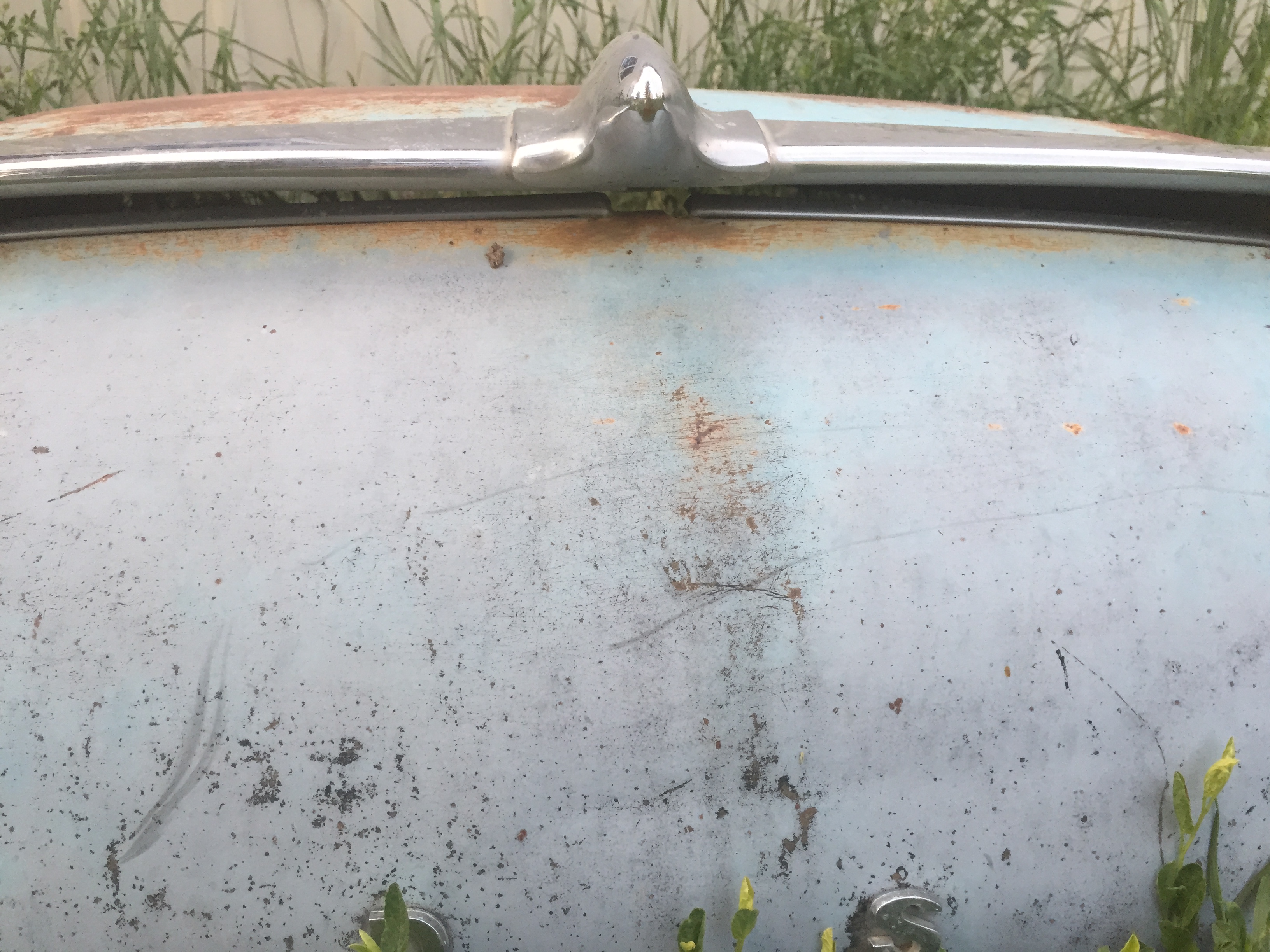

Here's a pic of my poor baby... Makes me sad every time I see it. I don't think there's any way to fix it without repainting the area, eh? I think the incorrect springs are on my hood latch, which means it takes a lot of force to slam the hood shut, which resulted in this happening.
I also did have that bracket other people have mentioned. I never noticed before!0 -
Very interesting thread which peaked my curiosity about our '54 Hornet. Well guess what I found? Our car also lacks the support bracket. So I would also like to purchase one if someone has one to spare. Thanks.
