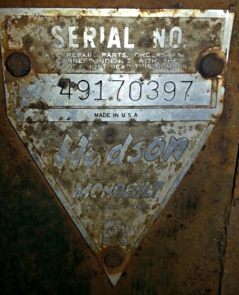

Serial 49170397.
The first 3 digits"491" denotes a 1949 Super 6.

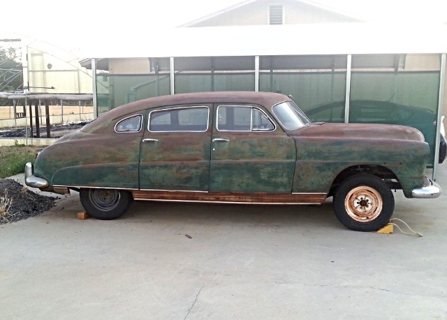

Tipjar, Can you post a picture of your car? That serial number you posted is on the Title as well as the right hand pillar of the car?0

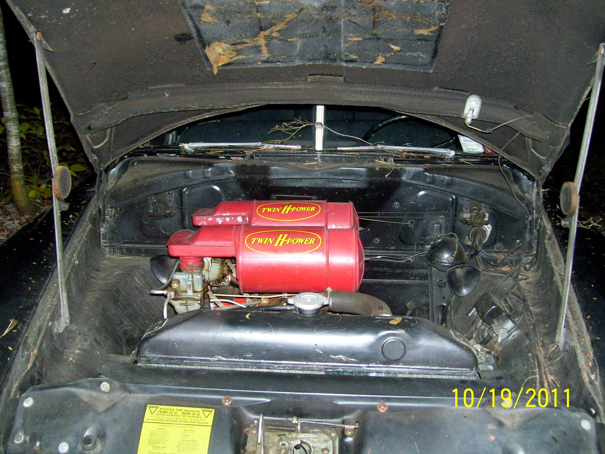

Someone will correct me if I am wrong, but I think the SWB cars have a different firewall.0
Yes, the engine is recessed back under the firewall of the s.w.b. cars.

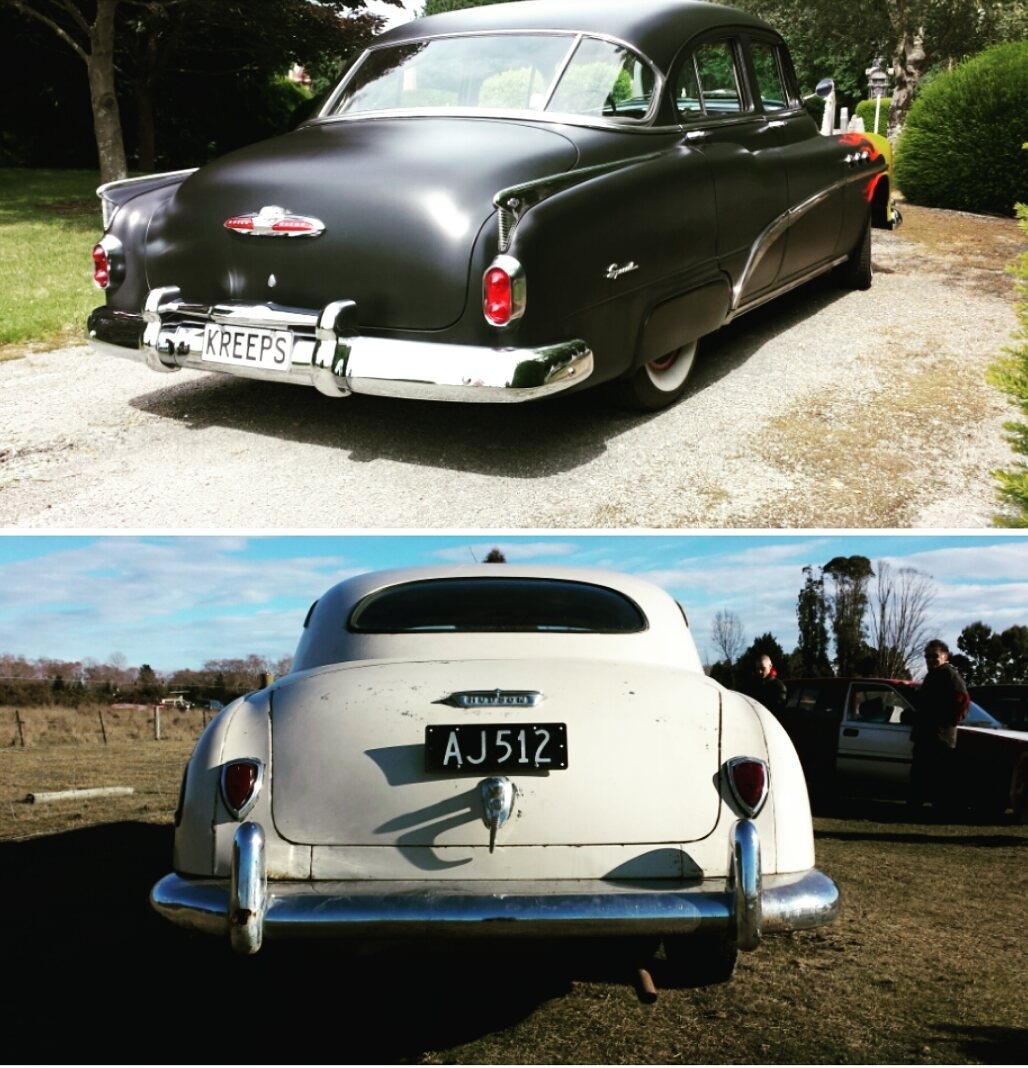

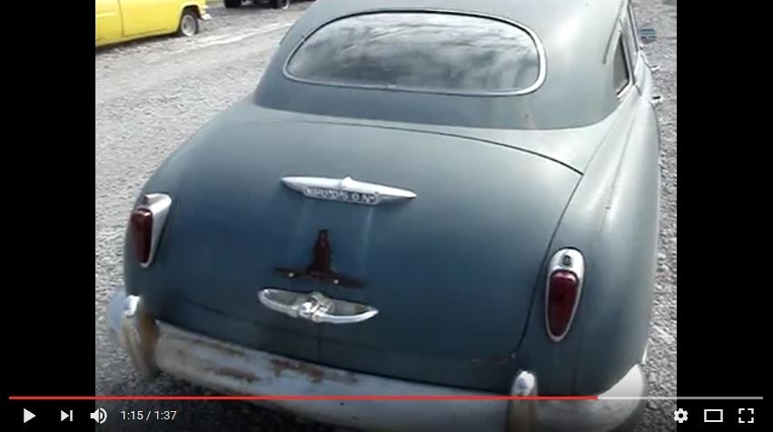

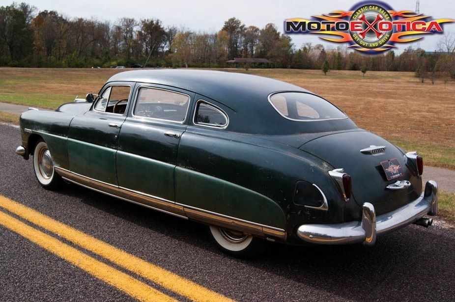

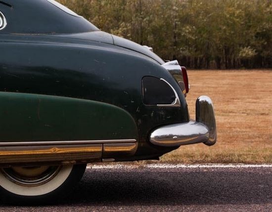

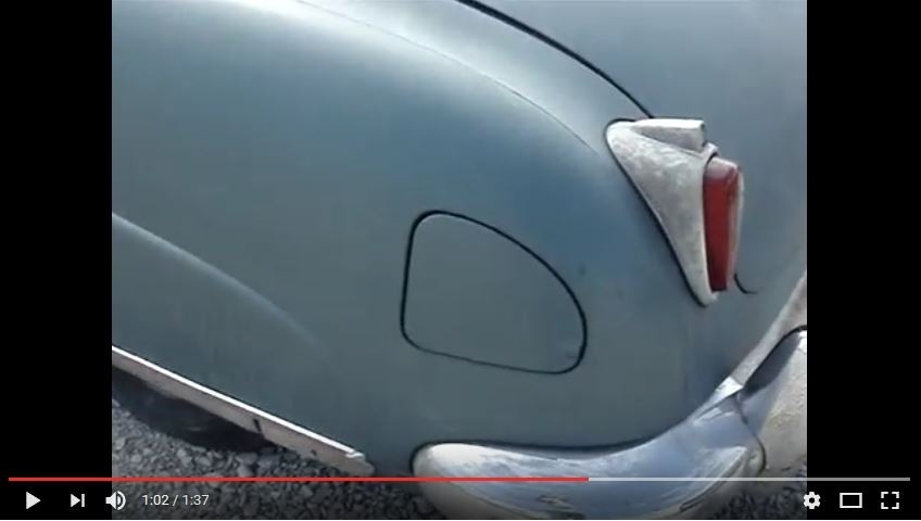

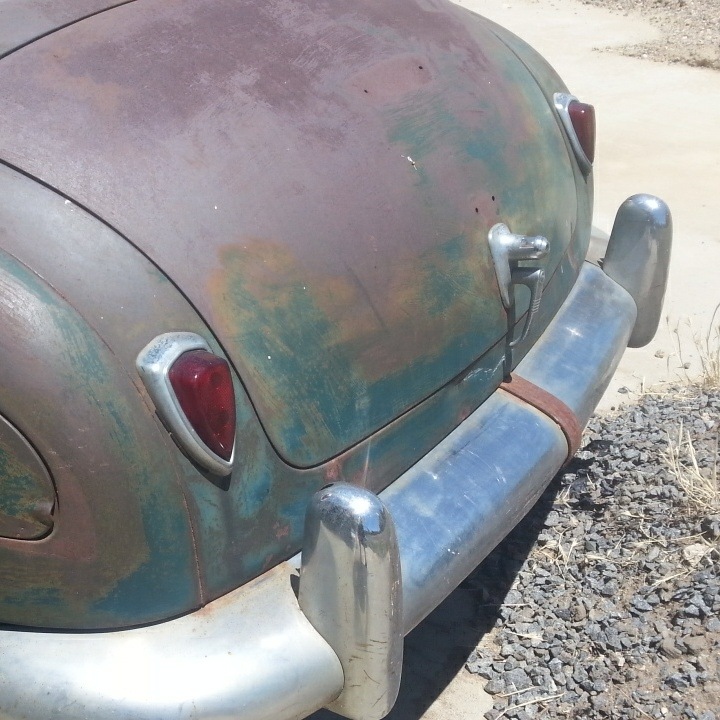

Continuing with the Super 6 identification, following are some pics of two cars identified online as a 1949 Hudson Super 6 with tail lights and a trunk latch different than mine (shown in last two pics). Theirs are cooler!
The gallery pics are taken from here: http://www.motoexotica.com/inventory/listing/1949-hudson-super-6/
And the video still shots are taken from here:https://www.youtube.com/watch?v=KqkgTwaZegY

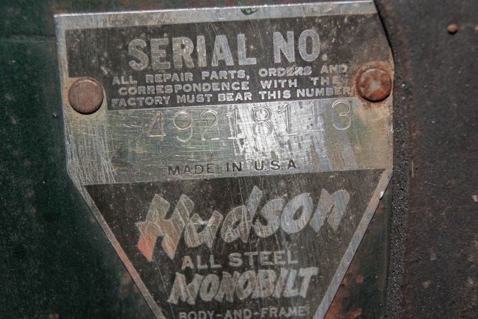

Also, the gallery car's serial plate shows a 2 for the model number instead of a 1 like mine. And, if this helps, I measured my wheel base and it seems to be 122.5 inches.

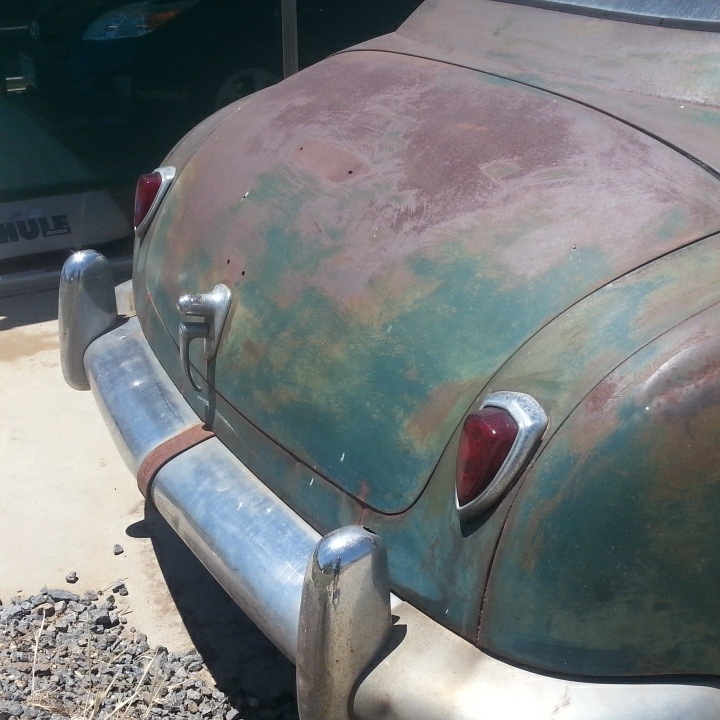

you just flicked up pic's of a commodores then a super for the last two pics. The super will have either 1 bulb per tail light or two if it has indicators. (i think as my non indicator hudson has 1 but the tail lights i got on here for the lenses has 2 so guess two is indicator equip models)
the pic you put up of your car above is small but the tail lights looks the same as my 49 super from that angle.

The Motoexotica car is identified in the link as a Super 6, but in most of the text as a Commodore. To really confuse the issue, they use Super 6 Commodore in one spot.
According to my copy of the master parts catalog, here are the serial numbers for 1949:
491 - Super 6
492 - Commodore 6
493 - Super 8
494 - Commodore 8
Serial number 49218113 should be a Commodore 6.
Also, from the same book, the larger, fancier tail light was used on Commodores from 1948 to 1951 and on Hornets in 1951. The smaller triangular tail light was used on Supers from 1948 to 1951 and on Pacemakers from 1950 to 1951. (For some weird reason, for the Commodore/Super it lists the same part number for the right side light from 1948 to 1951 but different part numbers for 1948-1949 and 1950-1951 left side lights.)
