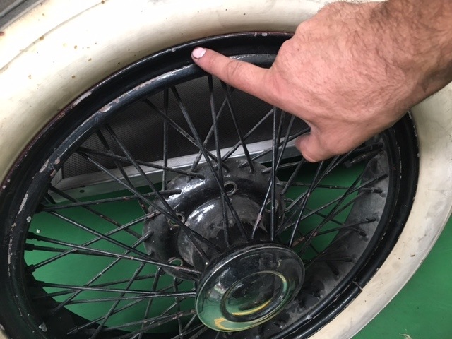

    what are the particulars concerning the wheels you have and want?
    what size tire diameter at rim?
    number of spokes?   Inner  and  outer as attached to center hub.

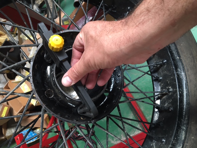

    Picture looks like 6 bolt holes thru center hub to brake drum.  are they on a 6 inch circle?
    I would expect a '29 to have 6 mounting bolts on a 6 inch circle, with 20 inch tires and 60 spokes.
    What do you have so we can help you.

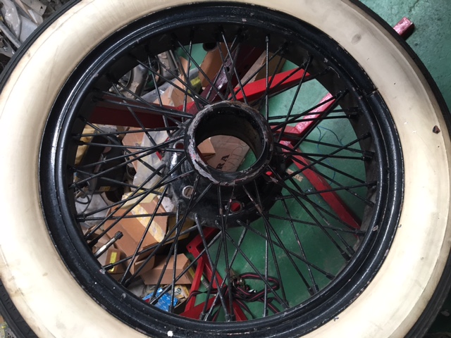

    Hello Hans,  I atached the photos of my whell. Sending drawing with measures too.
    Have 60 spokes with 20 inch tires. 6 bolts.
    It's the same as the one you describe.  I need two wheels for the spare tires. New or a good used.

    Yes, I am now sure of the wheels you require.
     It is amazing how many different wheels will bold on to the 6 inch 6 bolt hubs.  Even the 1929 Chevrolet DISC wheel has the same bolt pattern.

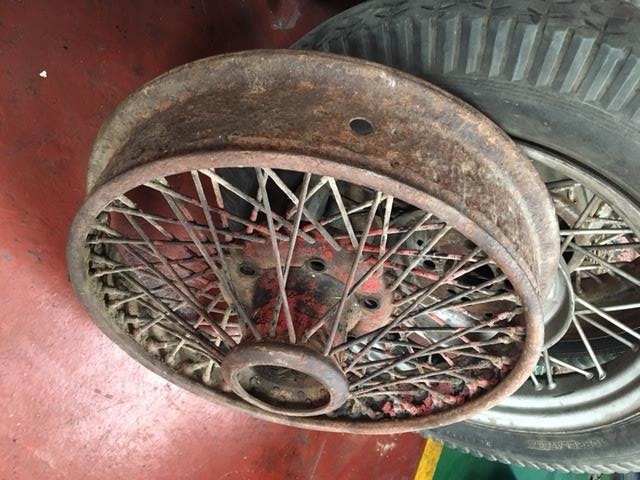

    In the end, I found wheels for my hudson but they are without the hoops ... could you provide me some for sale?

    It looks like you have 72 spoke wheels,  you must measure your tire diameter.
    they look like Wolverine 18 inch wheels.
    Even tho they have the same mounting pattern of  6 bolts on a 6 inch circle.

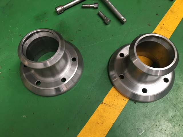

    I mount  and fit it perfectly. also I made the new bushings for the new wheels we order to manufacture.

    Photos The new Hubs
  • HansHans Senior Contributor
    Posts: 35
    Your machining of the hubs looks good.
    "Rings" for wheels take a lot of searching.
    The Rings are not all the same.
    First you must measure your wheels for the size tire used.
    Second  we need to know the depth of groove the Ring fits in.
    and Third, the height of the the fixed lip on the wheel, this will give an idea of size of Ring that sticks out of the groove.
