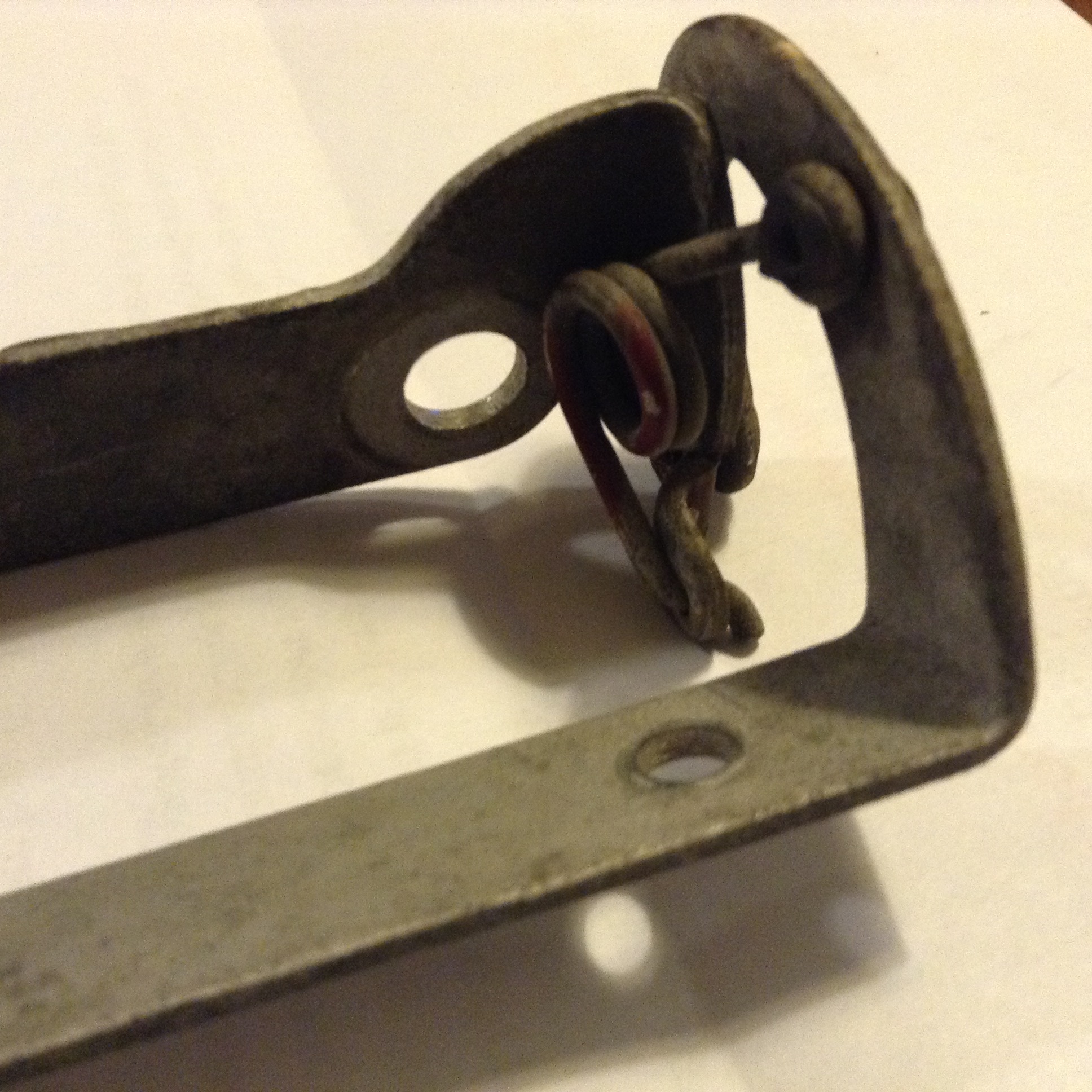

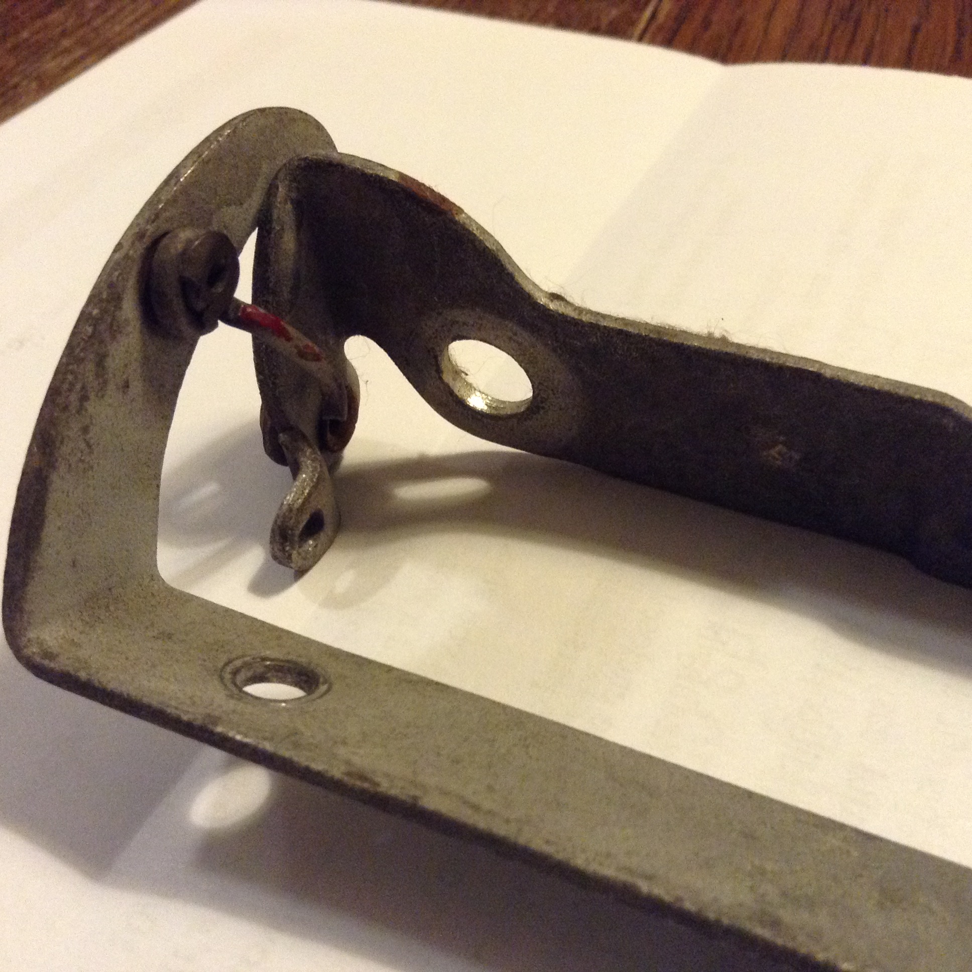

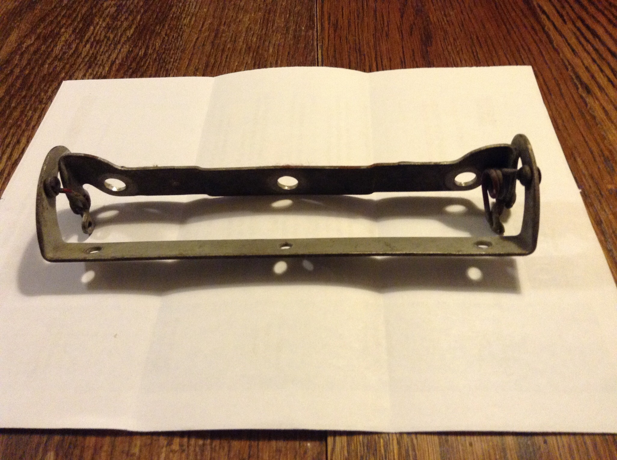

Hi All,
Does anyone known who may have hinge springs for the glove box / locker box for a 35 Terraplane. My left side one is broken.
Thanks
Tom

my hinge assembly still seats on my desk at work. My plan is to ask a company in Syracuse NY I've bought springs from for jobs at the shop I work at. Been very busy and haven't gotten to it yet. I'll try and fit it in and see if their interested. I. Looked at the pictures of the 36 springs in the WTN and they appear to be different. The 35 having two coils and the 36 with three. I also held the picture of mine up to the picture in WTN of the 36 to see how I could bend the 36 to work. Looked like the long extension on the 36 would have to be bent 180 degrees to make it work. But that's just me. I'll use this as motivation to try get over there and ask.
