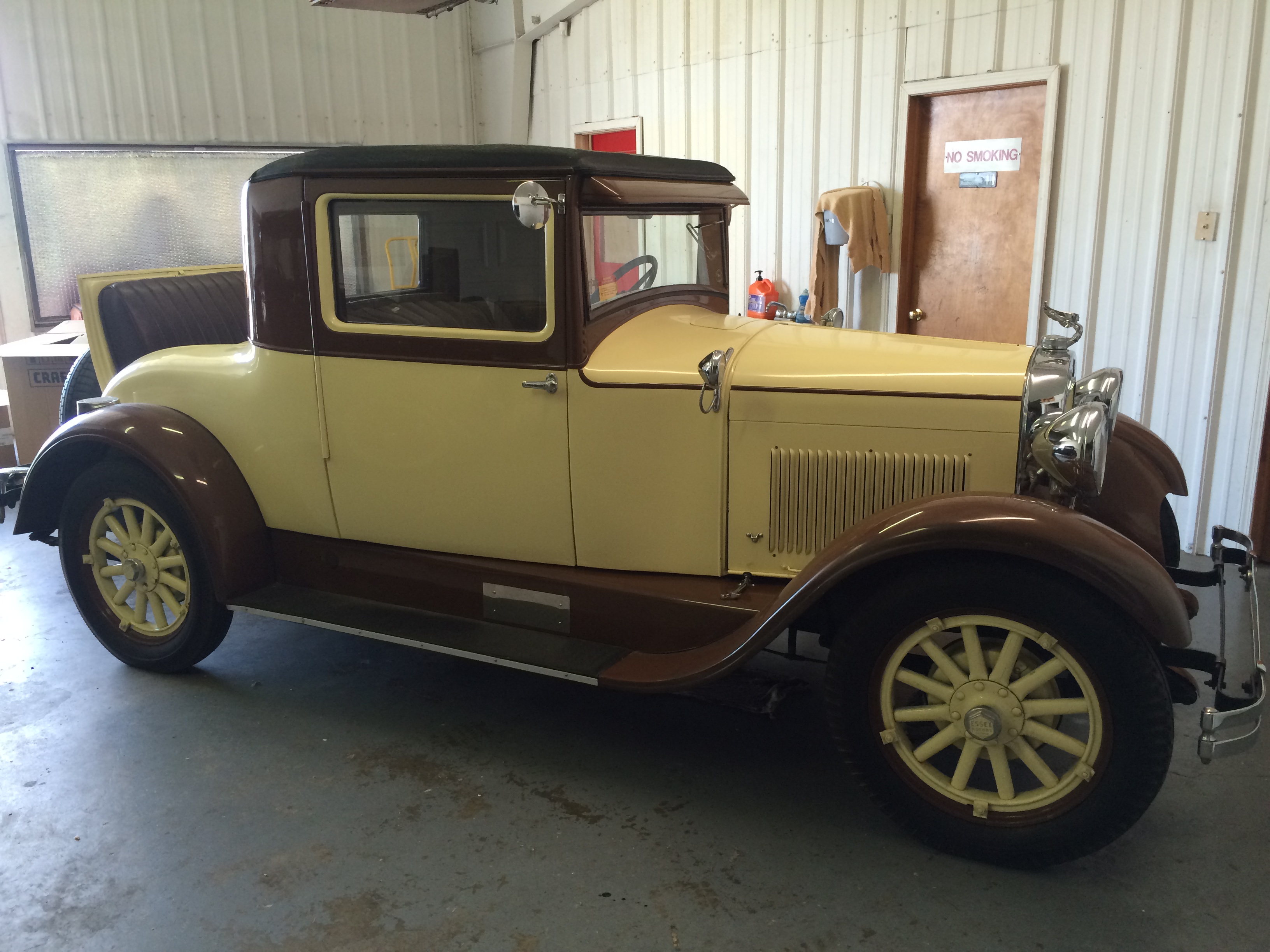

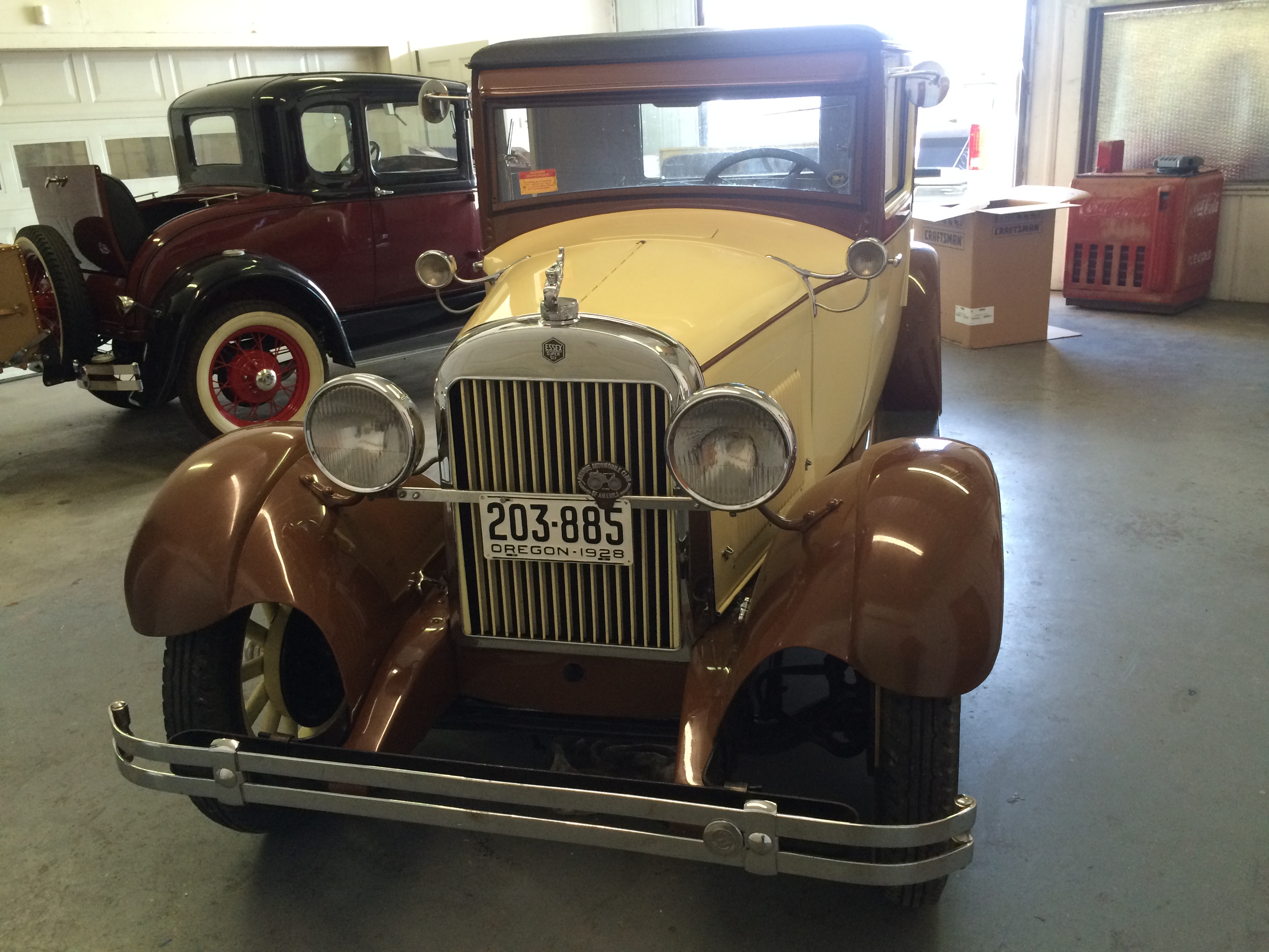

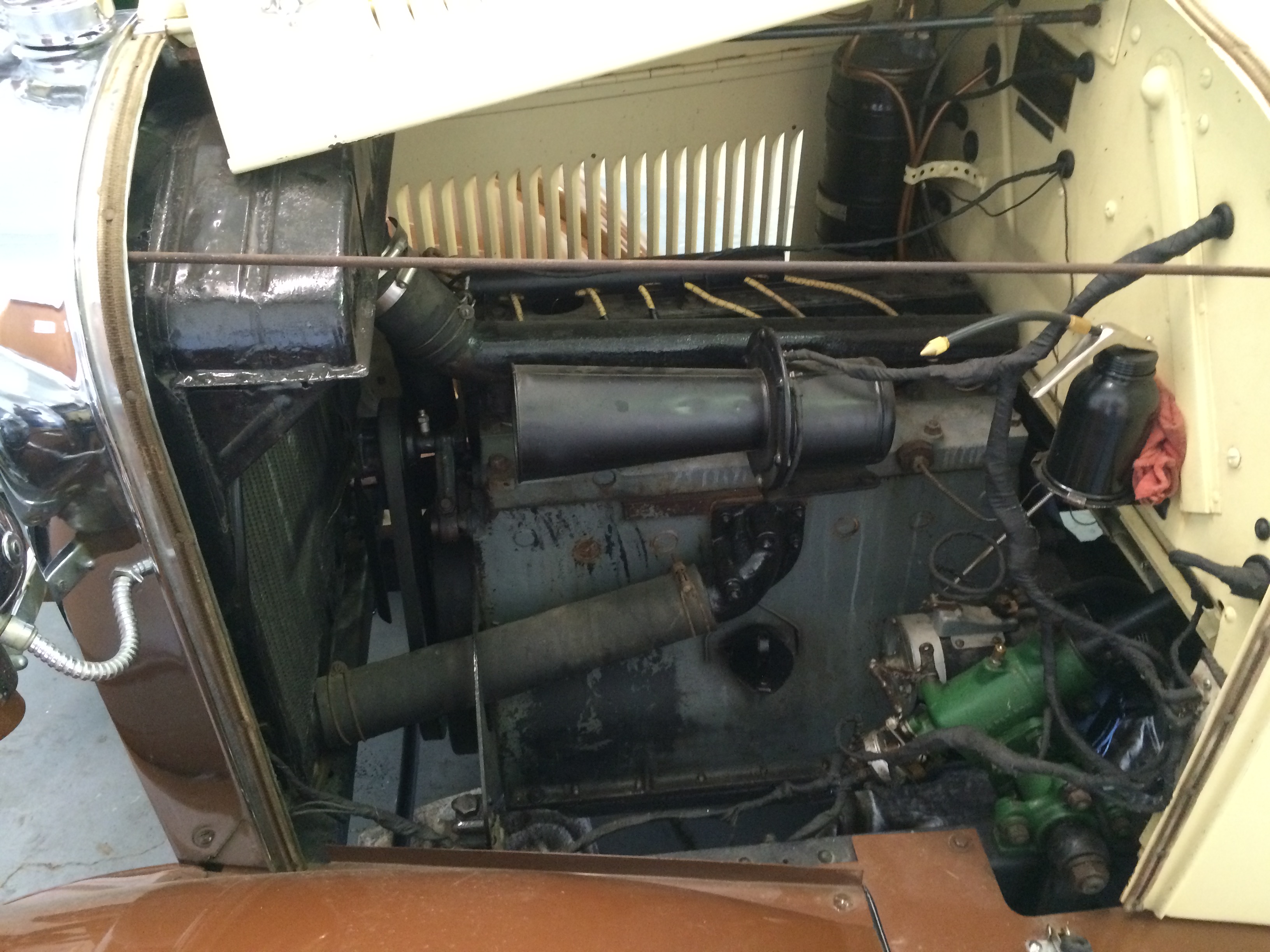

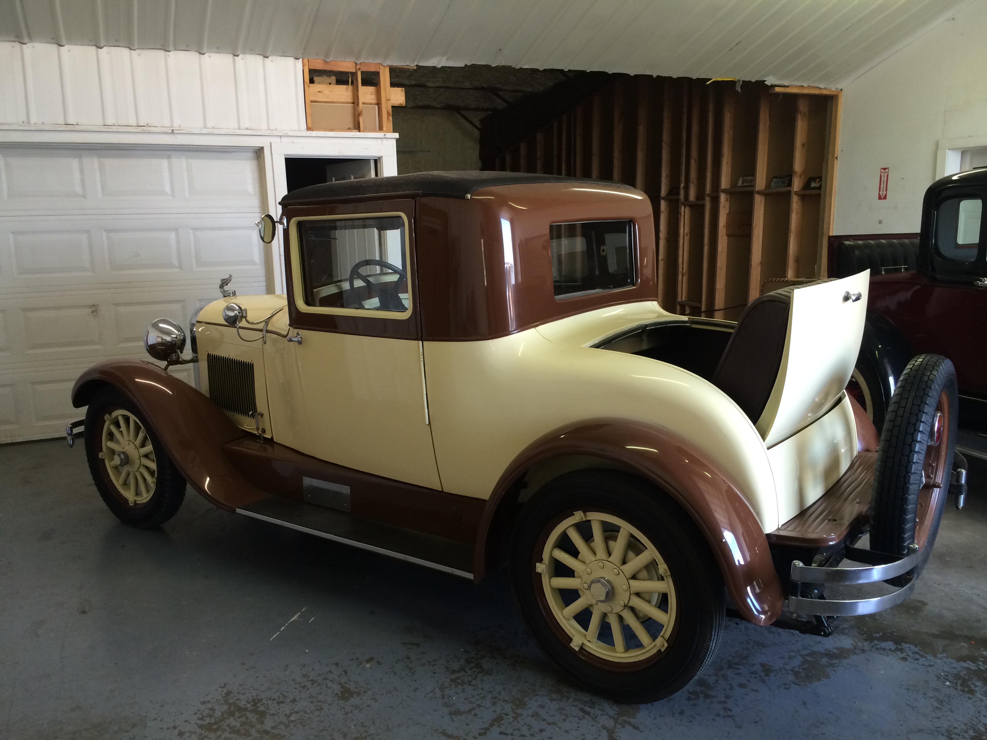

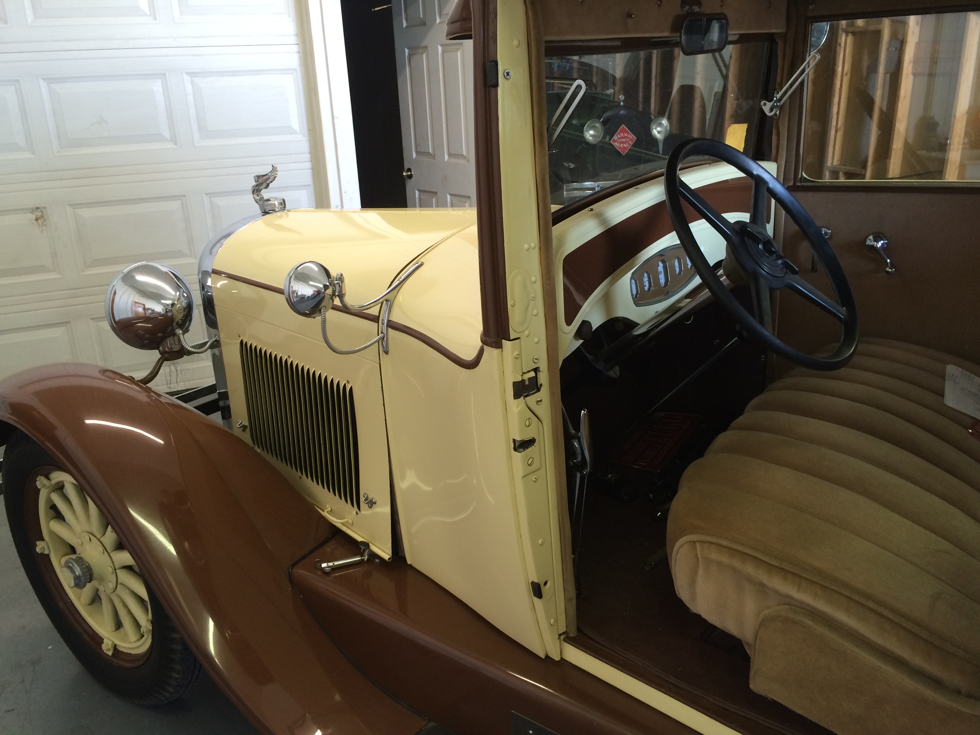

Here is a couple pics of the old girl.0
Nice!
