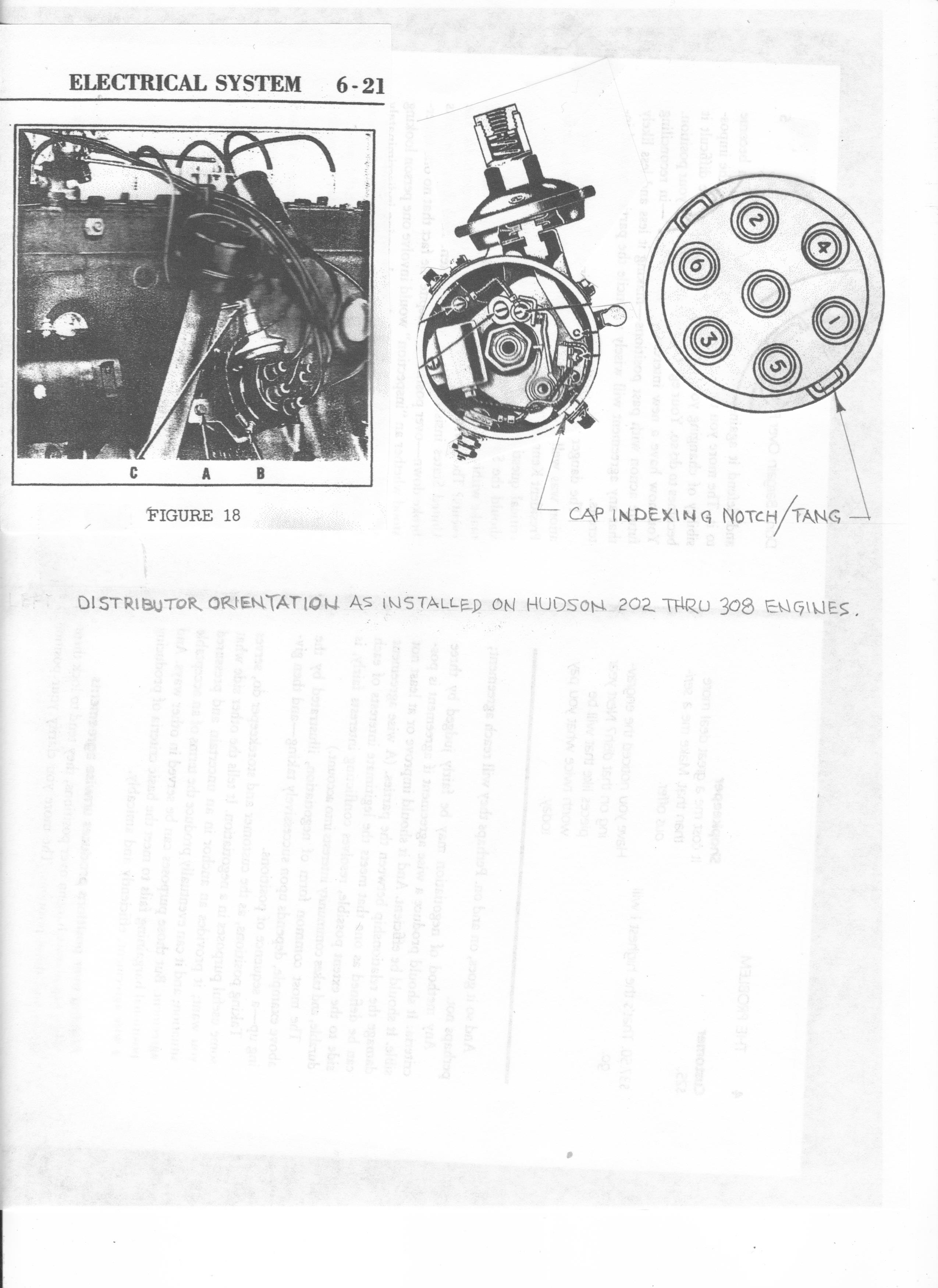

".......the dizzy position didn't seem to be close......"
Although timing is the question here, I'm still curious about this statement. If you are unable to get the distributor to rotate within it's normal range of the slotted attachment plate, the oil pump may be installed a tooth or two.....or three, off of the designed position. Did the individual who installed the pump realize the significance of the pump-shaft position as it relates to the camshaft? The distributor should be approximately in the orientation shown in the MPM (the book to which Ken referred).
The attached images are rotated into the actual position you should see on the engine as in the photo on the left.
Sure.......one can re-arrange plug wires on the cap to make almost any arrangement work but I'm a fan of starting where the book shows it. Have a look and see if it's a match.

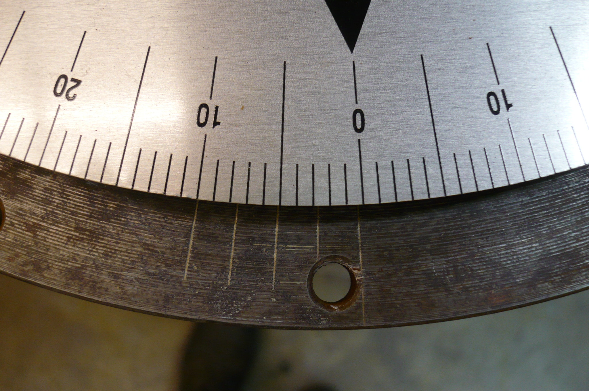

I've tried to find the specs for the lines on the flywheel and based on measuring it, it seems like each line would be about 2-2.5* per line?

You are correct that the timing marks on the flywheel represent ~2.5 degrees each. See attached.

Thanks for the confirmation Frank.
To me it's all subjective when you can't even get a good line of sight with the timing light.
You can change your view angle and change the timing 10*!
