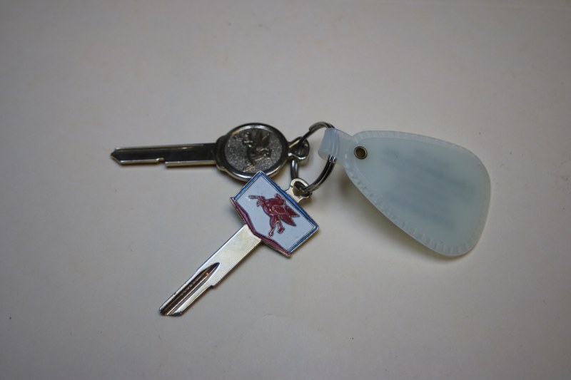

For those that don't know, when I restored my latest car, I actually started with some hard parts in bad shape and little else. Certainly, all of the locks for ignition, doors, glove box and deck lid had to be sourced. As time went by, I kept adding various lock assemblies to my "collection", which came from Regionals, Nationals, the odd swap meet and a few Hudson part collections I bought through the years. The goal, of course was to have the car set up like it came from the factory, which not only included using original-styled parts, but also to have the two original-styled keys where one operated the ignition and doors and the other operated the glovebox and deck lid. I reasoned that the more individual cylinders and lock assemblies I had (at least that fit the later step downs), the more likely I could convert those parts to one complete set. Along the way, I managed to find a couple NOS cylinders for the doors.Eventually, I got enough of an education to learn how it all works, what exactly I needed for my car and when the time came to put it all together, I still figured I wanted a knowledgeable locksmith to help me make sure I got it all squared away. That meant, an older locksmith, from a well-worn establishment. Some place that had been in business for a long time with a locksmith that had been there for a long time would fit the bill nicely and I had the perfect place picked out in town.J. Ross Boles was just an established place that specialized as a locksmith and safe restorer/seller/fixer. They had been in their current location for at least the last 40 years that I could remember. I had done some business with them in the past, but knew that the main locksmith on hand had also been there for decades. Not like any of that might have mattered when dealing with 60+ year old parts, but I thought the chances were better to find the appropriate help, anyway.I wasn't disappointed, either. That old locksmith knew exactly what to do, what I wanted and was willing to do it, even though, "My head might have forgotten some tricks, but my hands certainly haven't forgotten," he told me. "Come back tomorrow and I should have it all ready to go", he added.Now that part basically wasn't really worth re-telling, but here is where the story gets better. Upon my return the following day, he was good to his word and I had all five locks ready to install, very nearly completely new assemblies just like a worker would have picked them up out of the bins at the factory, and all keyed properly with brand new brass keys (that I had found as blanks). I think that old locksmith was pretty tickled that he got to help me with the Hudson, because he told me, "You know I collect old key blanks, have for years. I might have some that you would be interested in."He took me to his back office and in one of many drawers, he started thumbing through an assortment of several small envelopes. Behind the desk, was a huge pegboard on the wall loaded to the gills with blank keys of all configurations. Momentarily, I got an "AHA!" and he selected one of the envelopes and handed it to me and asked me if I recognized them. I did, and told him that they were promotional keys given to people by service stations to customers who bought an oil change, or had their car serviced with them, etc. This particular set of keys was from a Mobil station and the ignition key has an enameled porcelain in red,white and blue of the Mobil mascot, the Pegasus. And, they were made for Hudsons. I marvelled for a moment and went to hand them back, but he wanted to sell them to me if I wanted them, as he had several sets (I quickly bought two sets).As we went back out into the main office and he was starting to prepare to cut my new (very cool) keys, he said, "It's really ironic that you came here of all places to get your Hudson keys made.""Why is that?", I nonchalantly inquired."Because this building used to be a Hudson Dealership", he announced."Nah, I don't think so, we know where all the dealerships here in town were located and 606 Broadway is not one of them."He quickly pointed out the ramp that went up to the back door, the two picture wiindows where just two cars could have been placed up front, etc. I thought, yeah, maybe SOME kind of car dealership, but most likely not Hudson. But, I was intrigued and set about doing some research. Before long, evidence came our way, and sure enough, before J Ross moved in there, it was, in fact a small Hudson dealership, towards the edge of downtown, at least in the 40's.So, ironically, my locks were re-keyed and my newest set of keys, which had never been used, were acquired at the local Hudson dealership. Later, I took them the following so that they could display it if they wished:0
Now those are way cool!And a great story,
Thanks for sharing!
Jeff0 -
Russell,
Thanks for sharing the story. cool keys!
