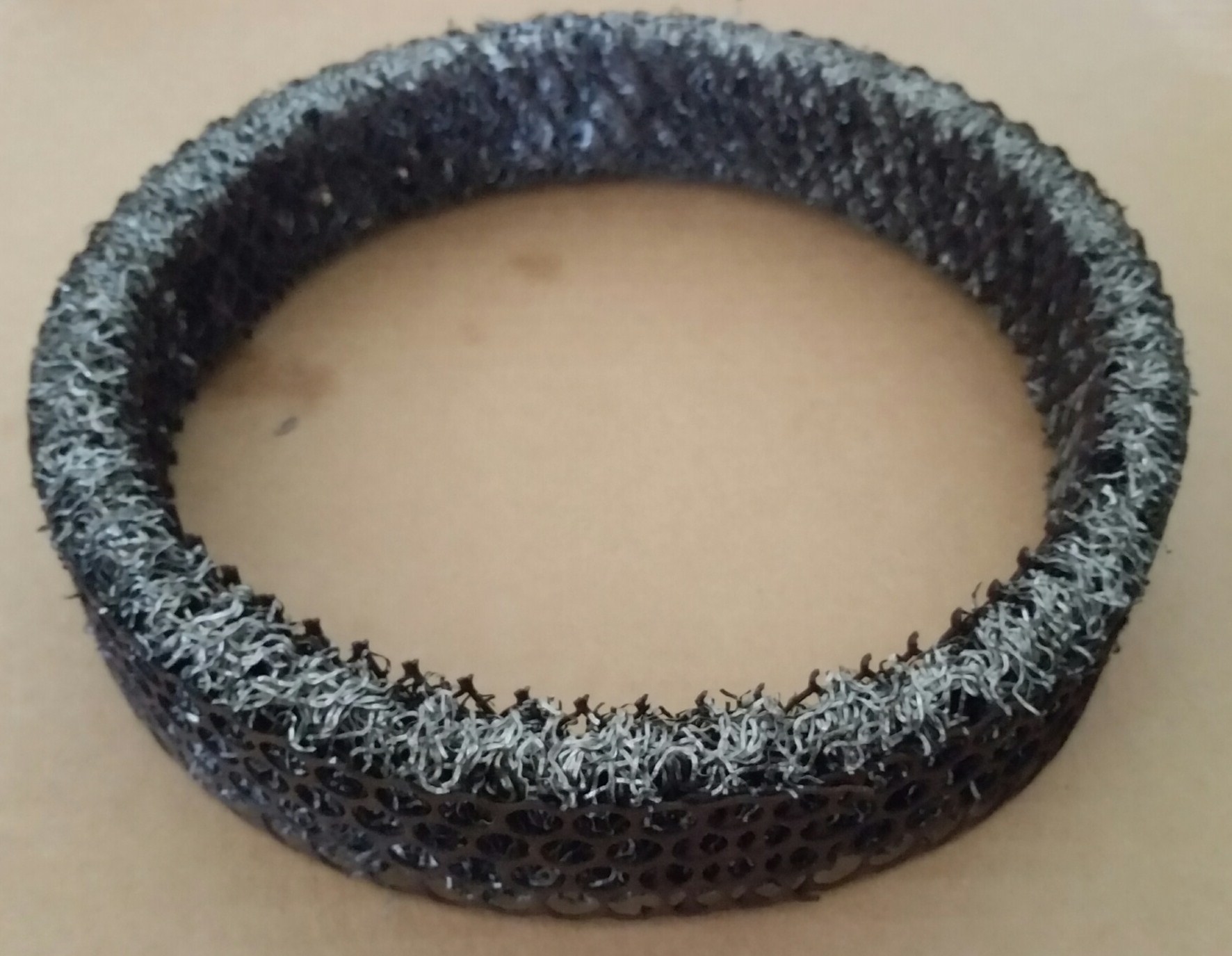

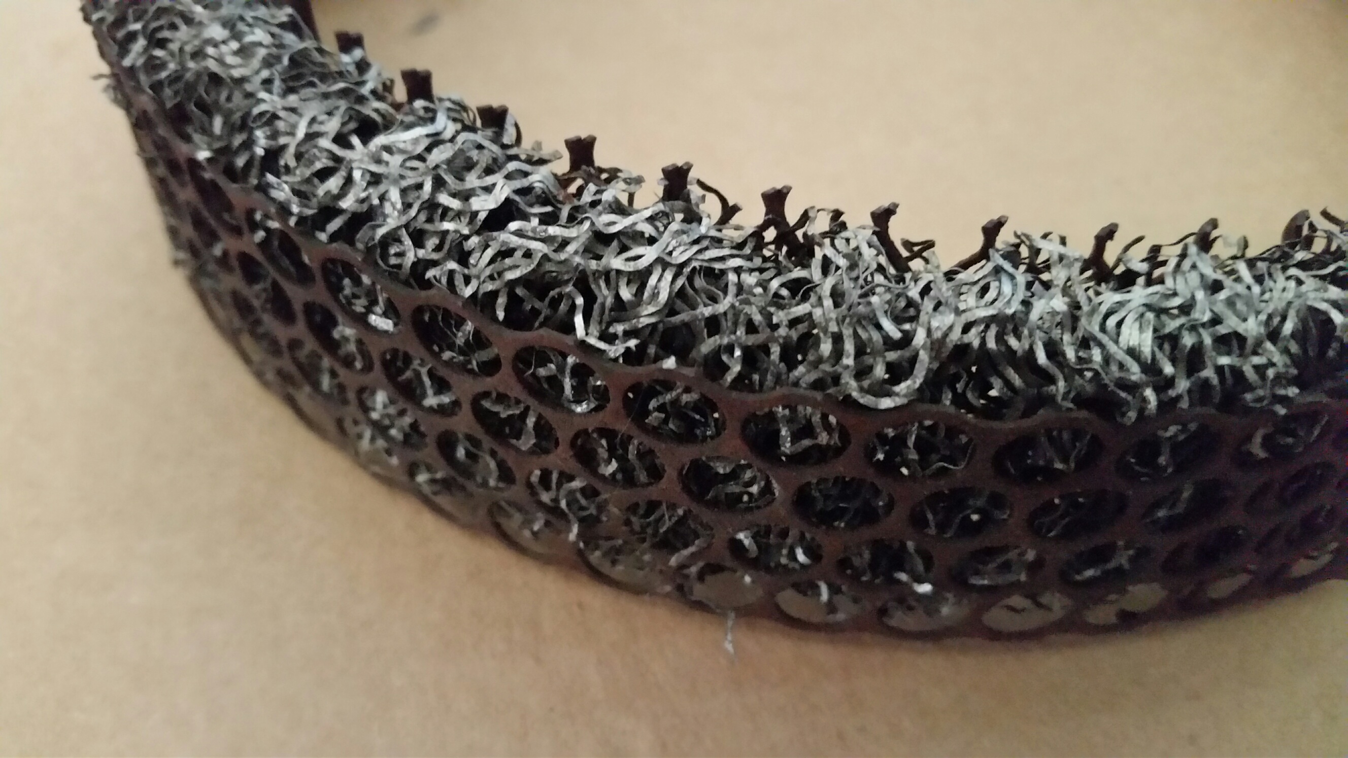

A few pictures of the current 'filter'. Original? Don't know but it's been there since at least 1973.
I think it's pretty obvious why I want to replace it.
Yes, that looks original, at least original-style. The usual method was to soak them in gasoline and then blow them dry and then put some light oil in it.0
Chris
Looks just like mine and looks similar condition which looks fine. With it sitting on the base and the lid on leaves just the outer visible which is right. Cleaned and reoiled does the job well.
My worry is that it's falling part. Little bits of the inner material keep coming loose and I'm afraid they'll find their way into the carb, which kind of defeats the purpose of having a filter in the first place.
Since I still haven't found a replacement, I'm thinking maybe I can wrap the inner ring with some kind of screen to keep any debris contained.
Wrap the whole filter in screen and you are good to go0
