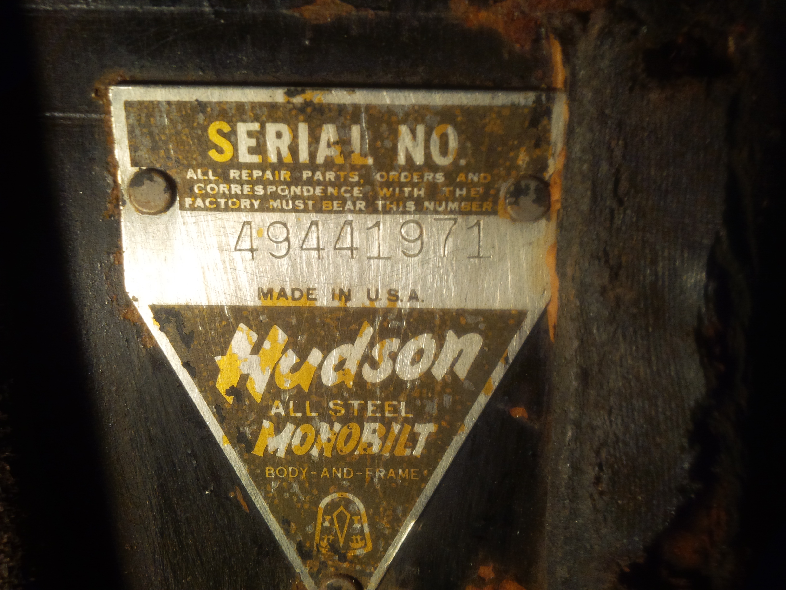

The first year Hornet was 1951. From your SN it is either a 1949 Sedan, Club Coupe or Convertible Brugham
What model do you have?
Lee O'Dell0 -

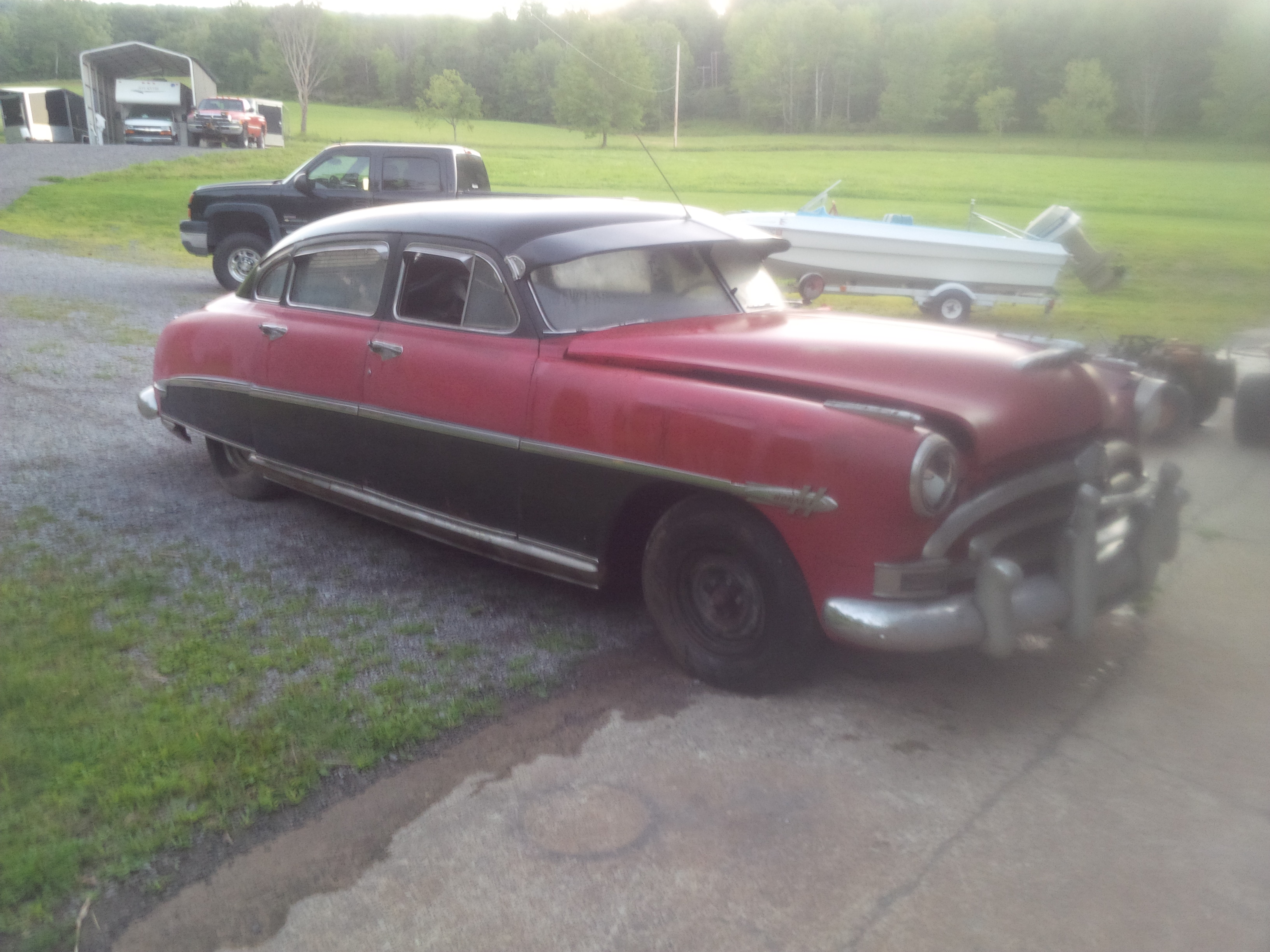

Sorry my comments didn't post. I think its a hornet all emblems and interior parts state that it is. Car is unmolested been in a shop on lift since 1979!!. My projects take a while but that's a while to tie lift up!! So I don't want to alter or modify a rare car??? Thanks Bill
As Lee pointed out, 494 denotes 1949 model year. Hornets were introduced in the 1951 model year. Every piece of trim on your car denotes 1953 Hornet.So, either all of the trim, front end, rockers have been changed on your car, or the VIN tag has been changed. Interior pictures of your car would help, but the proof is in the pudding. The SN (or VIN) is also stamped on top of the passenger side wheelbarrow portion of the frame (in front of the cowl) in a couple places. Usually have to remove tranny hump floor pan (made to be removeable) to find out for sure.Anyone that told you only 18 Hornets were made in 1949 was selling something. It's not true.0
Ok I will grab some interior pics and post after work . It has the dual carbs and manual tranny if that helps. I will also ck for number on frame. I had read the statement about the 18 hornets while researching the vin on line unsure where but thanks for help hope to figure out soon.0
What Russell said.....0
Bill
The SN says 1949. The Hood is 1953, grill and front turn signals 1951, tail lights 49, side trim 52 or 53.
You have someones attempt to make a 49 look like a Hornet. The engine number should match the SN. It is stamped on flat vertical location on the front side of the engine just below the cylinder head and forward of exhaust manifold. Someones attempt to make a 49 look like a Hornet.

Yes, that's true about the taillights and front parking lamps, didn't even look that close.0
Bill
I apologies if I came across criticizing your car. I don't mean to. From what I see from the pictures, you have a good looking car. Get it running, new tires and enjoy. Maybe what you have is a customized 1949 Hudson Commodore Eight Sedan now powered by a powerful 308 Twin-H Hornet engine. Nothing wrong with that.
Here is some additional information from Alex Burr's General Information Handbook for Hudson Built Automobiles, SN beginning with 494 is a 1949 Commodore Eight sedan. It originally came with a 254 straight 8 cylinder engine.
Also, you may be lucky and someone installed a 308 Twin-H engine too.
The SN on your engine determines the engine year. The casting numbers below the distributor will determine the month, day, and year the block was cast.
The Hornet engine also has a raised rib along side of engine, full length, about 2 1/2" inch above bottom of block on drivers side.

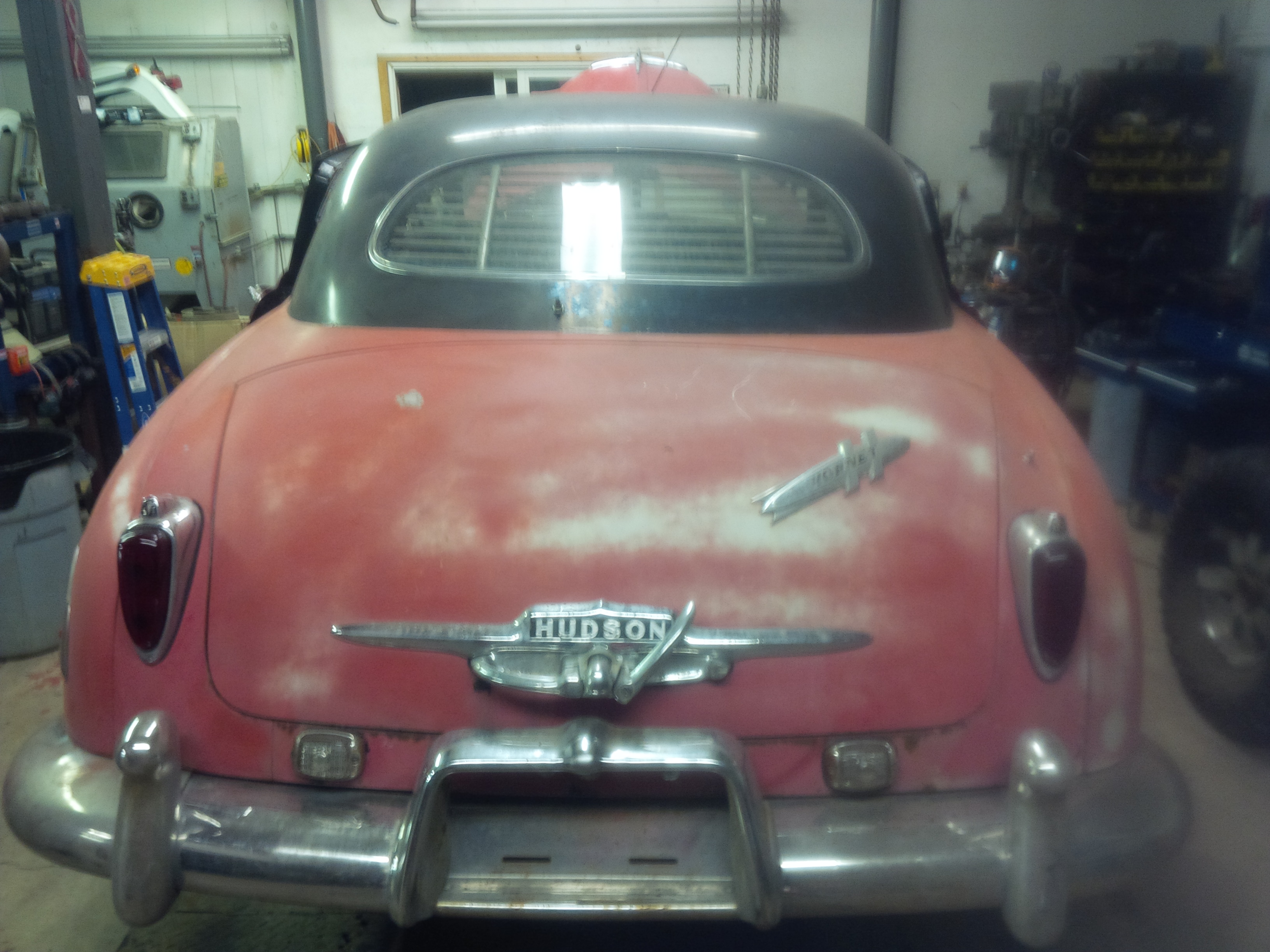

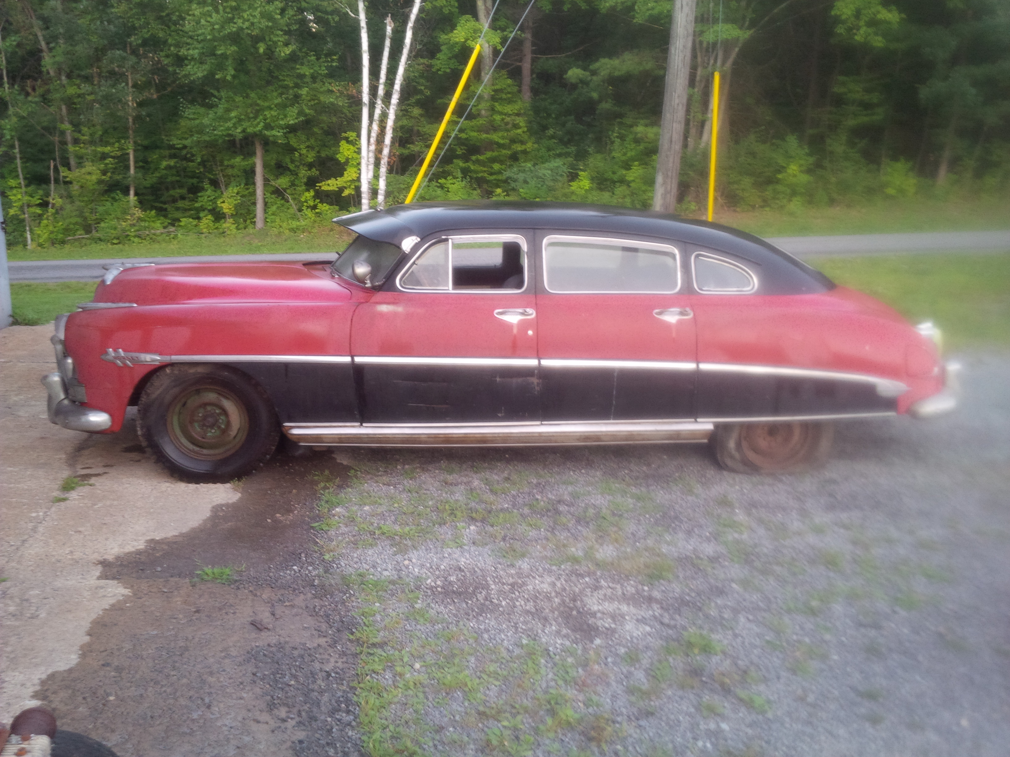

Fabit, Take a picture facing the rear window. That will tell if the body is from 48-49 or the later Hornet wide rear window models.0
Good point, Lance! You can tell it's definately not a '52-'53 from the side view, looking at rear vent window.0

I went to look at side view of my 52 Hornet and you can see the larger back window. Very little body between back window and longer rear vent window.

I agree with you it is a 53 Hornet front clip & side trim. The turn signals thru me. Then I saw pictures of 51-52 Commodores with rectangular turn signal lights like Fabit's, rather than Hornet turn signals. Do you think it might be a 53 Hornet clip with Commodore turn signals? I don't know if the grill surround is different to accommodate for Commodore and Hornet turn signals. What do you think?
Lee O'Dell0 -
Just looked at some 51 Hornet photos. They also have rectangular turn signals. I suppose only one person really knows what changes were made? The Shadow Knows.
Lee O'Dell
I guess I will get myself in trouble. The body has a small rear window as well as the earlier small rear vent windows found on 51 and earlier stepdowns. Also one might think what the poster's handle means fab it?0
I will post more pics when I can. I'm stuck at work. As for my handle short for Fabricate it. I'm a hvac tech and a old car motorcycle nut in upstate ny0
Lee-The front turn signals are '51. Hood Ornament: '53. Body is '51 or earlier. Hood is '51 (note the center grille emblem and how high it sits up past the grille, and the corresponding cut-out in the center of the hood lip for the emblem. In '52, this center emblem was lowered and the cut-out is less severe.Side trim on beltline is '52-'53. Trim at bottom of doors, fender and quarter are '50 Commodore (have eyebrow shape and are stainless).Left Front Tire from '49 Dodge Truck.(Just kidding about the front tire . . . it's from a Ford).)0

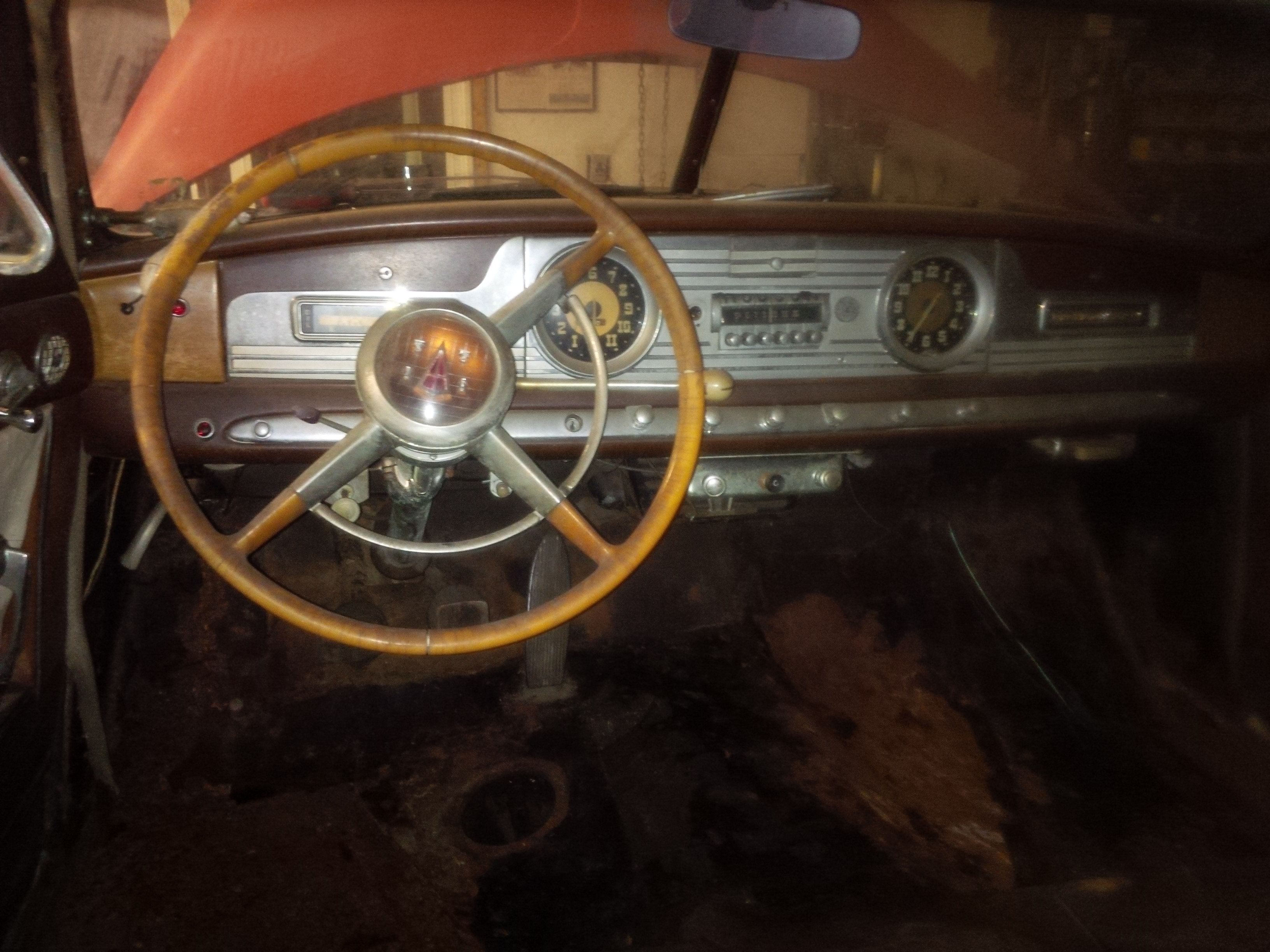

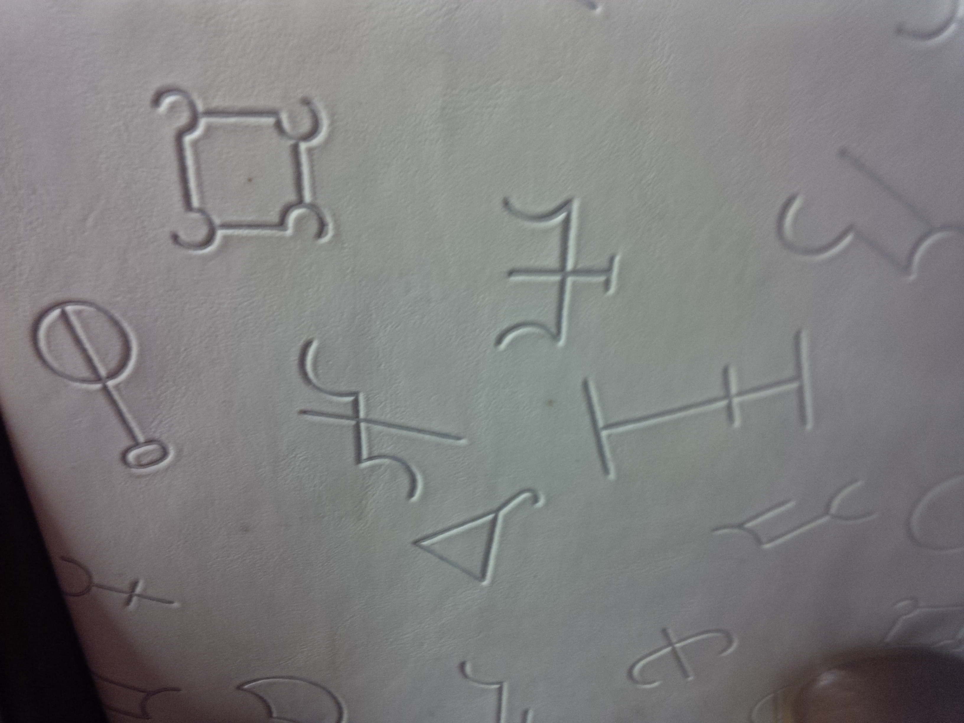

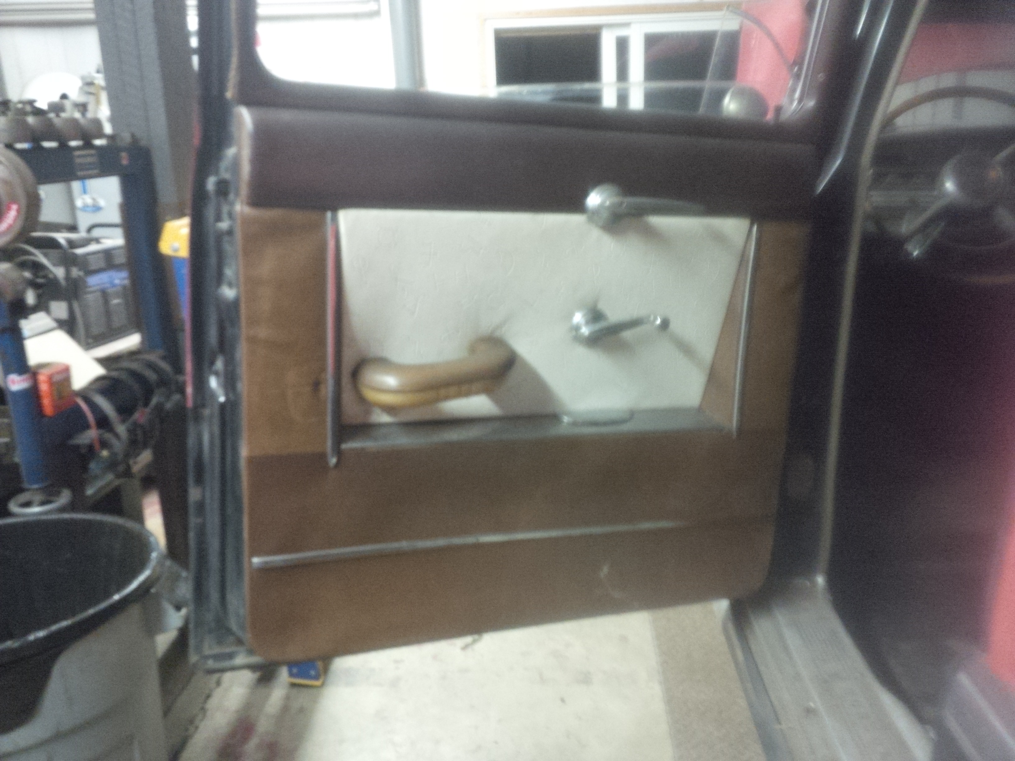

Here are few more pics . They are not best quality. The one of the white material is of the door panel inlay? Thanks for the help
Looks like something I built !
My thoughts while I was viewing the photos. " that looks like one of Daves creations"Looking at the last photos , it has a 50 dash.
1950 Super? I don't see the split rear window
Not a lot of original pieces on the car.
Someone had a Hudson " Farm" and harvested pieces, maybe showing how he thought they should be built.
I see parts from 49- 53 , maybe 54 if the side trim came from a 54
Interesting steering wheel , 51? Don't recognize the color.
Sure glad the OP sent the photos , livend up the forum a little

Armrests are the earlier ones. Very interesting, regardless, fabit. Thanks for posting. I think someone put together what they had available, or maybe what they wanted to have.In all honesty, I've been wanting to take a '51 Brougham body (2DR Sedan) and turn it into a '52 Hornet, i.e., the Hornet that Hudson "shoulda" built. Maybe someday.0
