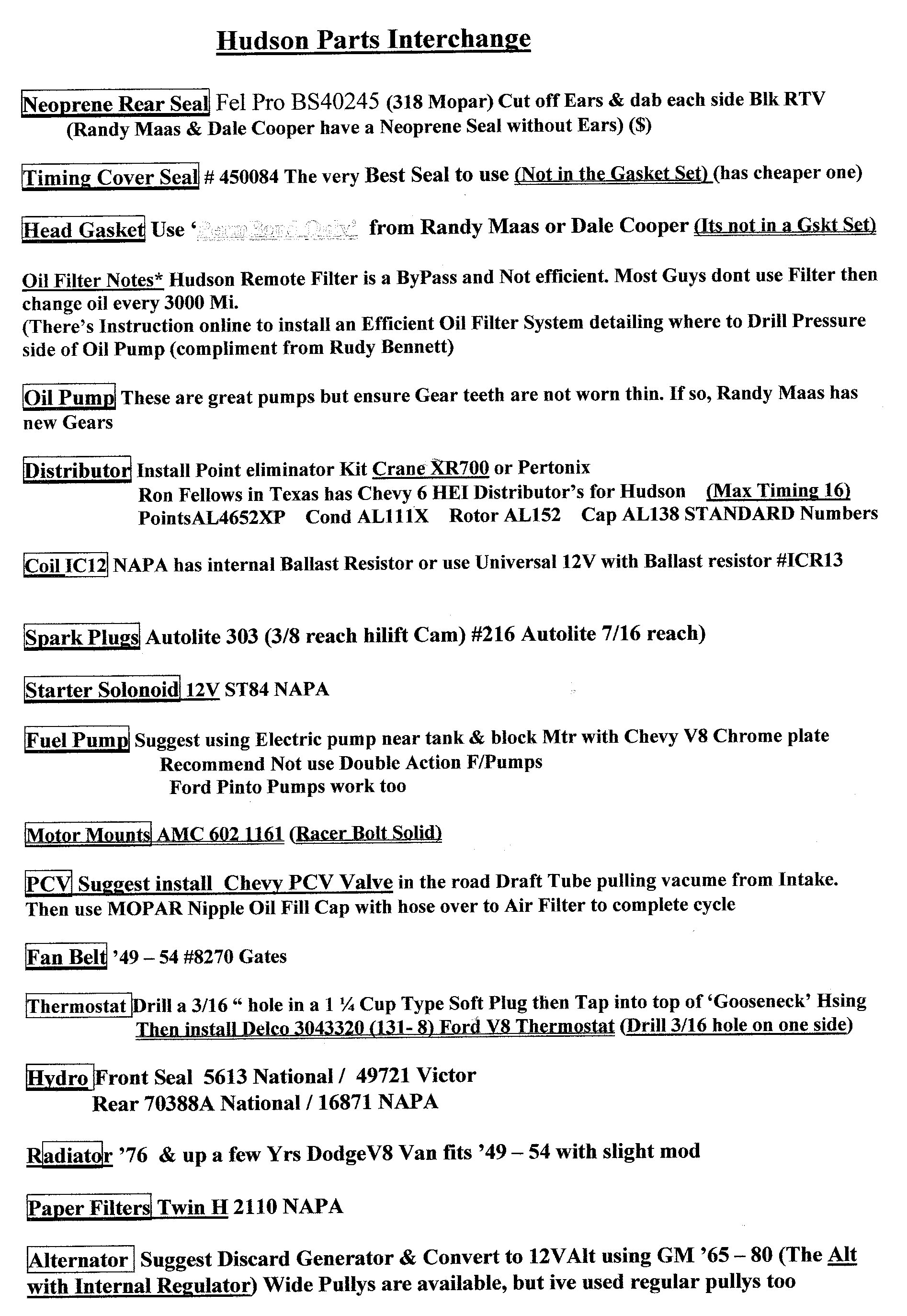

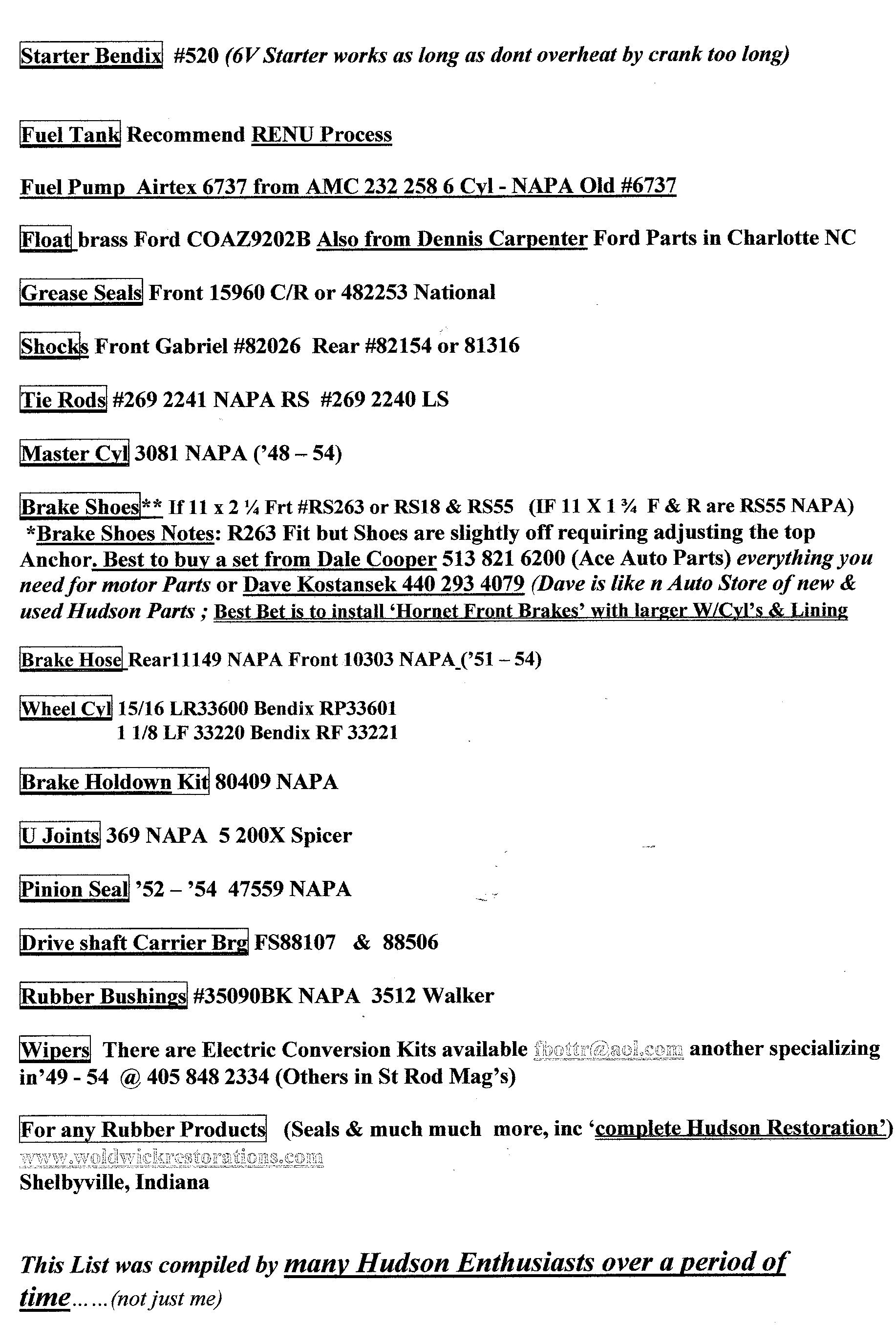

Trying to Attached and share a Hudson Parts Interchange List that ive compiled over the years from other Forum Members Posting & Websites. Its not perfect and some Info may be outdated but better than no Info.

Most of this Information came from Members Postings on the old Forum where I would make a note of something I wanted to retain. Recently I put all the notes together then printed for easy availability. If attachment is difficult to read send me an email cv.cars@verizon.net then I will forward the pages.

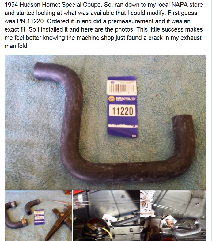

Someone might need to check the HET Facebook, stuff posted there often.
Ed Petersen just posted this on HET Facebook-- Things do need to be in one central place? This also fits a '53 and probably earlier. Expensive but looks better than a semi-circle !!0
