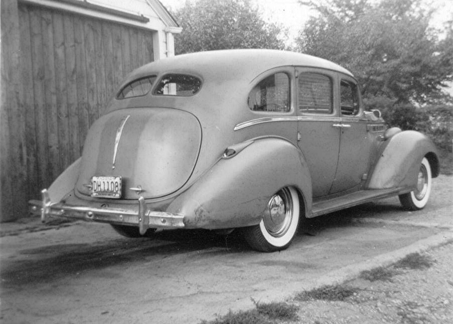

Yes, the extended trunk lid bolts right up to a "flatback" car. The sedans with flatback were called "town sedans," the extended trunk models were "touring sedans." You've likely noted that the '37 trunk lid extends a bit further than the '38. The '40's were different yet. They ('37-'40) interchange easily. In my youth I didn't like the "shallow" lid on my '38 sedan (photo) so swapped it out with a '37 lid.0
Thanks guys for the responses. Great looking '38 and I agree about the lid enhancement.

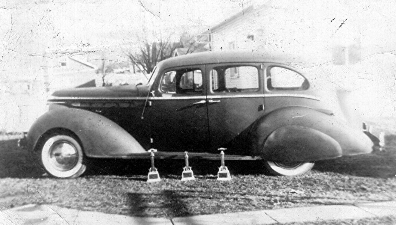

Here's a (poor) shot of the '38 with the '37 trunk. Taken after we'd made a few trips to the drag strip outside of Chicago (I still have those trophies!)
