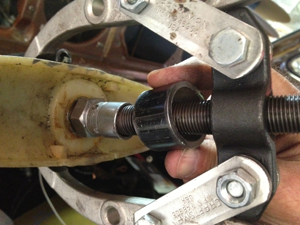

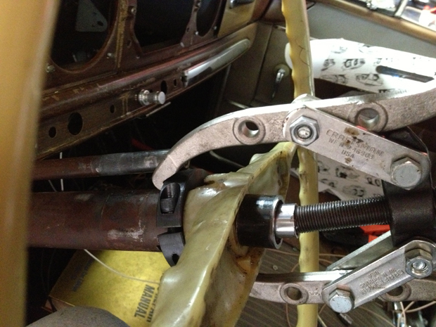

Put a split ring behind the wheel center mount, nut on centerbolt with short piece of pipe to prevent protective socket from moving, added PB Blaster and tightened on puller as hard as possible. Was talking to parts guy at parts store and an older mechanic said "hit it with a hammer, either at the end of puller or take all that off, put another nut on shaft, have one person pull wheel and other hit the nut"Went home hit puller end with mini-sledge and wheel popped right off!Maybe this can help someone else.0

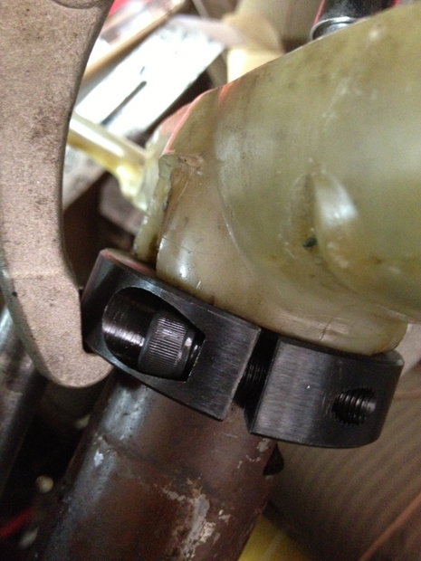

I made a puller and a split-ring adapter to get up inside the plastic under the wheel0
Very Cool puller Larry!???0
