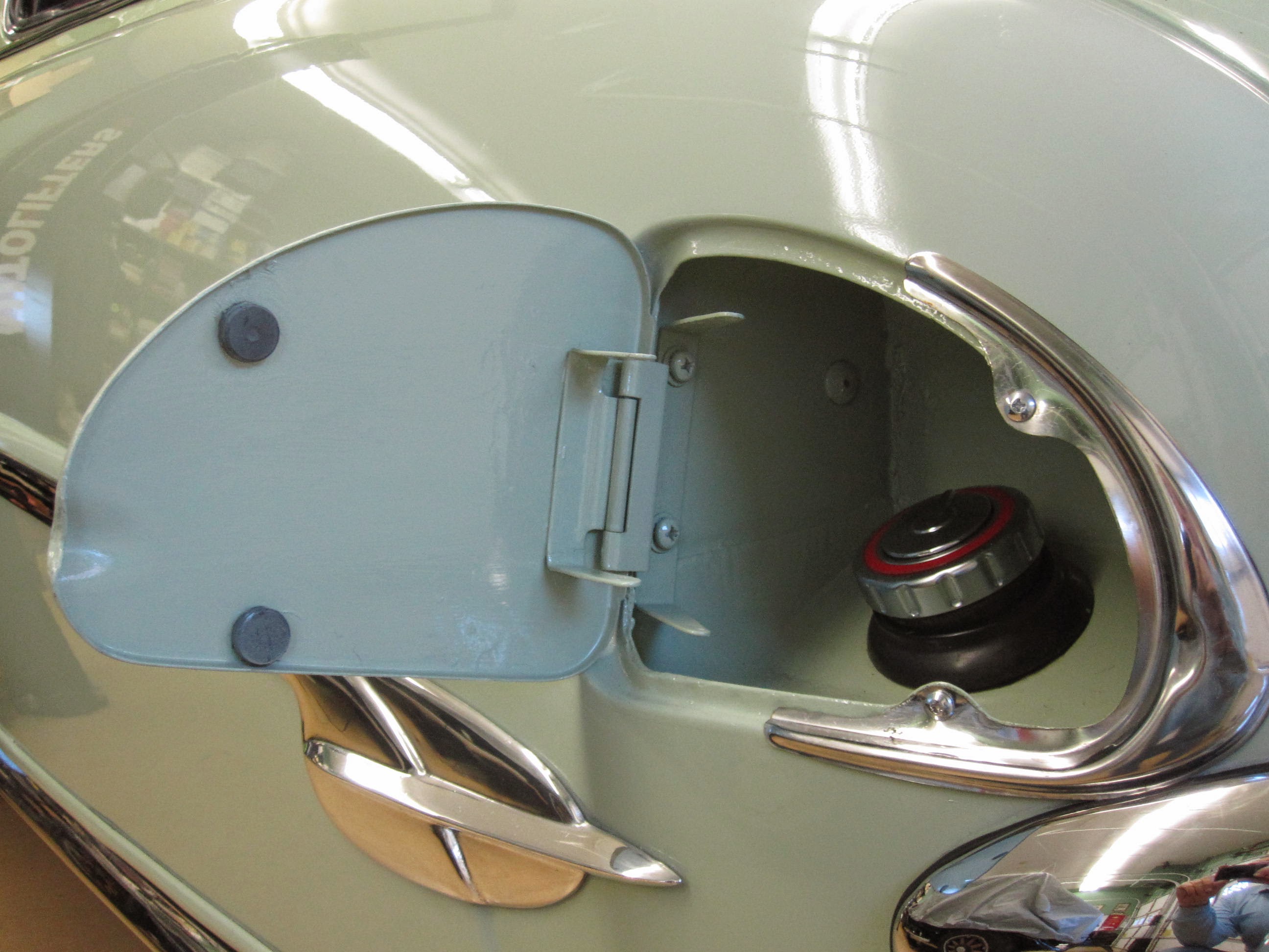

I bought a locking cap on eBay but had to drill a hole in it (holes since they had to be off-set thru the parts). It was extremely reasonable. They are out there but remember the vent.
Also, I have to back the nozzle out sometimes when filling up to prevent shutoff; which is often since I haven't fixed the gas gage yet !!
Before someone asks: those are magnets to keep flap closed. Normal springs are too tight. They work very good.0
Too tight for what?0 -
Have read on forum from more than one that both stock springs are too strong &/or you 'break fingernails' getting door open.
Probably should have said: "I have read that......."
Suppose thickness of nail would mean something?
Having just one spring as recommended might look like one was missing.
Anyway, magnets are good and level is correct;--they were there when I got car.
