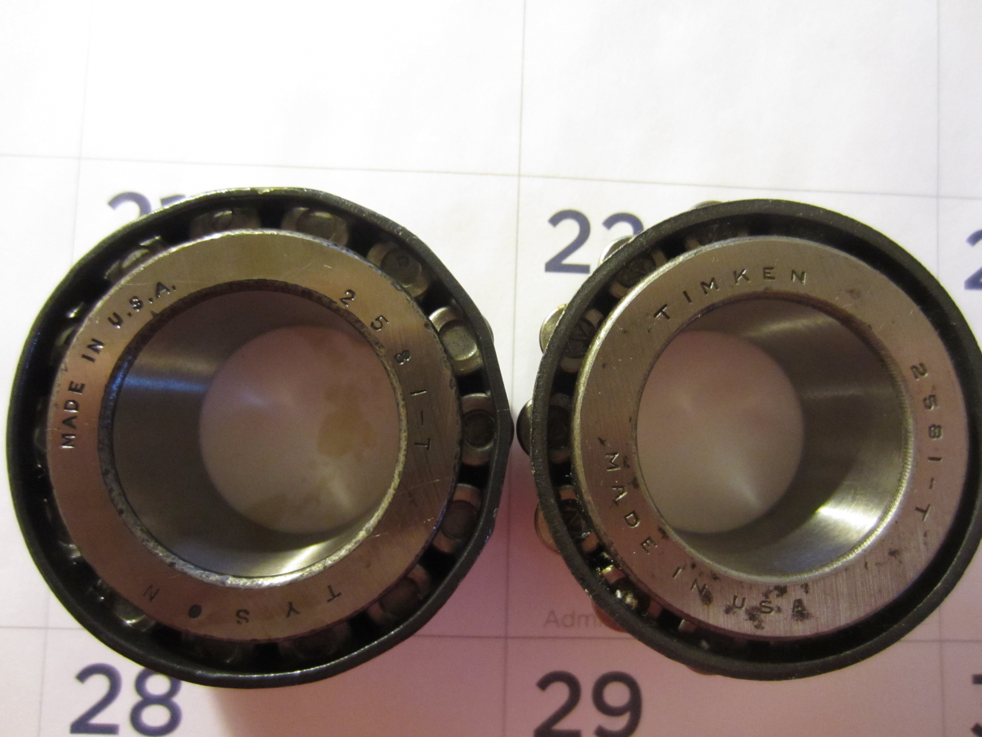

Hello All,
Has anyone had experience with bearings manufactrued by Tyson? It's an American company that's been in business they say for 70 years. I bought two of the 2581-T tapered bearings and they measure the same as the NOS Timken I have. If the feedback is positive I have a line on a guy who says he has 4000 of them so there should be plenty for everyone. Feedback everyone??0 -

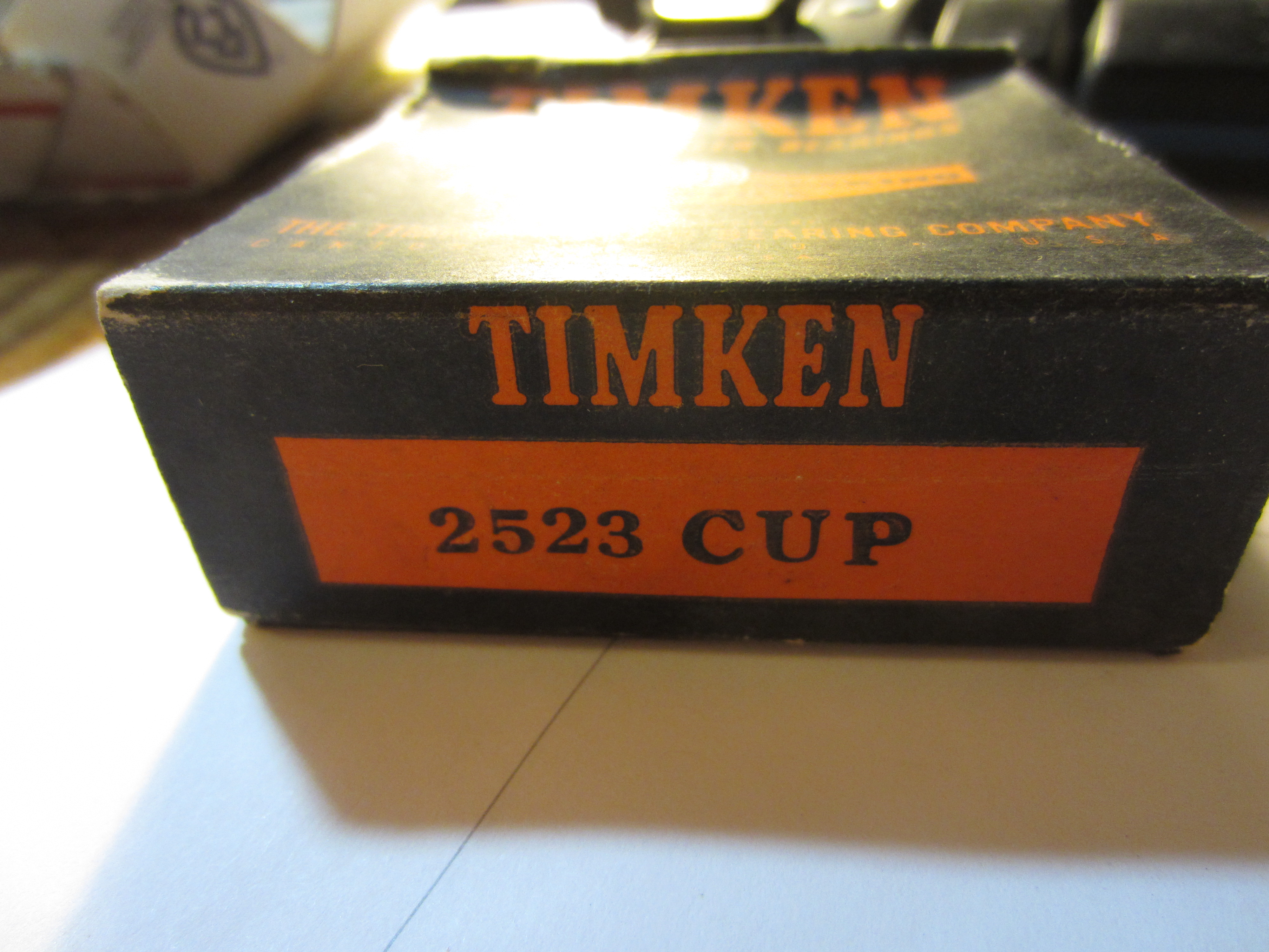

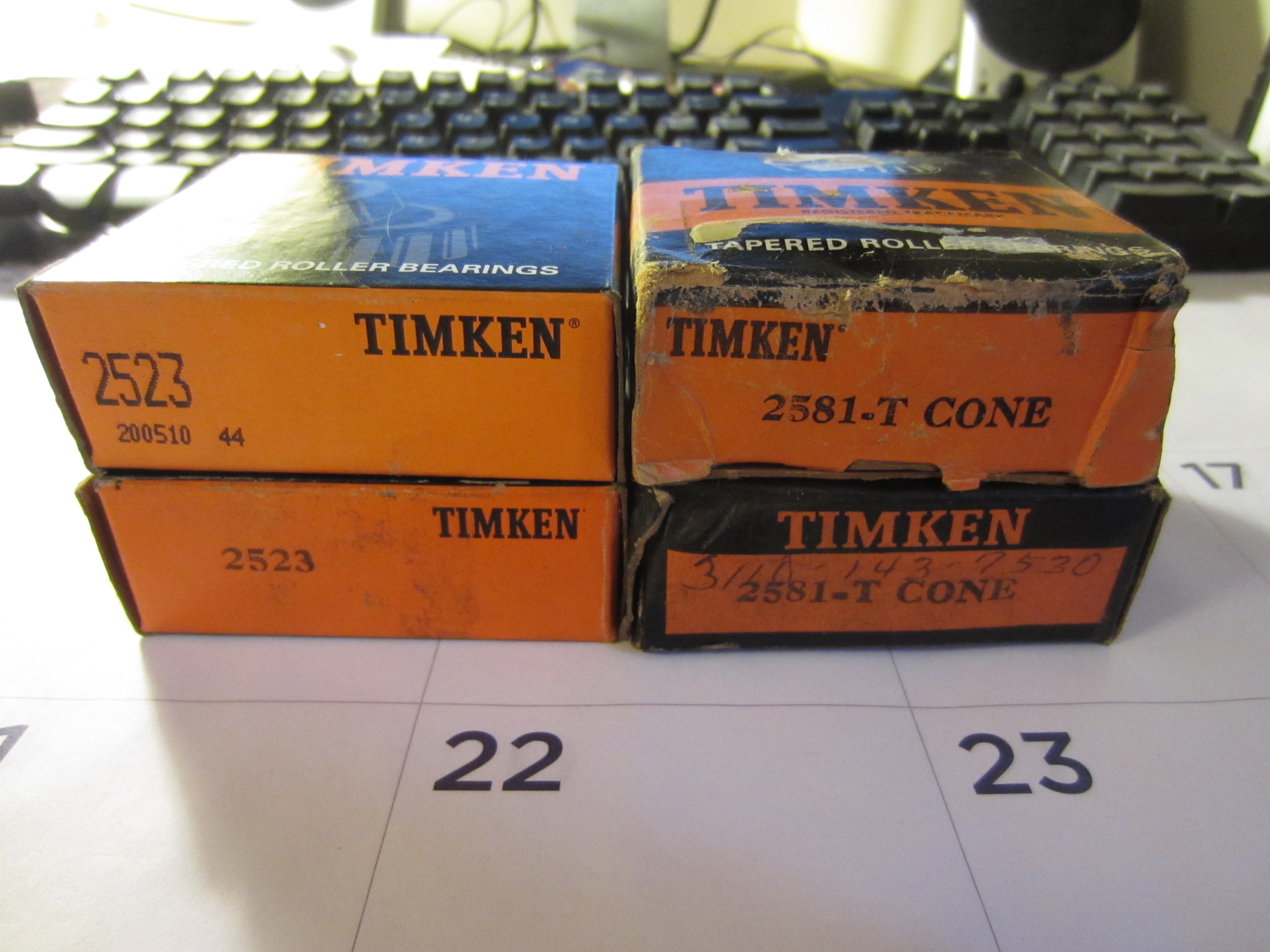

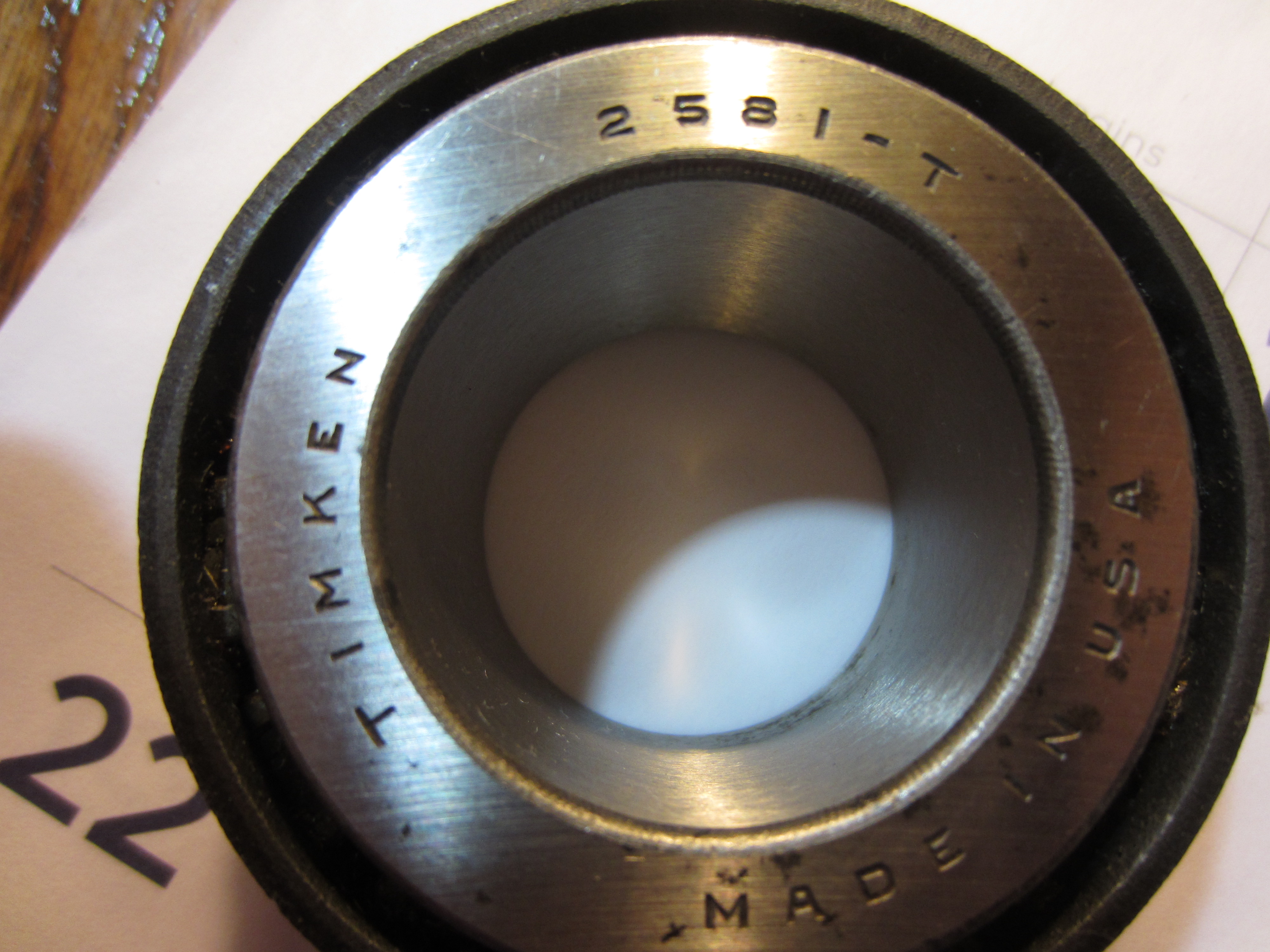

Hello All,
I have an update on the 2581-T cone bearings. I've found another warehouse that says they have several hundred NOS 2581-T Timken's. I purchased two with the matching 2523 cups. I've attached a picture. Apparently the 2523 cups are still in production as they are used in many applications. I measured the Timken and Tyson bearings more closely and they are within a few thou of each other. The outer cage on the Tysons are thinner and don't appear quite as round or nicely formed as the Timken. I attached a picture of them next to each other. Anyway, the warehouse would only sell them through one of their distributors, one of which is a company I already do business with through my work. The price through the local distributor for the Timken are also a little less then the Tyson's.
If anyone is interested in these it's looking like $28.00 each for the Timken 2581-T cones plus the shipping. The cups should be available at NAPA or the like but I didn't verify this. If folks preferred I could get the cone & cup in sets for $38.00 plus shipping. I figured that having to go through a distributor and that I've already got that covered may make this the easiest way to get this done. I'll post this on the club forum as well. As Jon had suggested I could submit an add to the WTN for those who may not be online.
