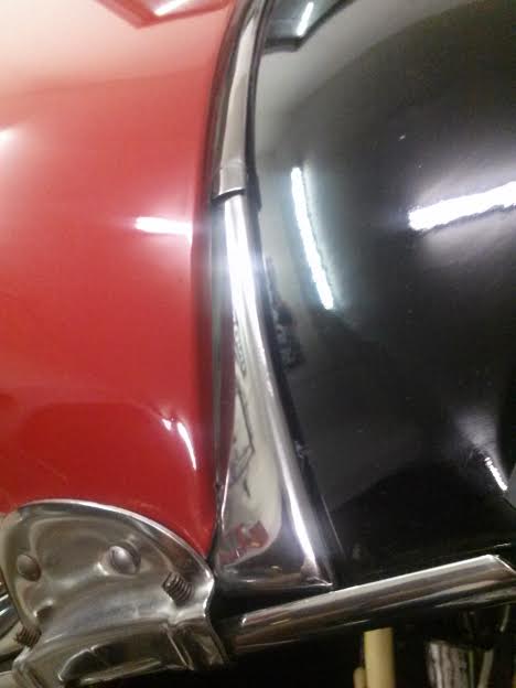

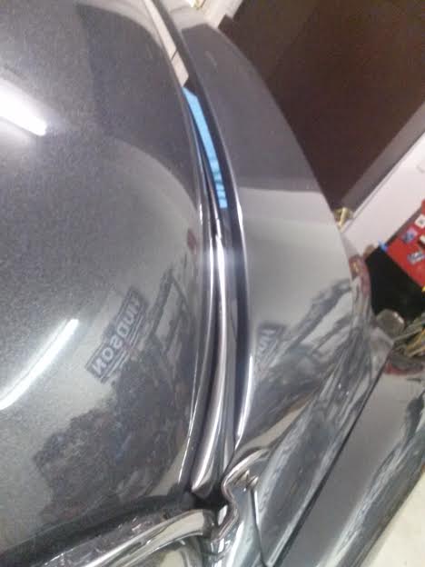

    I'm glad y'all brought up this thread.  I was looking at the visor on the convertible. and it is slammed tight against the trim above the windshield.  On the sedan, there is a gap.  Can you make a set of the larger brackets and do you make them from stainless?  If so, I need a set.
  • bent metalbent metal Posts: 1,602Senior Contributor
    That's because you have the early brackets on there.  '48-9, or so.  I have the longer brackets, in stainless.

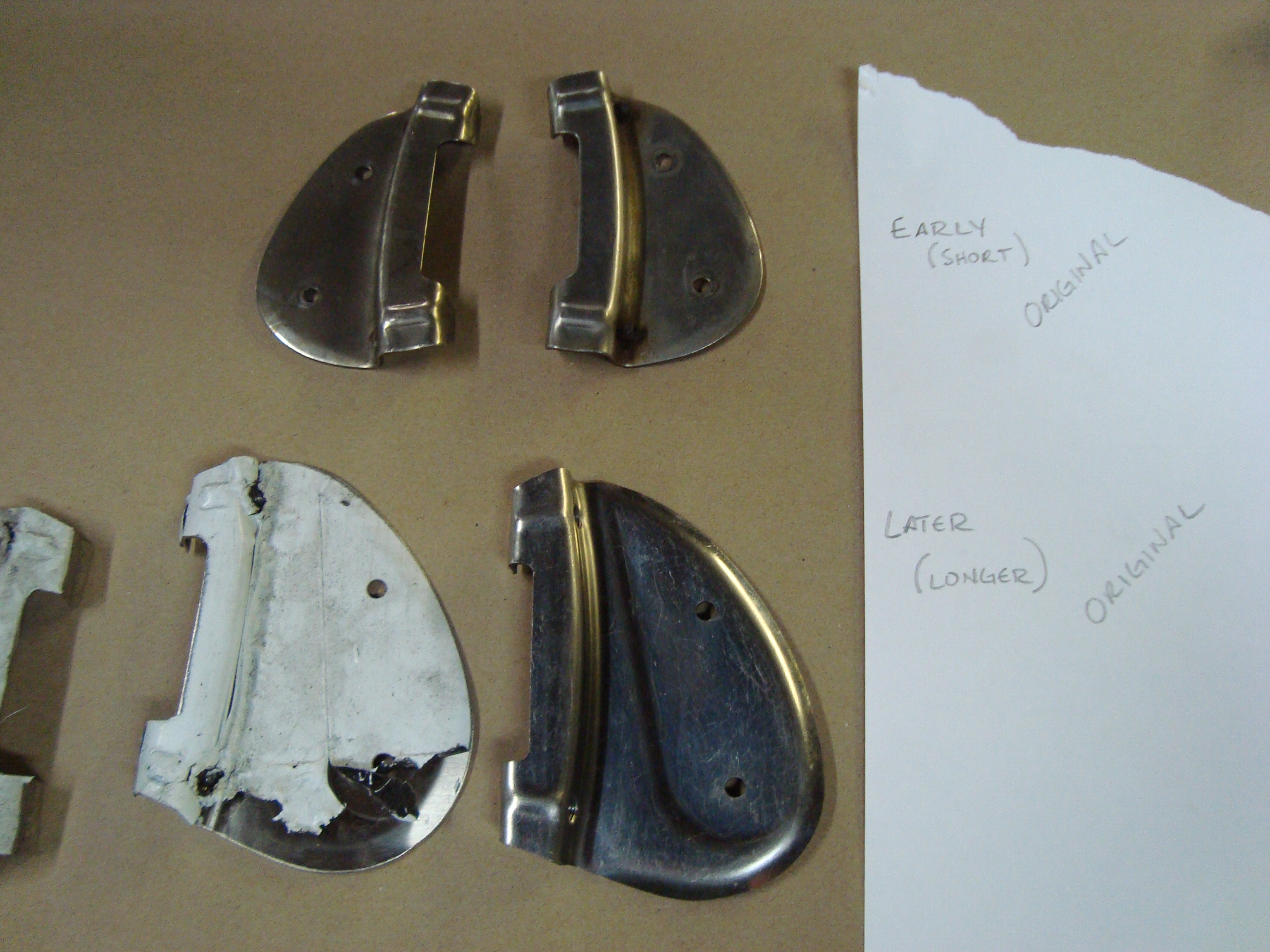

    Wasp and Hornet use the same visor. Bracket may need to be modified per above post
    Don't need to cut up your short brackets.  Buy the longer ones from me.  I have a set ready to ship.
  • GlowplugGlowplug Posts: 2,008Expert Adviser
    compare the brackets... this is one of Guys pictures... His brackets are 1st Class!
