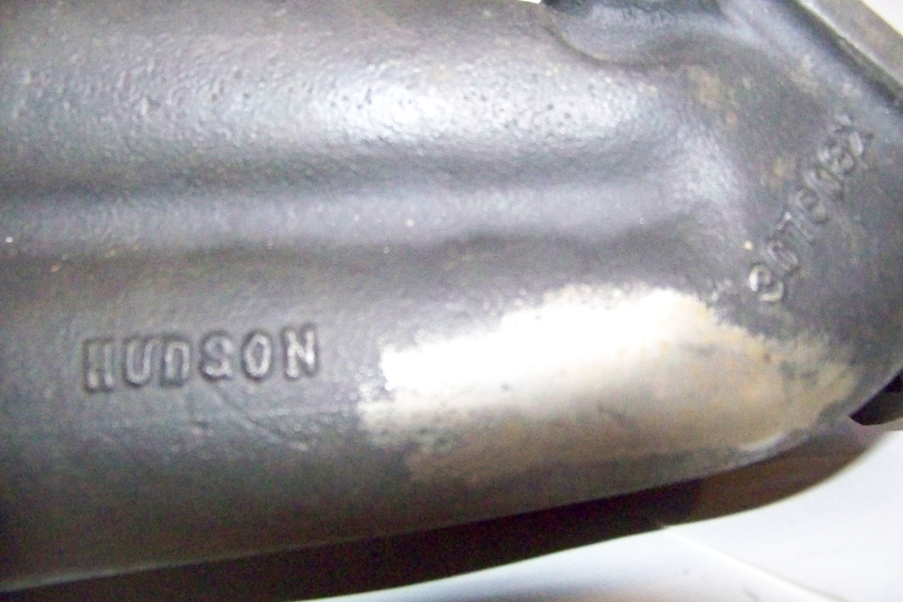

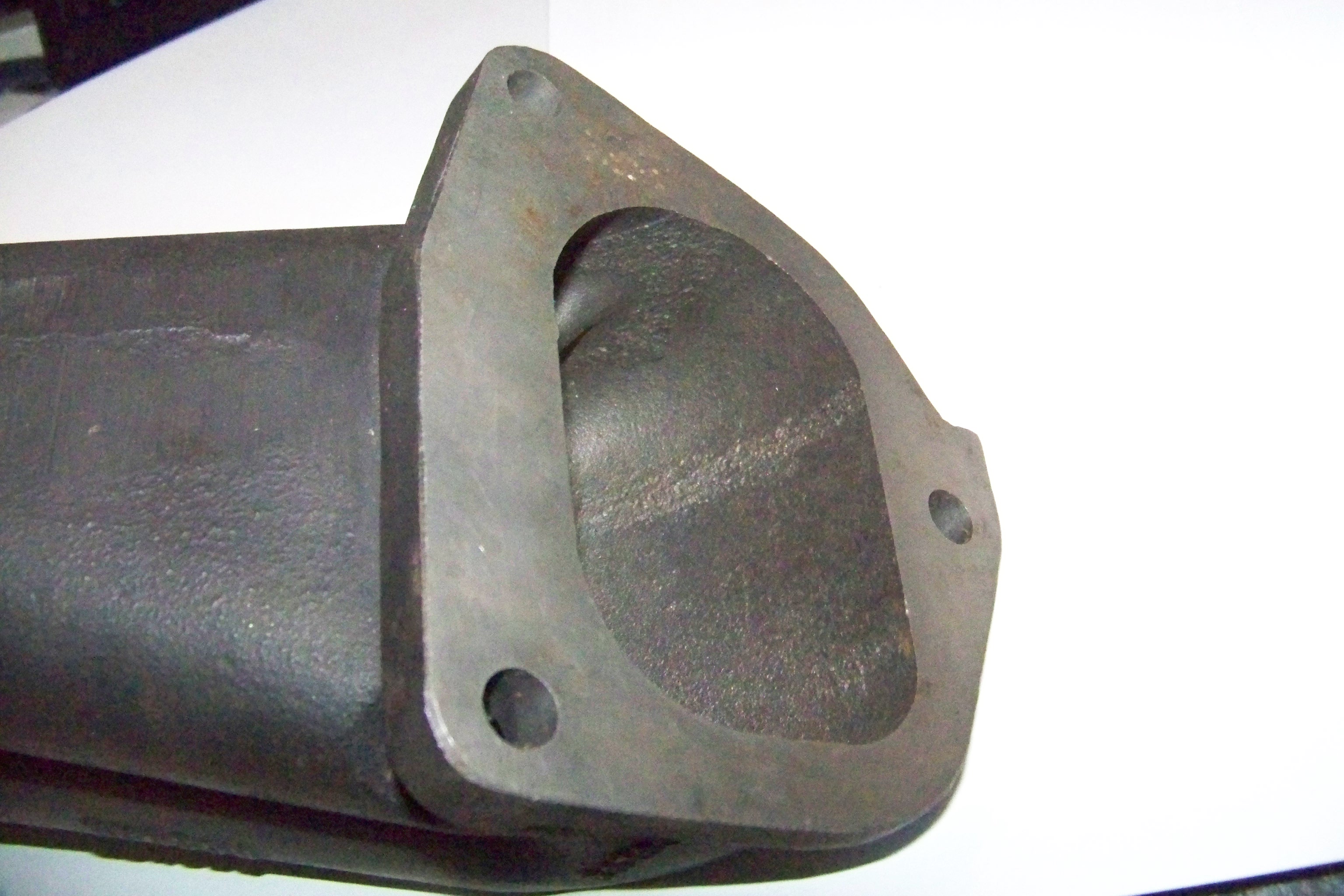

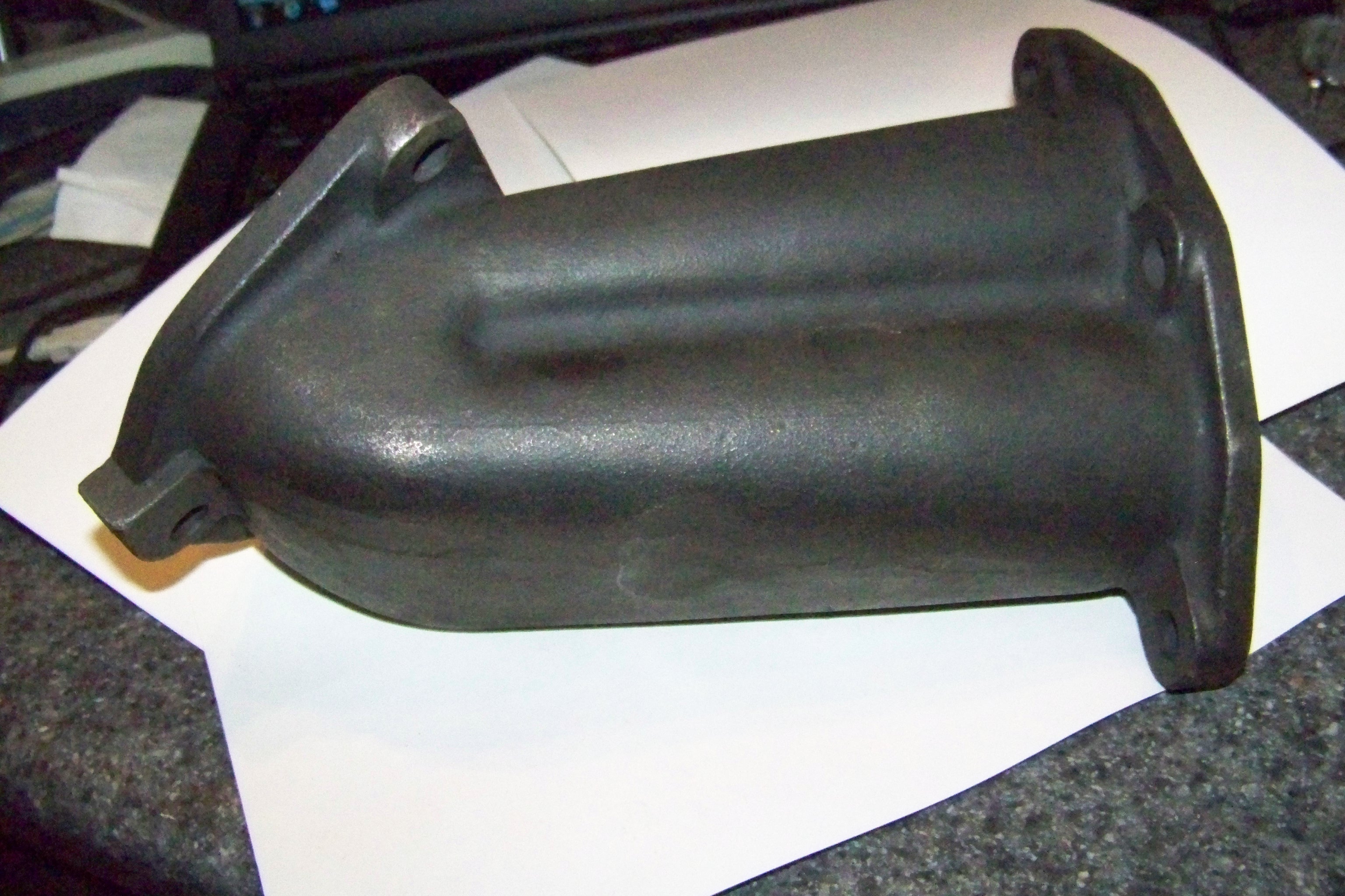

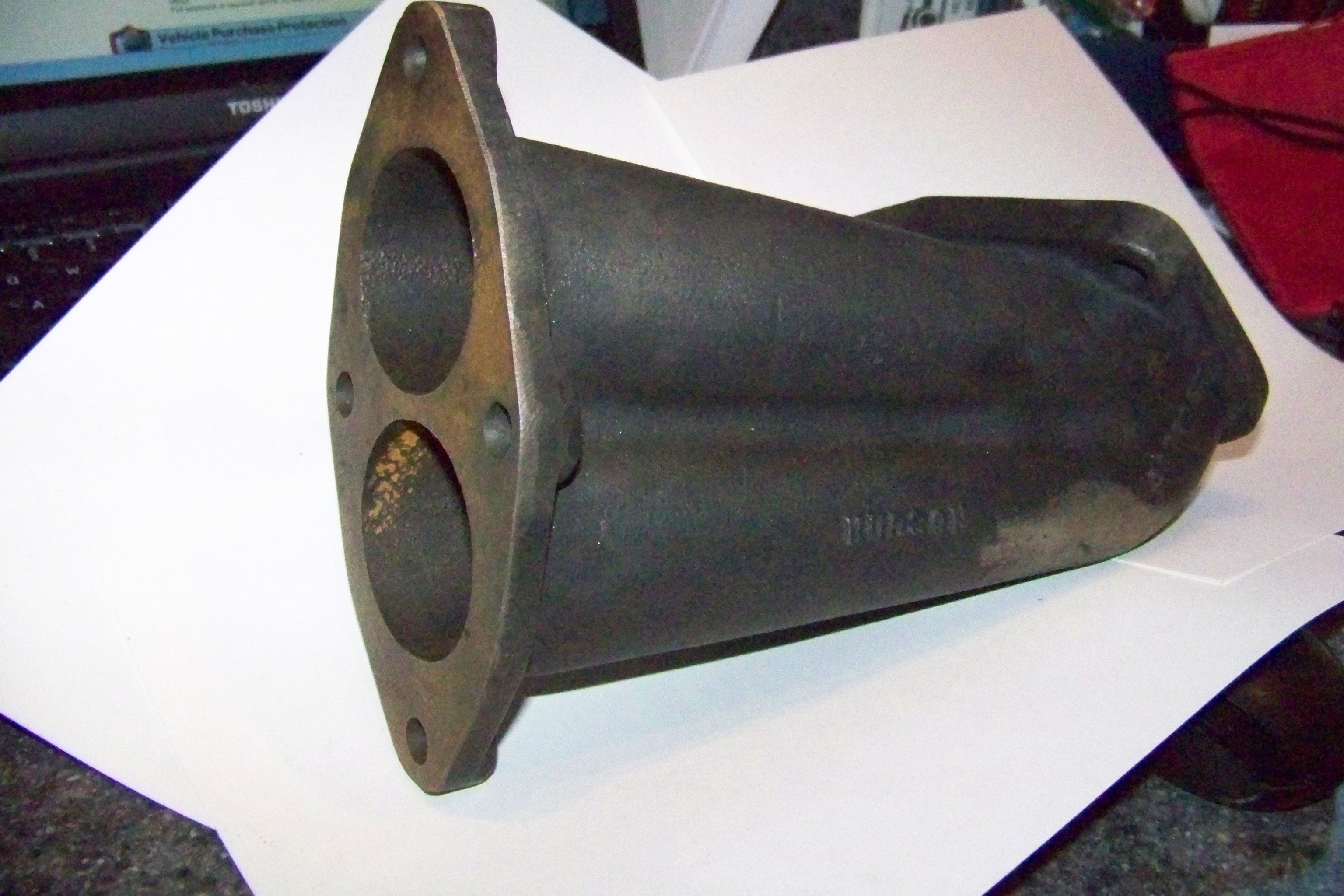

Here are some pics of my split manifold. The gent who sold it to me said IT BOLTS TO THE BASE OF A STANDARD HUDSON (48 TO 54) MANIFOLD and I WILL HAVE TO REMOVE THE HEAT RISER AS IT WILL HIT THE NEW EXTENSION?0

Thanks for the photos.
Take a look at the inside of the flange that bolts to the exhaust manifold. You will see the divider starts about an inch below the flange. This undivided area is there to allow the heat riser butterfly to open. Please post a picture showing the entrance to the split manifold to show what I am trying to explain. That will help clear up concerns.
You can still remove the heat riser if you like. Some just tie the butterfly open. Others remove it completely drill, tap and plug the butterfly shaft holes. I tried hammering in plugs but they eventually blew out with heat expansion and contraction.

You do not have to worry. The divider is below the flange surface. Thanks for sharing the picture. The real 7X has the divider even with the flange surface with a special gasket that not only seals the flange but also seals the divider.
Have fun with it. The repo also is closer to the oil pump than the 7X.
