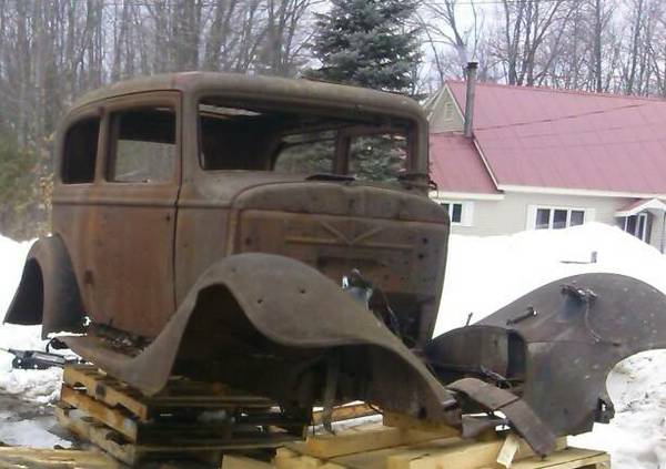

Where to get repair panels for 1933 hudson 2 door sedan?
I don't know of anyone reproducing them (especially for the 1933 Hudson, for which only 20 or so cars remain). You're probably going to have to find a good body man. There is always the chance that someone might have a parts car from which he could cut them. You might leaf through the WTN (assuming you're in the Club) and find some Hudson vendors who sell used parts, then shoot them an e-mail. Be sure to identify precisely which lower panels you're looking for.
And even then, they will most likely have to be reproduced if you want them back to original.0
Do you have any numbers off a firewall plate of found on the frame or axels. My hunch would be you have a '33 Essex-Terraplane and not a '33 Hudson. What is the approximate wheelbase?
Windshield frame available from North Carolina Enterprises. Looks like you need one.
Yes, please check the serial number. It would be good for the fellow who keeps track of the remaining 1933's, to add your car to the list -- even if you plan to street rod it. If it's a "Hudson" and not an "Essex Terraplane", you have a very rare car indeed. Probably no more than 20 are still known to exist. If it's the Terraplane, then there are more of them around....though it's still relatively rare.

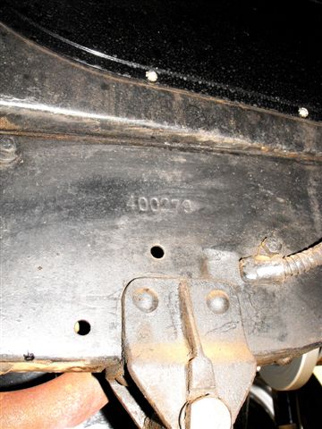

In the 1930's Hudson would stamp the number on the frame, on the passenger side of the car, up near where the front axle passes beneath. Not sure whether it was on top or outside of the frame. In the late 20's they'd stamp it on the rear spring mount, passenger side I think, which was usually visible from behind the car, in the area behind the rear fender.
Ed Souers would know for sure.

My '34 Terra frame number (which is same as car serial number) is at the rear attachment of the right front spring. I think '33 is same.
I note that the panel in front of the door has no hole for the sidelight mounting. So that is an indication this body may be an Essex Terraplane.
A 1933 Hudson
A 1933 Terraplane
