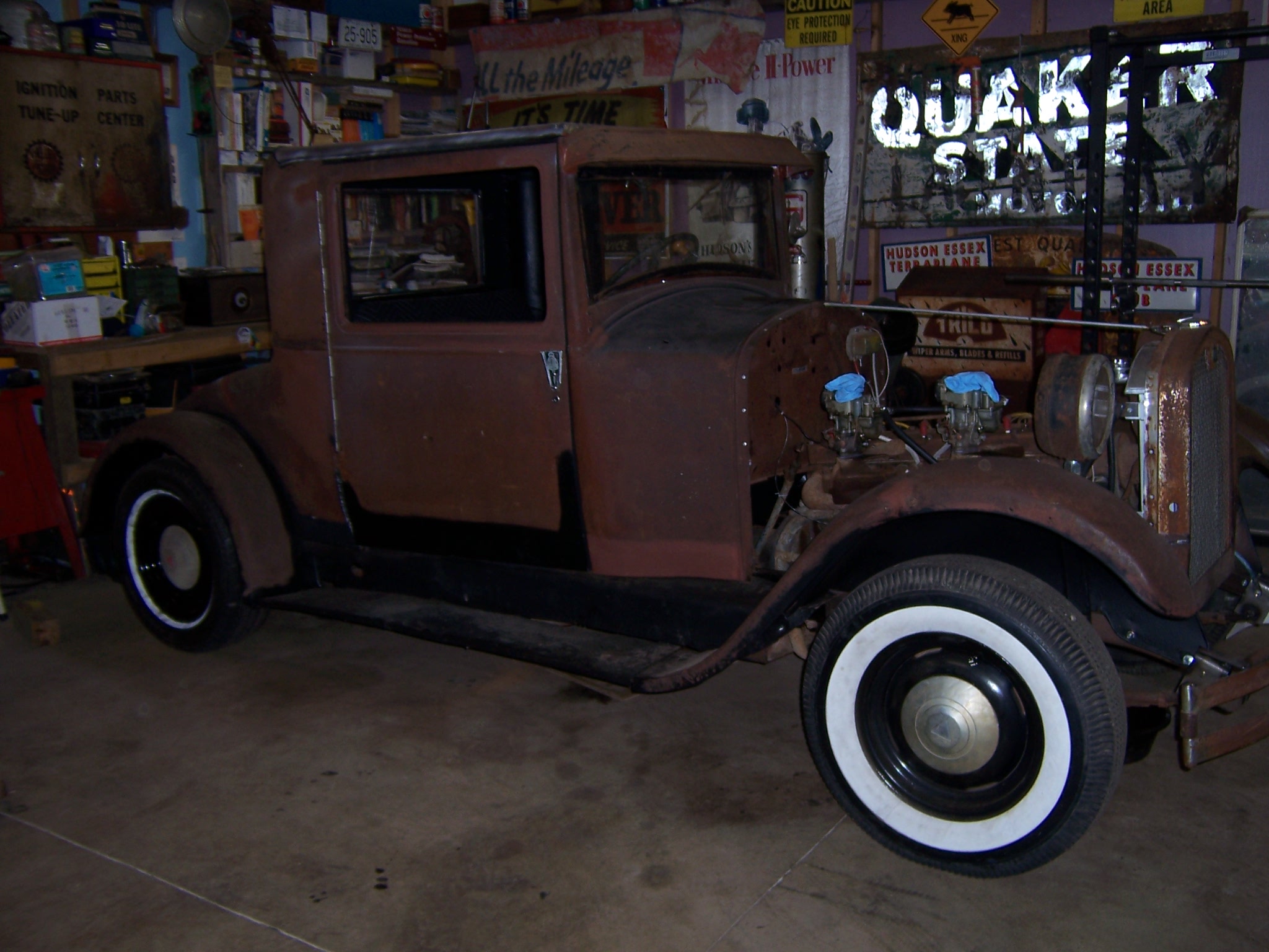

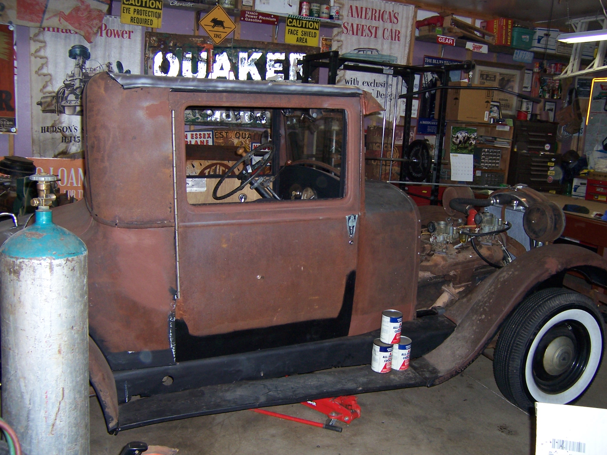

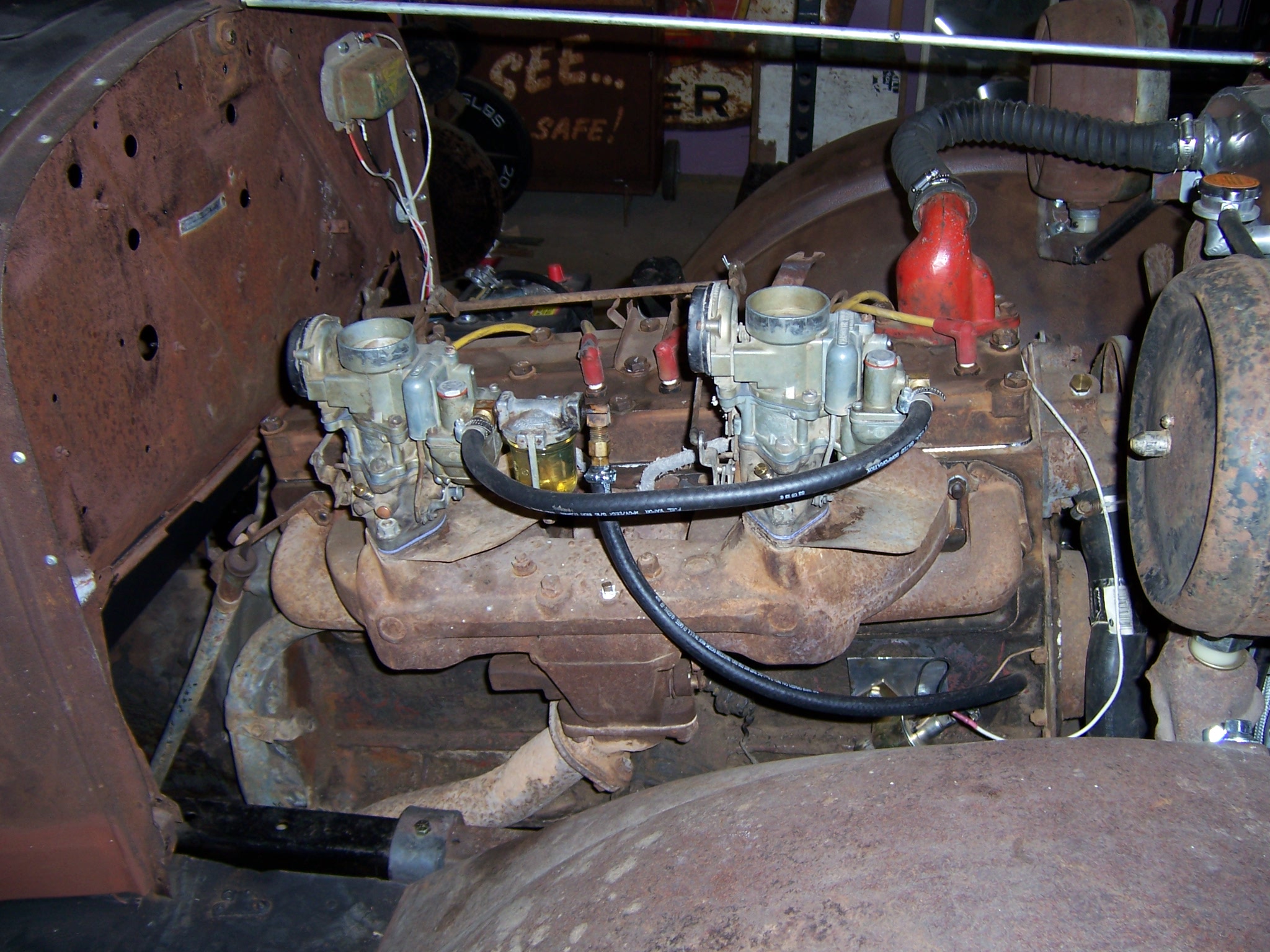

I have been on vacation the last 4 days and been working a lot on the Essex. I moved it around and got a picture of it with front end finished an rear end installed. the cowl is sitting on before I got the engine sitting on it. also here is a picture my buddy took of me ridding the twin h like slim pickens.0

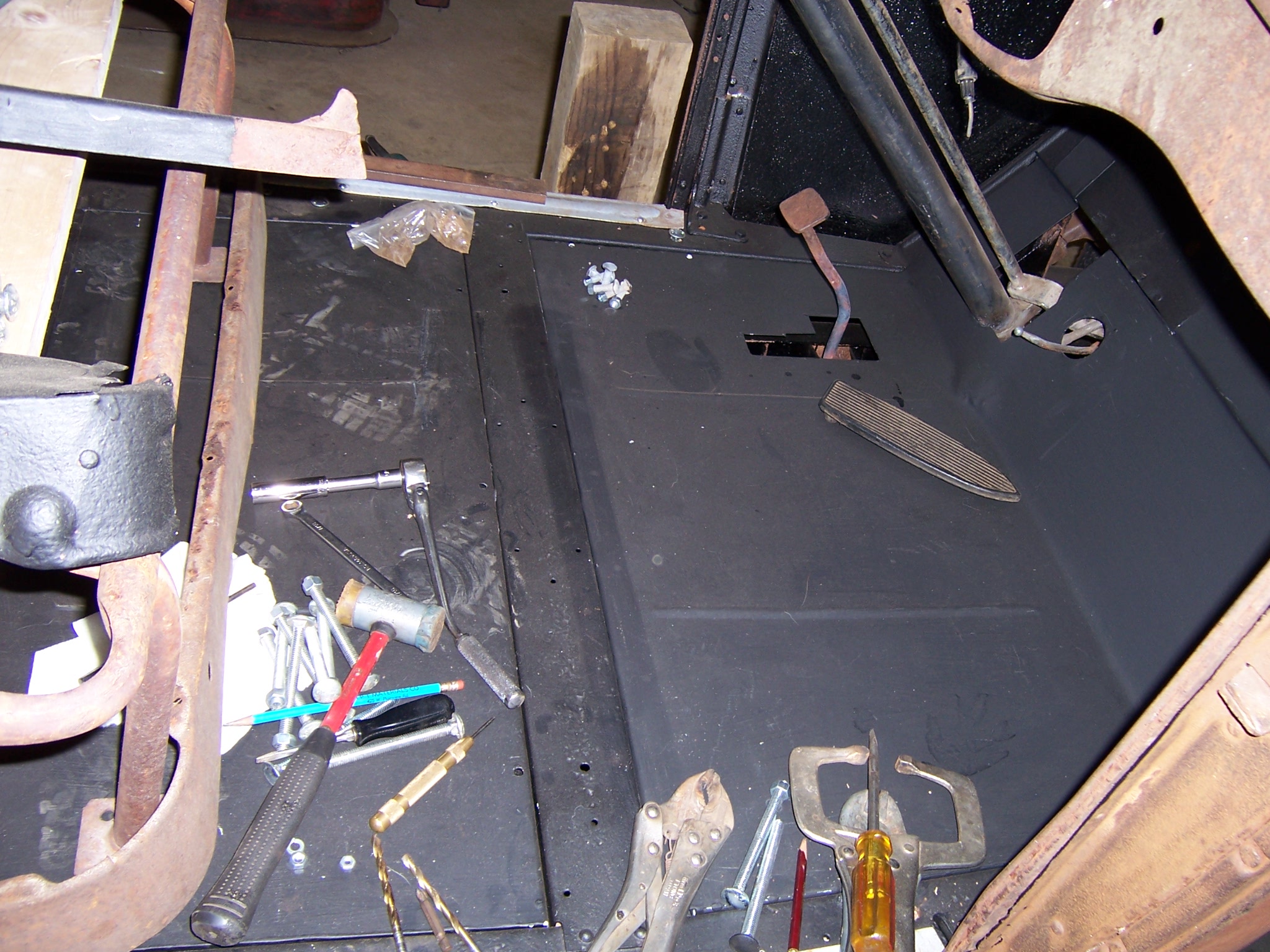

Mr Burr, thank you for the advice, and thank both of you for the stories. I sure may end up going to disc brakes sometime. since I have a lot of time in the hornet hyd brake conversion I would like to see how it does. honestly I never plan on driving this car fast. it is funny the engine/tranny combo looks to weigh more than the car! )0

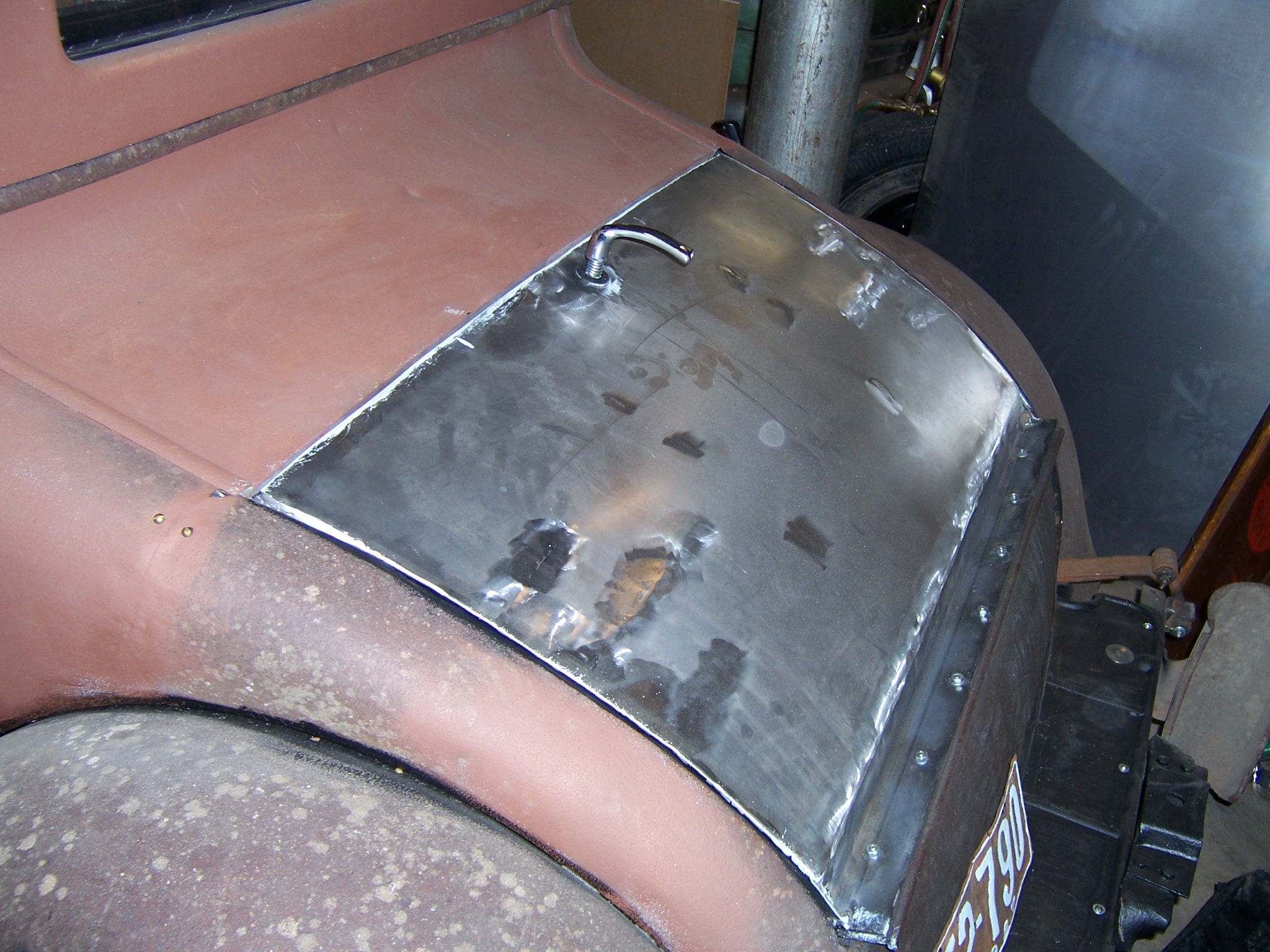

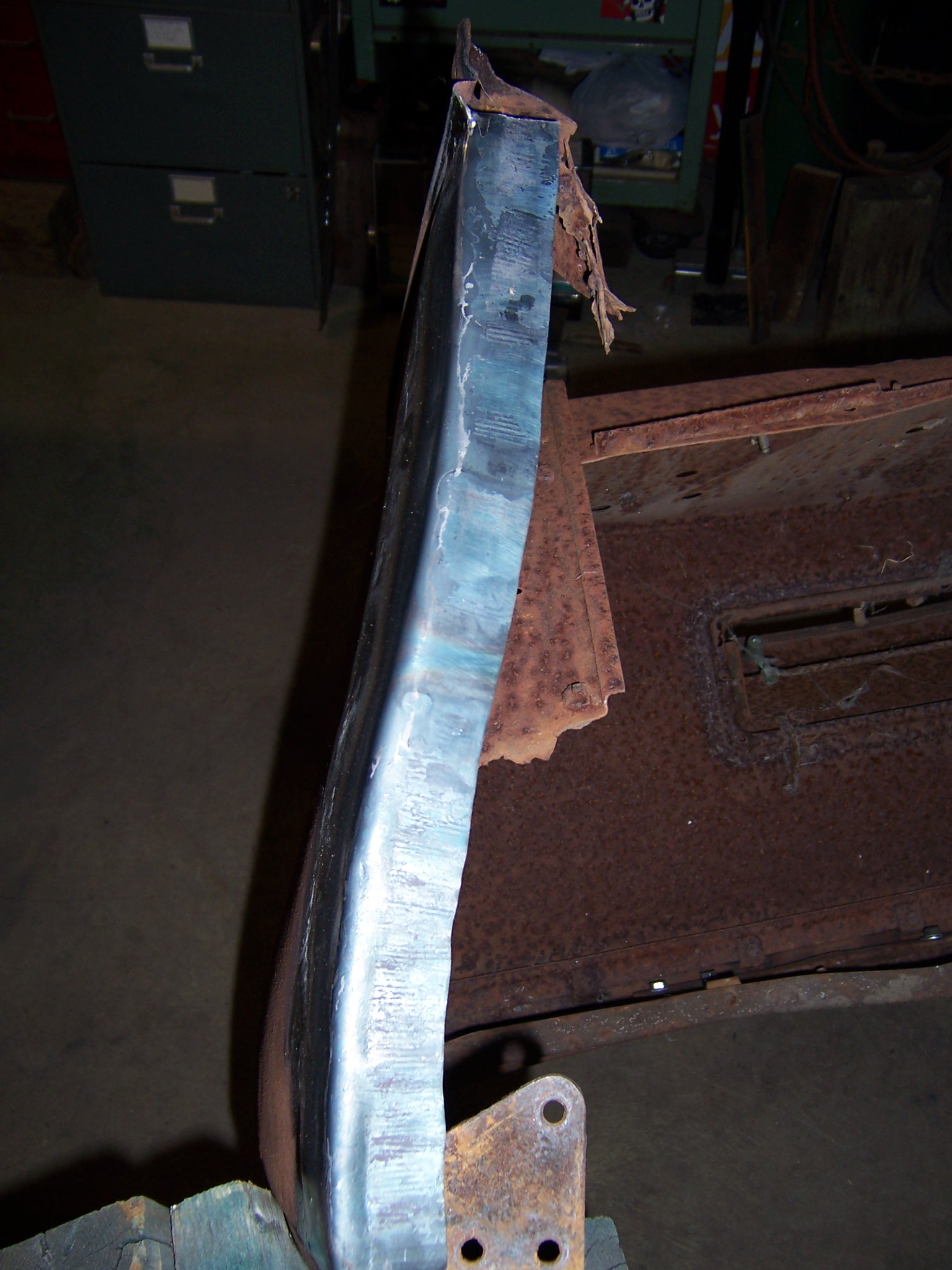

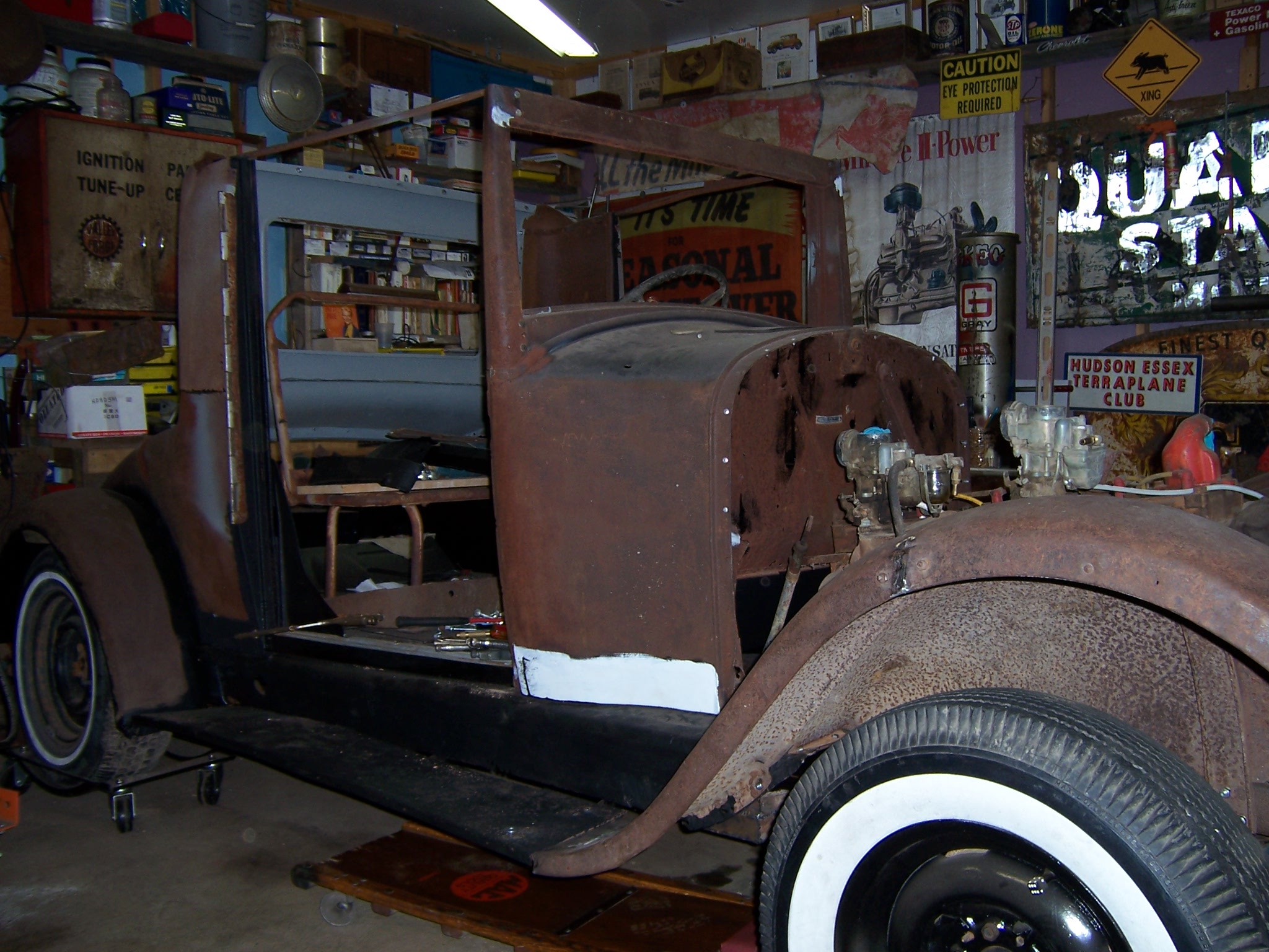

I have most of the sheet metal repair done. I still need to replace the metal on the bottom of both doors and one of the front fenders. I have not been able to post on here for a while after the forum switch over. here is a picture on the bottom of the cowl I made with the shrinker stretcher.0
Looks good. Been wonderin' how your project was progressing. Post some more pics when you get a chance.0

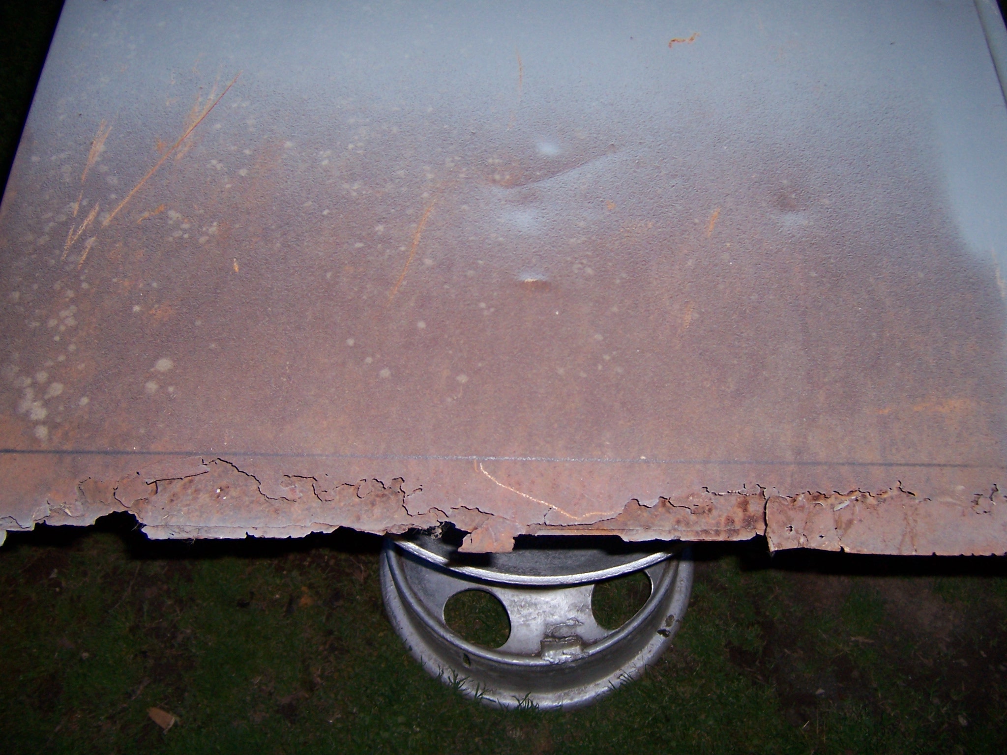

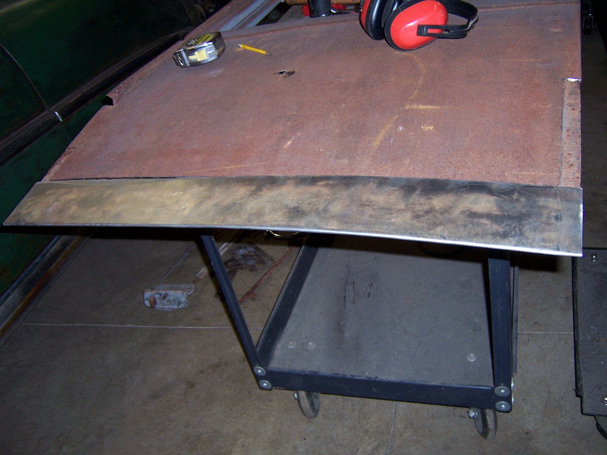

I jut finished making the the lower door piece this afternoon. I had to hand roll the lip on the bottom, it was too short for my brake to start. it was pretty rotted out to start with.0

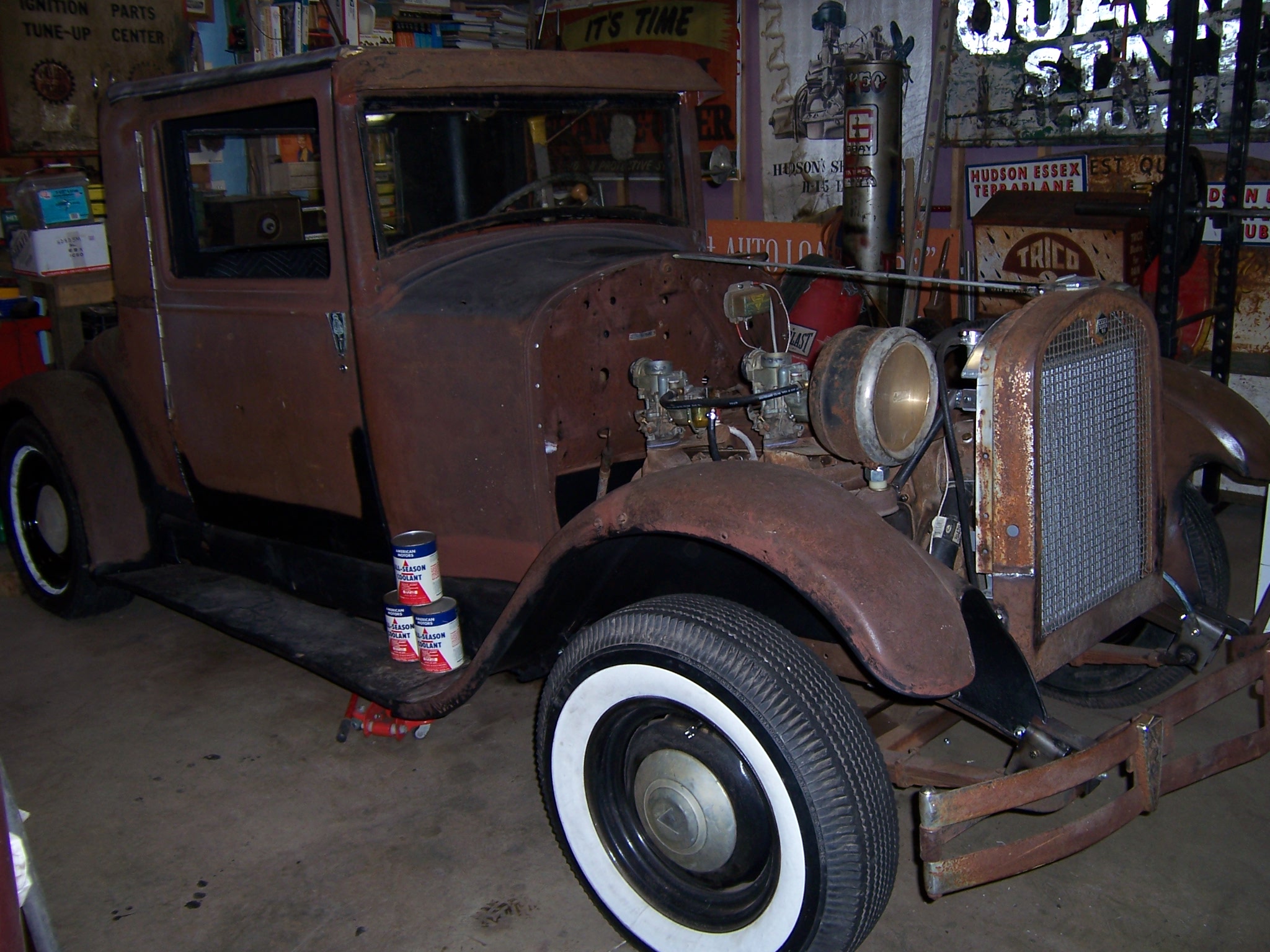

and one of the car with most of the panels put on! at this rate maybe only a couple of years left. ha ha!0
It's looking good. One panel at a time, and eventually you'll run out of panels.0

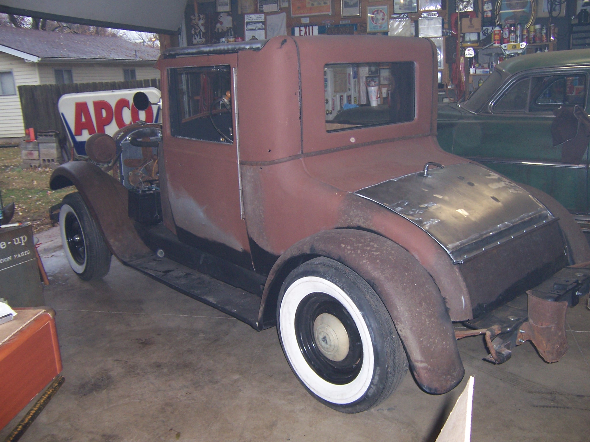

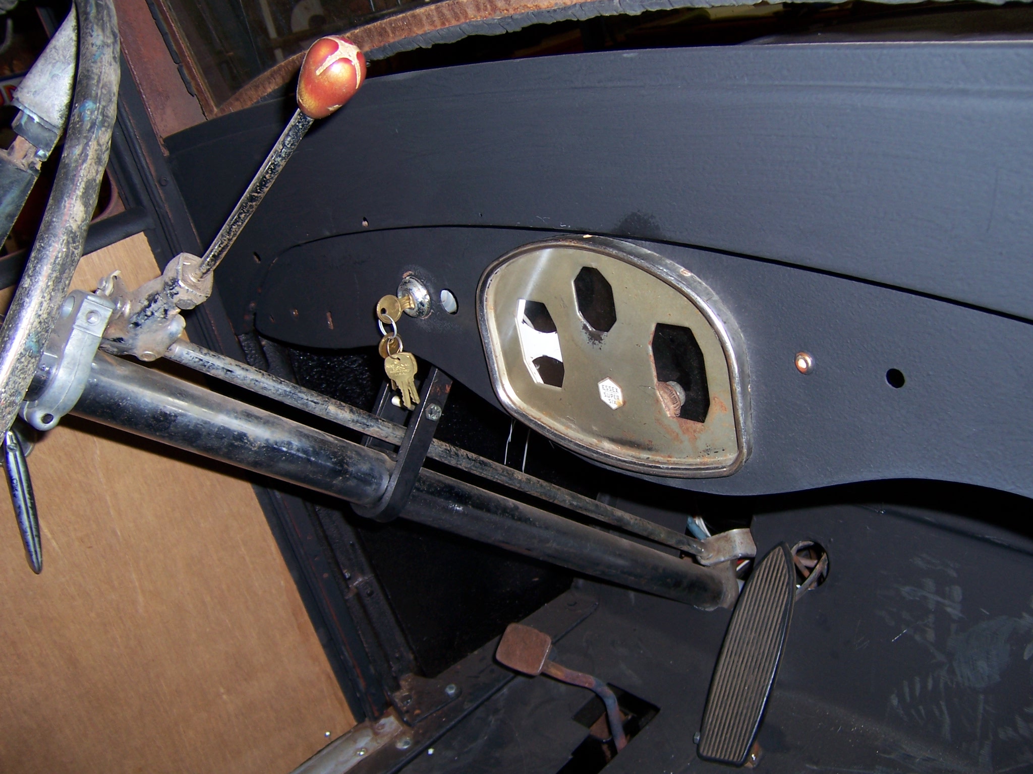

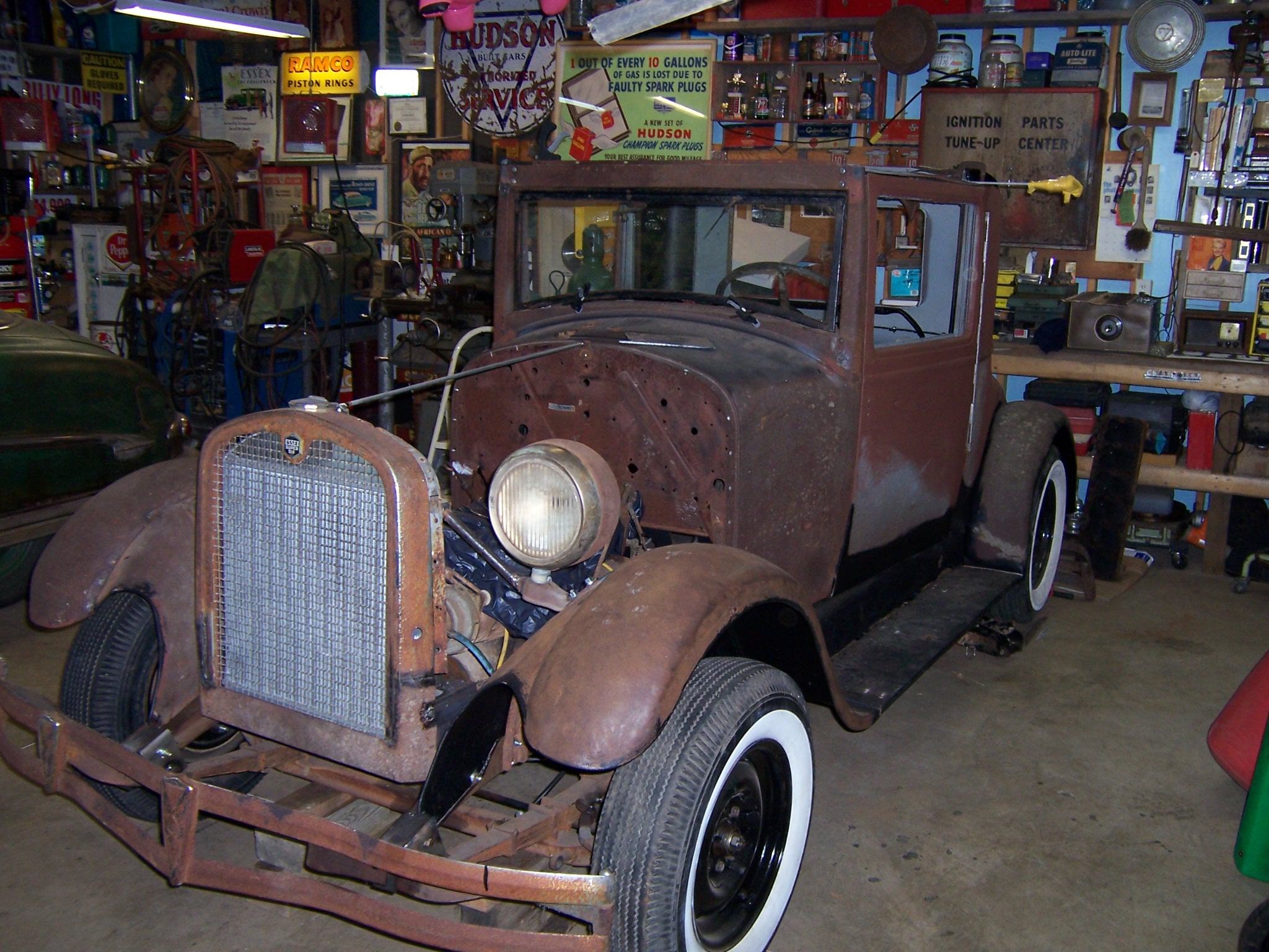

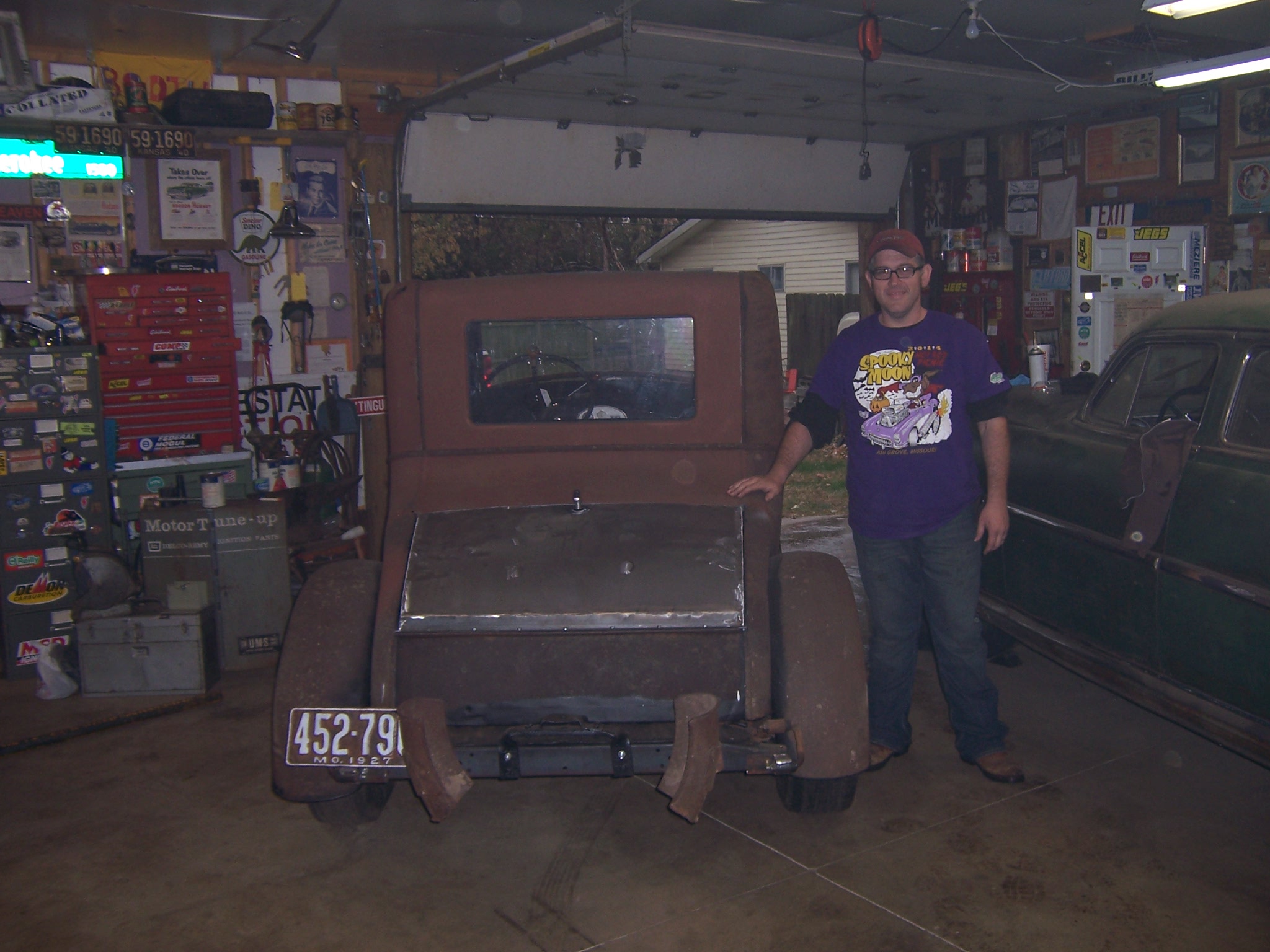

her is a updated picture of the coupe. I have most of the sheet metal done. still waiting on the exhaust valves to get the head back on. need to do the back glass, make the rumble seat lid, wiring, finish the front seat, I got a 27 Essex dash cluster on ebay and install that, door handles and latches, battery box, and about a million other small things.
I am really keeping my fingers crossed and hope the hydromatic works!!!!!0 -
looks like you have the top 1/2 of a 31 grill and mesh in her
cool looking
