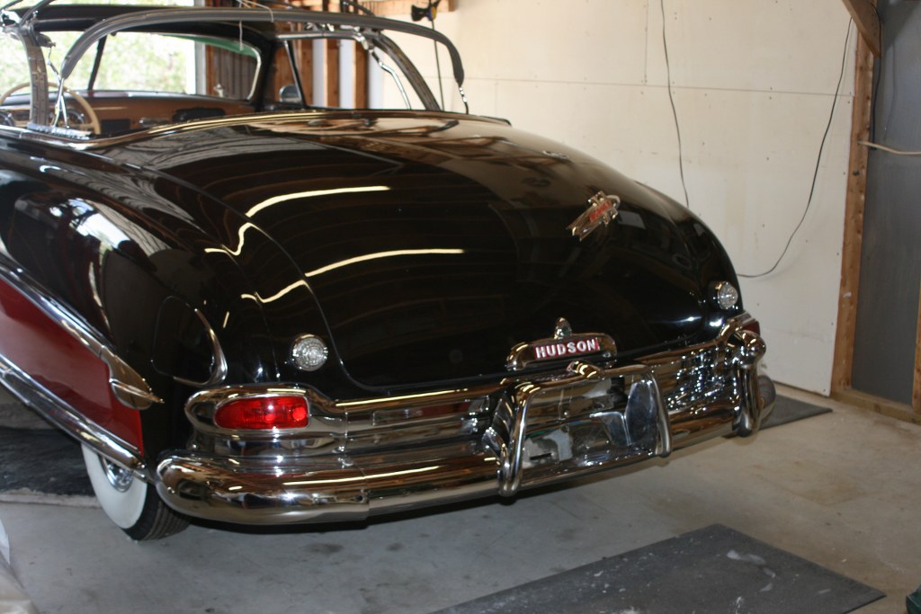

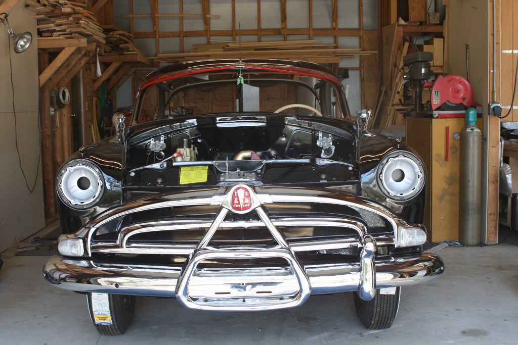

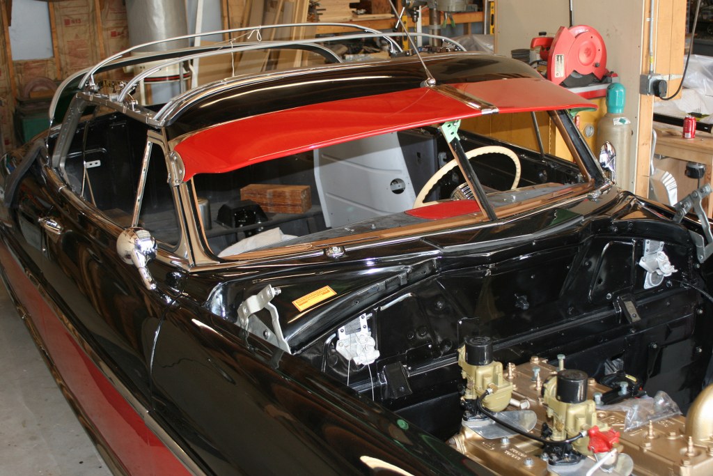

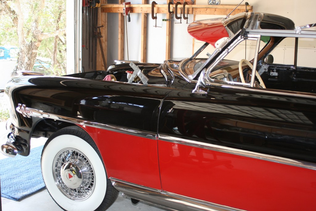

Well, it is a very momentous day! Today represents the end of searching for parts for the convertible. 6 years of searching, scouring, contacting, pleading, are coming to a close.
At the National this year, a lady informed Dave Sollon that her late husband had a set of rear seat ash trays for a convertible. These pieces are convertible-models only, and used from '48-'54. One would think that these would be somewhat plentiful, but one would be wrong!
Luckily for me, Dave instantly thought of me and my near-never-ending search for the last of the hard parts for my car. How great is that, a rag-top man helping another rag-top man with a hard to find, much sought after pair of parts. Love this club and the folks in it.! Thanks again, Dave! You can bet this wouldn't have happened in the Packard club.
I haven't been good at posting pics, but here are a few recent ones:
I've spent some time trying to get ready for the upholsterer, making door panels. Still have to make kick panels and the area under the door.
Also, I've completed the leather-grained parts and pieces:

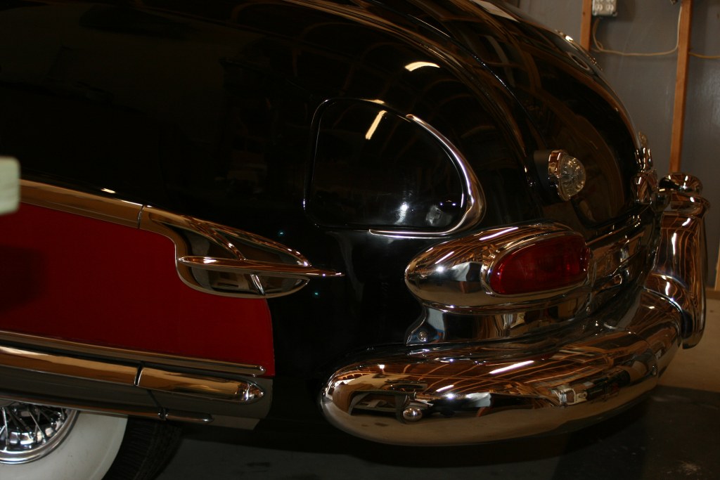

I think I need some better taillights, though:
As usual, constructive criticism is always appreciated!0
